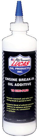

Modern SM grade oil (the newest standard) has about half the recommended ZDDP level for older flat tappet engines like the 2.8L V6. The fix is to add a ZDDP supplement. There are several for sale at the auto parts store. ZDDPlus or Lucas Break-In Additive, all work. You are looking to raise ZDDP levels above 1200ppm. Higher will not hurt. The ZDDP is used up during the life of the oil.
My favorite brand of oil is whichever one has the lowest cost and is full synthetic. Add ZDDP and go.
