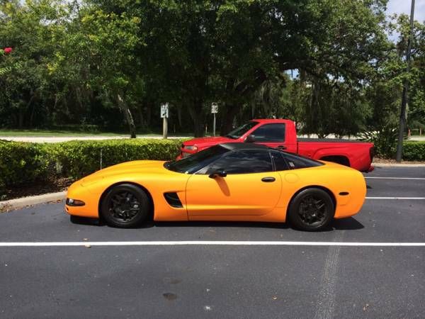

Duplicolor has a burnt orange color I was considering using. So Roger you don't think my Harbor Freight hvlp sprayer with the compressor that looks kinda like a vacuum cleaner will work okay with the duplicolor? I don't have a place to put a large compressor plus they are fairly pricey. Have you ever seen a plasti dip job close up that looked okay? t

The orange looks great.
