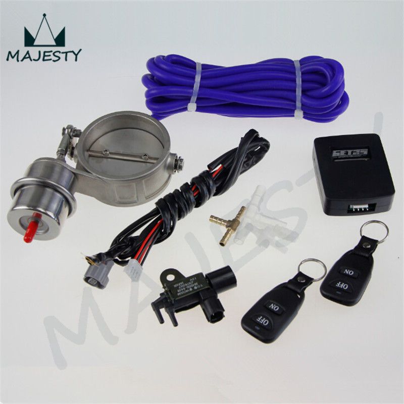

fieroaddicted
662 posts
Member since Dec 2012
this is a vacuum valve that i found on ebay. This particular one is 3", but i seen them in 2.5" as well. I am thinking something like this might do the trick for me?
