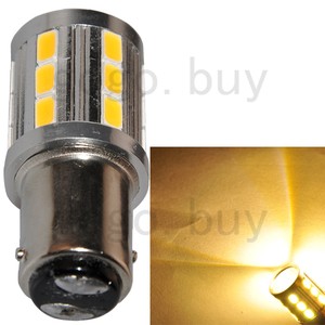

Report this Post04-24-2014 09:37 AM Click Here to See the Profile for 2.5Send a Private Message to 2.5Edit/Delete MessageReply w/QuoteDirect Link to This Post
Originally posted by Csjag:
Do you know if those are dot approved?
I would just get a color that looks the same red as stock thru the lens. Put the new bulb on one side, old on the other and see how it looks.
You can get 3000k LEDs (warm white)
http://www.ebay.com/itm/115...xp=mtr#ht_1556wt_899
