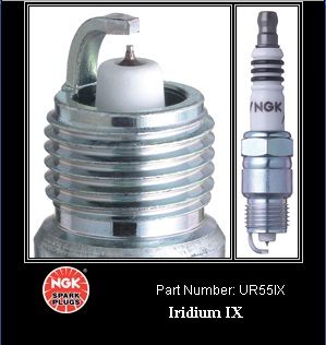

For plugs, I went with Ngk as I've had good results with them.
The box said they where pre-gaped, but the site said .060 and they where all 4 spot on.
I pulled them today just to have a look and they still look like new even after 4 months.

I always go dealer specific. I had a 5.0 mustang with ac del co plugs and ran fine but sounded wierd... talked with a few gear heads and swapped out for motorcraft and it ran soooo quite and got good power. I dunno y but same plug base and gap, but it was like the signal was different or something. Just my experience.... thought id share after I saw the ngk. N I know thats usually for nissan or hondas.. but id try ac del co since they are gm brand. Plus 4plugs is like 20 $ or less

I agree with Zeak, the heat range on the NGK's could be a little off

DIS engine doesn't like even hates:
many "improved" plugs
Missing/bad EGR valve
Dying MAT and/or MAP
Dying spark plugs
See my Cave, DIS Ignition and 87-88 DIS Duke ECM

Try stock plugs to see if that helps.
