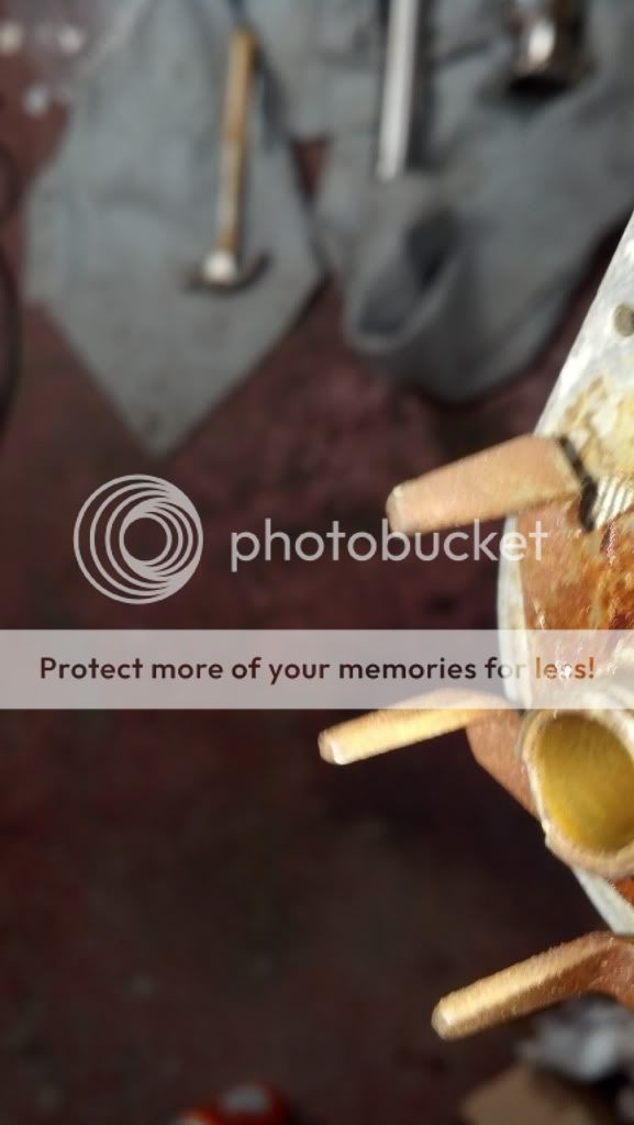

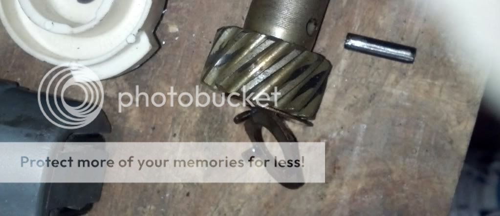

Started cleaning up stuff today and started with the distributor the interior coil was so bad I am suprized the motor runs. I have one so I changed it but the rod when pulled thru the housing did not want to come out, quite a bit of rust. Looks to me like oil is pump thru to lube the shaft. This washer/ looking mechanism fell out before I notice it's position. I done think it critical as in any position the locking will work. Doesn't look like much oil can get around it and up the shaft.
The fins on the distributor for lack of knowing what to call them do what? When they all rusty like these are will cleaning them help or increasing the gap to the rotor that turns inside them create more problems?

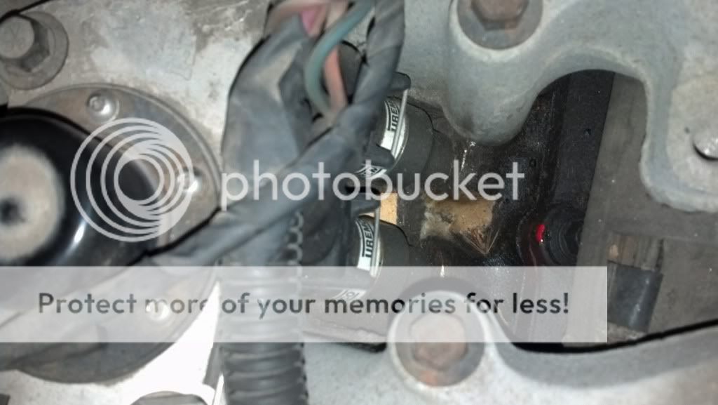

How do the clips come off the injectors?

Well there are 6 fins for a v-6 they trip the magnet interface to make the spark at the coil. Rust is not a barrier, just an indicator that moisture is present. You must remove fuel rail. The injectors have a small metal locking piece (retainer) that must be turned to unlock from grove in fuel rail. Then they are pulled out with resistance since an O-Ring provides a seal.

Thanks for the info. What do you mean by turned? Maybe after I get the fuel rail out it will be easier to see. All this to change valve cover gaskets. Makes the Pacifica I rebuilt look like childs play and that wasn't an easy job.

If you want to put the washers back just as they were, the flat washer goes against the bottom of the gear. Now, look at the washer with the 3 tangs. You'll notice 2 are closer together. Look up inside the distributor gear and on the side of the ribs, you an see where they made contact. Put them together so that the tangs match the rub marks on the inside of the gear. When I reassemble my distributors, I rub the shaft with a good coating of disk brake slider grease. Syl-Glyde or SilGlide. Don't remember how it's spelled, but either way it's pronounced the same. PB Blaster will break the oil varnish for dis-assembly.
The rust inside the distributor isn't caused just by moisture. The major factor is the corrosive ozone that's created by the spark between the rotor button tip and the contacts on the distributor cap. Any time an electric arc passes through air, it creates ozone.

Sorry reread your post, I was referring to the wiring harness clip to injector.

Yes I got it out. The is still a bit of a drag of the rod thru the shaft so I probably need to keep it soaking so I can clean the race way better. Probably need a coarse brush to run thru it after it soaks. Any help on the clips for the connector on the injectors. I figure they are harder to come by so I I am a little lyre of pulling and prying. After 28 years of running I am afraid of brittle wires anyway. I really have a great car as far as rust goes, this thing looks spotless.
