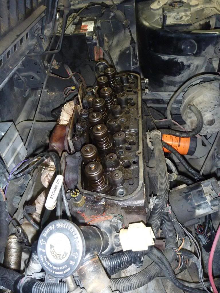

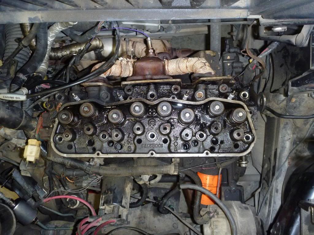

I'm doing a partial overhaul on my duke and am having a hell of a time pulling the head. Both manifolds are off, so is everything else that looks like it could possibly hold the head on. I can get the head to wiggle a bit about its long axis, so I think it has broken free from the gasket and its not jamming on the locating pins. It seems to rotate about the center (looking down the length of the head) and doesn't have as much movement on the alternator end. It seems like something on that end of the motor should be removed before I pull it but I can't find any other parts holding it on. I have even tried lifting it off with an engine hoist. The only other issue is the center head bolt next to the exhaust snapped off before turning out, but this should only act as a stud or extra locator pin and not a fastener. Any ideas would be GREATLY appreciated! [img]http://i1247.photobucket.com/albums/gg621/smmilke/P1030527_zps386d5ef b.jpg[/img]

First guess looking at the pictures - in your first picture I see the metal bracket/loop that is used to hoist the engine. It looks to extend down below the head mating surface. is there one or more bolts securing that to the block that need to come out?

I've had this same issue--the broken head bolt is your problem. It is jammed with either rust or exhaust residue, depending on exactly which bolt broke. You might try using PB Blaster or some other penetrating oil in the hole where the broken bolt is located. That, and LOTS of patient wiggling and pulling to break the head free and it will pull off. In my case the engine was out of the car and I had enough room to spin the head around the broken bolt to help break it loose........

I agree with Rod. Soak that bolt in PB Blaster or Kroil for a few days, then try again. Also, if you hit the end of the broken bolt with a punch and a hammer, while keeping upward tension on the head, it should help to work that bolt out.
