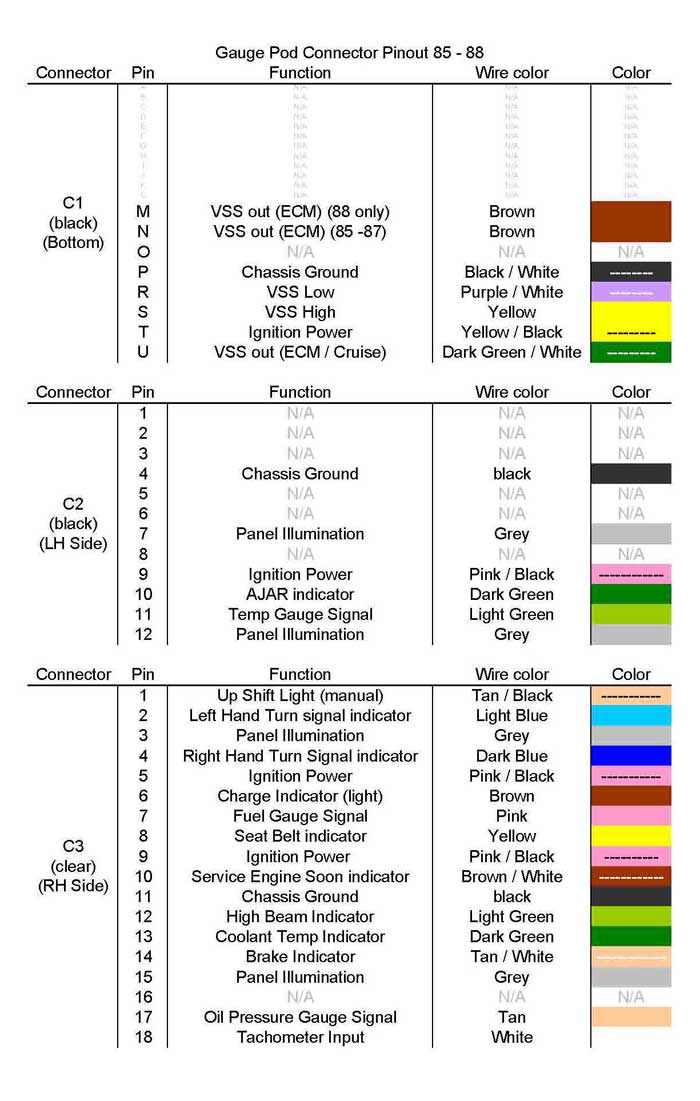

Does anyone have the pin configuation for the volt and oil pod trying to hook up aftermarket gauges and would like to use existing wire to hook up sending units and gauges. 86 se 2.8 Could Also use the pin location for the temp sender

From the 86 Factory Service Manual, Download at Fieronews.net

For this to work your aftermarket gauges would have to match the factory ones. That isn’t usually the case but it’s worth looking into.

Non-pod dash wiring

going to use new sending units just want to use the factory wire so i dont have to run new wires
