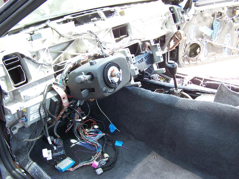

I thought I had some pics of the shifter? Looks I blasted thru that project with out the camera. I will try to get some pics of it soon.
Let me first say that the dash now sits in the exact location that the stock Fiero shifter used to be. So I modified the shifter to be as low as possible by cutting off the the entire mount under the shifter mechanism. I also removed the tack welded shifter mount from the center tunnel. I reformed the shifter in such a way that allowed me to mount it 3-4 inches further back with out getting taller. If you look in the center tunnel where the shifter is located you will notice that it is mounted in the deepest recess in the tunnel. The further rearward you relocate it the higher it will have to be mounted. I had to move the shifter back so I could use the full range of motion. The stock Shifter would hit the HVAC controls in the "N" position. So I not only changed the shifter base plate and made a new mount but I also had to add extra range of motion for the 4 speed auto tranny.
One other mod that I did was to make sure that the Front mounted LS4 still had a proper shift range after mounting in the rear of the Fiero. If I just used a Fiero cable on the Fiero shifter on the LS4, the P R N 4 3 2 1 would all be reversed to 1 2 3 4 N R P. I remedied this by using the stock LS4 shift cable (because it is very long) and moved its mounting location to the front of the shifter. The stock Fiero shifter cable is mounted on the rear of the shifter. I cut the stock cable mount off and welded it to the front of the shifter. I then ran the LS4 shifter cable thru the side of the center tunnel and under the driver seat and carpet to a thru plug on the firewall that is next to the seat belt mechanism. I had to cut off the "ball" that the cable snaps onto and re-weld it about .5" higher to retain the stock LS4 shifter geometry and shifter lockouts and detents. So as you pull the shifter back tell it stops on each detent (tooth) it coincides with the tranny shifter detents.
I also had to incorporate the lockout solenoid on the shifter for the ignition key. I mounted that to the right side of the shifter. This lockout unlocks when the brake is pushed so it will not slip into gear with out you foot on the brake and it also will not send a signal the another lockout in the steering column to remove the key unless it is in "P". Bottom line here is that if my shifter does not work properly, I wont even be able to start the car or take the key out. I hope it always works
The shifter shaft is about 4" shorter than stock and has a nob from an 89 Corvette. This was the smallest shifter nob I could find. I had to make a custom adaptor sleeve to mount the top two inches of the Corvette shifter shaft to the Fiero shifter shaft. Then I made a custom rod for the button on top of the nob.
So I don't have a shifter cable running down the center tunnel, I have drive by wire so I don't have a throttle cable there either. I don't have an ECM in the center between the seats and no wires down the center. And I relocated the brake booster vacuum line. There is nothing in the center tunnel but a gas tank. This allowed me to make the center console as low and narrow as possible. I like the small center tunnel and will try to keep the final console as small as I can.
If you look close you will notice that the shifter is mounted higher and further back than The Fiero shifter used to be. But the Corvette nob on top keeps the total height low.
Also notice that the carpet is right up against the center tunnel with out any plastic skeleton or those funky shields that protected the cruise brain and sub amp.

The LS4 has a returnless fuel system. It also has a tank pressure sensor and fuel pressure regulator and a roll over valve all in the sending unit. So instead of the easy way out I just dropped that sending unit in the Fiero tank.
I had to make a new tank top that would serve to mount the new sending unit. The sending unit had a HUGE locking cam like the Fiero unit did. But the cam was so big I could not even fit it in the tunnel. So I cut down the diameter of the top of the sending unit cam and drilled two holes per cam and screwed the sending unit down.

As you can see the top of the sending unit is higher than the stock unit was. So I cut out a section of the tunnel and replated it to clear the tank.
The top of the tunnel is now to high to run shifter cables or wires. And that is actually my plan. I want to keep the size of the center console very small so I redirected all lines that used to run thru it. Even the brake booster vacuum line was moved. I used an old A/C line and run it in the stock place as the A/C lines.
