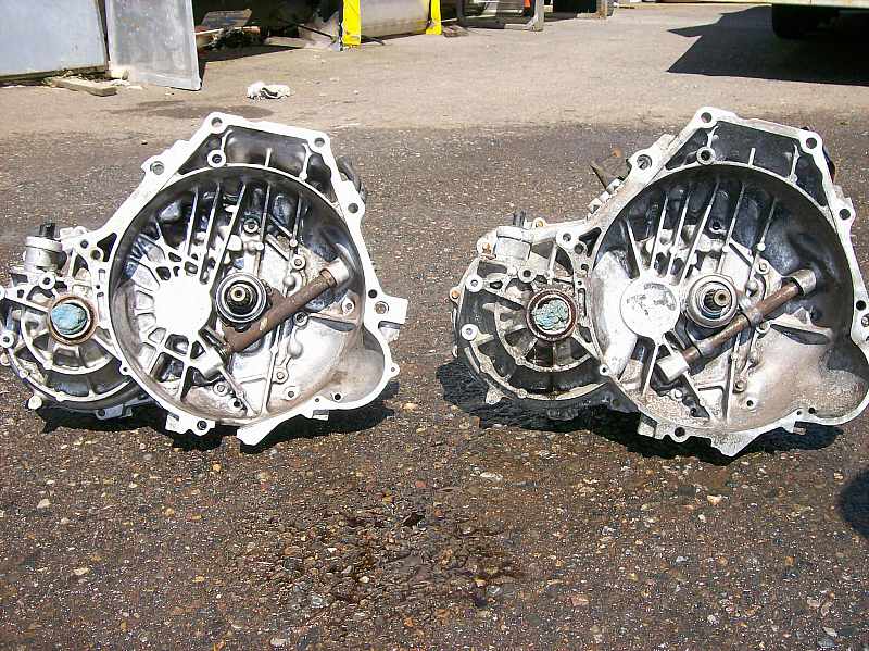

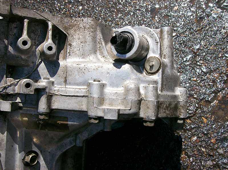

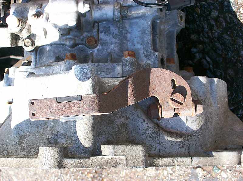

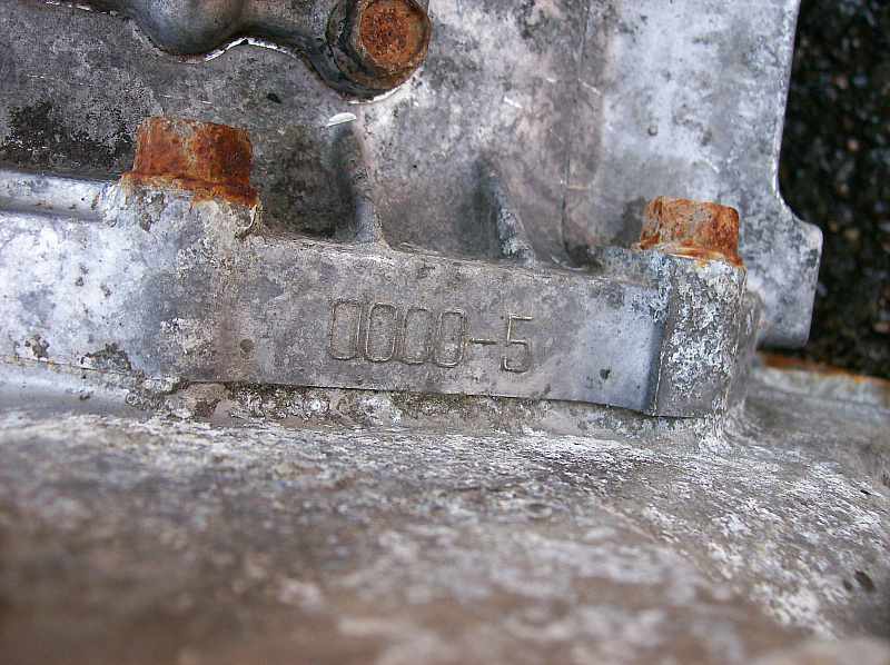

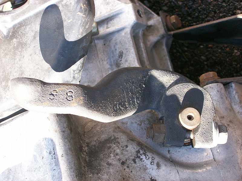

I didn't see any mention of this so I thought I would throw it out there.
When deciding on a transmission to mount to the 4.9 I had several to choose from. I decided to go with an isuzu. When choosing between the 2 I had available I came accross some differences between years. One was out of an 85 the other was out of an 88. Here are some pics to illustrate the differences I found.
88 on the left, 85 on right
88
85
88
85
88
85
88
85
As you can see these differences wont effect mounting or driving in any way. I did notice that the 88 case has extra webbing from strength as well as holes in the bellhousing for venting gasses. The arm is very different between the two as well as the fork. One of the pictures also shows a casting number on the bellhousing. As you can imagine I went with the 88 tranny for the not so obvious differences it had.
Just thought I would throw it out there since this thread is all about the differences in trannies. Any thoughts on this?

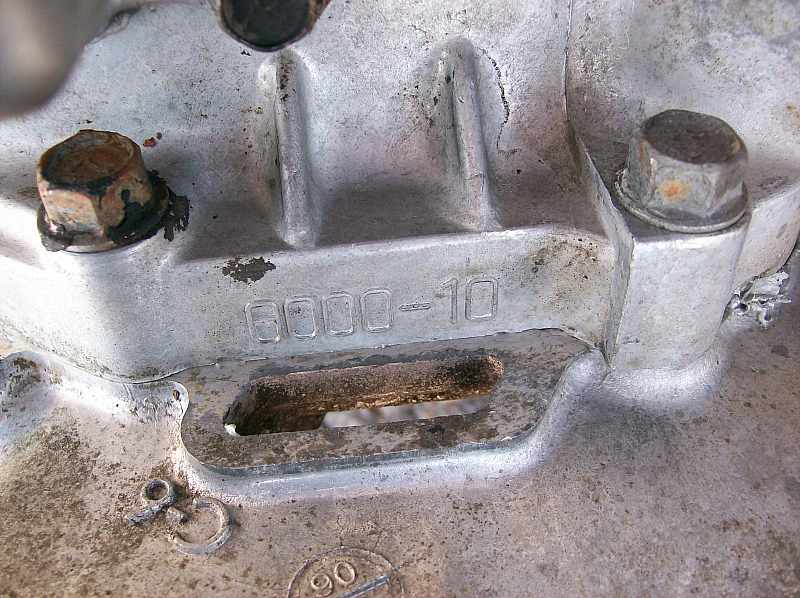

03-09-2008 02:41 AM Click Here to See the Profile for 86fierofunSend a Private Message to 86fierofunEdit/Delete MessageReply w/QuoteDirect Link to This Post

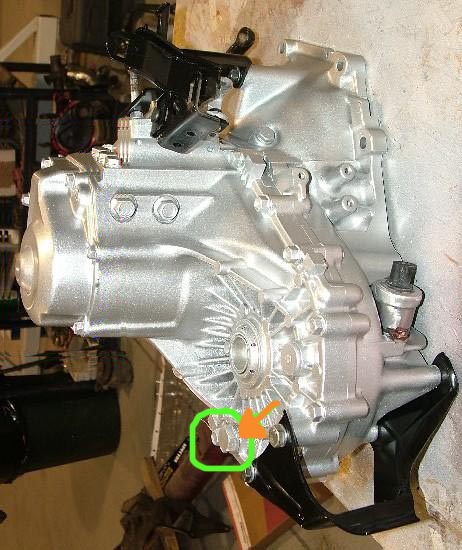

Wow, great write up!!!
Can anyone point out in the pictures where the drain hole is on the Isuzu?
Is this it?
If it is, does anyone know what size socket it is?
[This message has been edited by 86fierofun (edited 03-09-2008).]
Dodgerunner
Posts: 8735
From: Lincoln, Nebraska
Registered: Sep 2004
Feedback score:    (51)
Total ratings: 302
03-09-2008 09:33 AM Click Here to See the Profile for DodgerunnerClick Here to visit Dodgerunner's HomePageClick Here to Email DodgerunnerSend a Private Message to DodgerunnerEdit/Delete MessageReply w/QuoteDirect Link to This Post
Yes that is it.. Whatever fits I believe I used a non-metric but don't the size...
86fierofun
Posts: 3473
Registered: Aug 2004
Total ratings: 65
03-09-2008 01:15 PM Click Here to See the Profile for 86fierofunSend a Private Message to 86fierofunEdit/Delete MessageReply w/QuoteDirect Link to This Post
I think it was bigger than anything I had, and I had up to 1" if I remember correctly.....
One thing I'll add...
If you have to replace the clutch arm bushing in the 88 Isuzu, it requires the same tool as the Getrag. The 85-87 tool is different.
Rodney sells the tools for all of them.
