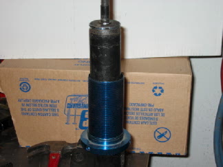

The first pic shows the adjusters you will need, they are 5" aluminium and can usually be found used on Ebay for $? or new at this link: www.rpmnet.com for about $47.00 each, they are called C-O Hardware Kit-AFCO Aluminium Shock w/5" sleeve, part number 20126.
I purchased mine at a racing swap meet for $25.00.

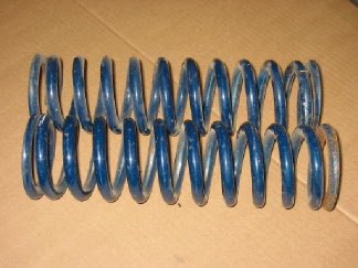

The next pic shows a set of 12" coil springs with a 2 5/8" ID, you'll need a pair with about a 250Lb spring rate.
I got mine used for $30.00 at the swap meet, they can also be found used on Ebay for $? or new at this link: www.rpm.net.com for about $67.00 each, they are called AFCOIL-12" Coil-Over 250Lb Rate 2 5/8" ID.

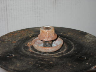

Remove the items in the next pic, items "A" are what you see on top of the strut tower, item "B" is on the underside of the tower.

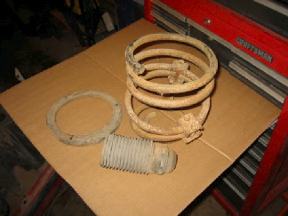

The next pic shows the spring, rubber cushion from the upper spring perch and the dust boot, all of which are no longer needed.

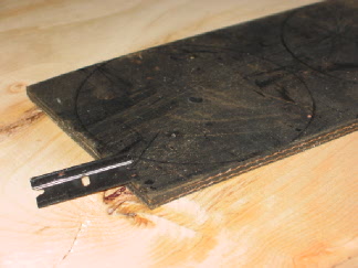

I traced a 4" diameter circle using a compass, see next pic.
Then I cut the circle out with a single edge razor blade, see next pic.

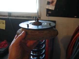

The next pic is a side view of the spring retainer plate.

The next 3 pics show where to put the bushing and placing it on the strut shaft.
Now it's time to put the washer and nut on the shaft, see next pic, and tighten them down.

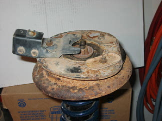

The next 3 pics show the spring perch in position and the top pieces in place for safe keeping until install.
The next pic is an underside view of the assembled strut.

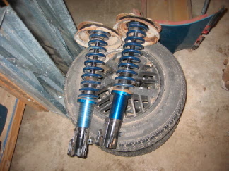

The last pic shows my completed coil-over struts.
That's it in a nutshell, buying new parts and using the old struts you'll have about $228.00 into this project.
A little searching for used stuff can really knock the price down as I have about $55.00 or so into this project.

So this set up is fully adjustable right... do you have them all the way up? Would a 7" sleave work better?
Let us know how they work
Rob
fierohoho
Posts: 3406
From: Corner of No and Where
Total ratings: 209
02-11-2004 10:24 PM Click Here to See the Profile for fierohohoClick Here to Email fierohohoSend a Private Message to fierohohoEdit/Delete MessageReply w/QuoteDirect Link to This Post
Thanks for the +'s everyone.
Hey Tina, been doing some home projects lately, the swap meet was at the end of January, it was -26 degrees when I went, it started at 8:03am and was outside. I had to go through every booth there before I found the adjusters, one was used but you could hardly tell, the other was still in the package and brand new. There were plenty of springs to choose from though, you just had to sort through to find the right rate spring. I'll try and remind you about the swap meet next year.
Rob, the last pic has the adjusters all the way up just to keep everything snug and the strut shaft is fully extended, if the stock coil spring was still on there it would be the same length overall. The only thing a 7" sleeve would do is to allow you to make the car sit up higher than stock. When I install them I'll put the wheels on and drop the car to the ground then start to lower the bottom perch until the car sits where I like it, most likely about a 1-2" drop for the rear. I don't anticipate getting the project car to the point where I can install them for a while yet but I'll post a pic when I do.

I did not see any spring retainer at the top of the spring. Dont you need some type of holding device to keep the spring centered? You said you have the adjusting nut high to keep everything snug, but when you lower the nut in the car to get the hight you want the top of the spring will be free to move around if the car ever "jumped" over rail road tracks or bad roads at speed or when lifted by a jack. When the car comes down will the springs be seated properly? I have seen custom spring perches to prevent this condition. That is why both the top and bottom spring pirches on the stock system have a rolled edge, to "hug" the spring and keep it firmly in place. And there should always be a little tention on the spring to help prevent the "unseating" of the spring.

dguy-there are no set screws to pin the sleeve to the strut tube. To adjust it I plan on jacking the car up to take the load off the spring, give the lower perch a few turns and drop it back down to see how I did, not the fastest way but when you're done I doubt there would be much need to readjust later. There may be enough pressure on the sleeve to keep it from spinning but I'm not sure. The lower perch does have an allen head set screw in it so when you get everything set where you want it you can lock it down and forget it.
spearce-the ID of the sleeve is about 2.035 and the OD of the strut tube is about 1.985
Rickady88GT-it looks like the knob that sticks down from the spring retainer plate that the bushing I made sits around should be adequate enough to keep the spring centered, if you look at the pic of the underside of the assembled strut you can see the washer I put back on, that washer seats on the underside of the knob, I guess that and the washer will keep it centered good enough for me.
It would be fairly easy to find a piece of tube with an ID a little bigger than the OD of the spring and figure out how long it needs to be and then weld it to the underside of the spring retainer plate, I will definately look into this in the future though.
My guess for the rolled lips on the stock spring perchs is due to the fact it's so big in diameter and sits so far from the strut tube whereas this upgrade has the spring very close to the strut tube.
Fiero STS- I looked and found the bushings you mentioned and the dust boots, I took some pics and will throw together some additional info on the snubber later today hopefully.

If you had inverted the bumpstop plate you would have saved yourself from constant bottoming-out, also - find some tubing that has a 1/2" larger ID than the spring OD and weld to the plate you fabricated - this will be far more effective in centering the spring rather than relying on the rusty, decomposing bumpstop to "center" the spring.
Also, didnt see if you did or didnt reinstall the dust boots around the strut shaft, DONT, they just trap moisture that will soon rust through the chrome finish on the strut shaft which will make your new struts worthless by allowing the nitrogen ( assuming that they are N charged ) gas to escape past the seals.

i had been thinking about this since january of last year when i got coilovers for my integra.
i just measured the ID of the sleeve for my integra C/O's (pulled them in favor of H&R sports) and it's 2 1/16 inch. these are the cheap ebay coilovers. they cost <$80 shipped for a set of 4. yes, 4 sleeves/springs/hats. meaning you could buy them, do your conversion and sell the leftover parts. they also come with upper spring hats to better center the springs. the springs they come with are generally in the 450-500lb/in rate, but new C/O springs can be had for as little as $30/ea from various online vendors (i think i got mine at race tech fab).
as for securing the threaded tube to the strut body, large diameter o-rings actually work very well. they hold it secure and center it at the same time. make sure you put one at the very top of the threaded tube though, or water will get in and rust out the strut body. to install them this way, basically you just put 3 or 4 o-rings on the strut body, about 3" above where the very bottom of the sleeve will end up, spray the inside of the sleeve with hairspray and slide it over the o-rings. they'll slide down the strut body a little bit. once the sleeve is in place, use one last o-ring to seal the very top of it so water can't get in. once the hairspray dries up, the sleeves will not turn on the strut at all. you will need a solvent to remove the sleeves in the future.
a quick search on ebay for "integra coilovers" gave me a page of results with sets as low as $40 before shipping.
integra sets should all be slightly over 2" ID for the tube and should work with stock shocks, but aftermarket shocks like KYB may have a larger diameter (the ones for my integra were about 3/16" larger diameter).
hope this is useful info..

In the middle of doing this very thing. I did not like the clearance between the coil and the upper plate's center piece, so I slide a piece of 2" schd 40 pipe, 2" in length over the snub on the upper spring plate, and tack welded into place. Won't move around much any more, and allows for a 2" unload, before the spring tries to relocate itself ( I don't plan on jumping anything anyway! ). Also, I did not reuse the big piece of the upper assembly, with the studs on it. I just took some 3/8", grade 8 bolts, 3/4" long, and tacked to the bottom of the smaller plate. they fit right in these holes, but will need to drill the ones on the car slightly larger, as they are closer to the 5/16" size. I did reuse the washer on the strut though, and had to turn it down to fit in the 2" pipe. This piece appears to keep the strut from extending through the top plate if the rubber were to fail in the upper piece. Might keep the rod from going through the deck lid. And it does go as in the picture, if installed the other way, it will not allow the rubber in the upper piece to do it's thing. Like I said, still in the middle of this, but so far so good. I am using the 7" sleeves to cover the strut body as well, and went with 300#, 12" coils. Sleeves and nuts from Coleman racing, and coils from Summit Racing.

With regards to securing the tube to the strut...
When I got my Held coilovers for my 88cradle->87body kit, they simply have you smear a film of silicone on the inside of the tube. Slide it in place, clear off the squished out mess, and you're golden!
It's a minor PITA to get them off if you need new struts (already upgraded mine once), but it's totally do-able.
