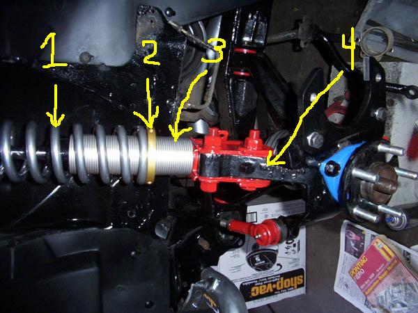

So just walk me through a little part here:
1. The spring is a 12" or 10" (if you want to lower the cara few inches)
300 lbs. for a softer ride, 350 lbs. for a firmer hide
You can buy the springs for just about any vehicle that has the right size, a 2 1/2" inner opening
2. The ring that holds and allows you to adjust the spring height is call a what?
Is the a size needed for it?
3. The sleeve with the outer threads on its call a what?
Is there a set or needed size on it?
Do items 2 and 3 get sold in a set?
4. That is a stock type strut correct, just with the retainer for the spring cut and ground off?
Is this all that needed to make your own coil over?
I can see getting the spring from alot of places for about $30 to $45
How much is everything else and where is a good place to shop for them?
Bobby from NW Indiana
86 Fiero GT, Looking to ad a 93 Northstar soon
thespeedshop@sbcglobal.net
Will
Posts: 10070
Total ratings: 201
07-20-2004 09:48 PM Click Here to See the Profile for WillClick Here to Email WillSend a Private Message to WillEdit/Delete MessageReply w/QuoteDirect Link to This Post
Either 12" or 10" will work. 12" springs give you more travel before they coil bind (yes, 10" springs can coil bind before they hit the bump stops).
Coil over springs are not listed by application. They are listed by rate and length. Like this:
http://store.summitracing.com/eproduct.asp?N=120+4294925130+4294925129+303893
If they don't have what you want, they can special order it. This is where I've gotten my springs from.
adjustable spring seat
threaded sleeve.
Almost always sold as a set with #2.
http://www.colemanracing.com/section/index.htp?id=343
You can save a few dollars by calling Coleman up and geting them to send you just the sleeve and perch because the conical hat is not necessary.
Yes, stock replacement strut with the spring perch cut off. You can get a short threaded sleeve and seat it on the spring perch, but then you can't use a 12" spring.

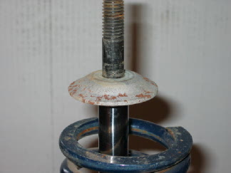

Yes. The conical hat in other pictures is NOT REQUIRED.
As you can see from the Summit and Coleman websites, the springs are $35 and the sleeve/spring perch assemblies are about $30. $65.side plus struts.

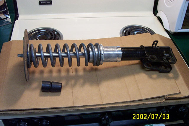

My first set of coil overs:
The only thing wrong with this picture is that I didn't have a stock bump stop on it. Take the stop bump stop, cut the strut boot off of it and put it inside the spring. It fits perfectly and works just fine. The spring being in direct contact with the top plate causes absolutely no problems.
Are you using the Stock Spring Perch trimmed up to hold the Sleeve????
It looks good
4.9 Caddy in Garage! Car in Driveway! ACK!
http://home.cfl.rr.com/fierose
Central Florida Fieros
http://www.centralfloridafieros.org
Will
Posts: 10070
Total ratings: 201
07-20-2004 11:53 PM Click Here to See the Profile for WillClick Here to Email WillSend a Private Message to WillEdit/Delete MessageReply w/QuoteDirect Link to This Post
It looks good
Yes, that's the way this one is made. It is one of a pair of RCC coil overs I bought used. I recommend cutting off the spring perch entirely and putting on a full length sleeve for greater adjustment range.

Having a 12" spring limits the drop more-so then the 10". I would recommend the 10" if you want the car really low with a 8" sleave.
David Bartlett
Posts: 1085
From: Burlington, Ontario, Canada
07-22-2004 04:34 PM Click Here to See the Profile for David BartlettClick Here to Email David BartlettSend a Private Message to David BartlettEdit/Delete MessageReply w/QuoteDirect Link to This Post
Originally posted by Joe Torma:
David,
I can't see what is going on at the top of that strut when installed...how does the spring hold up the car? Is the entire weight of the vehicle on the center of the strut mount plate? Or is it like Fierohoho's--the spring contacting the body?
Just wondering because I'll be doing something like this soon
The coleman hat rides against a rubber busing inside one of the 2 shock mounting plates.
Will
Posts: 10070
Total ratings: 201
07-23-2004 10:09 AM Click Here to See the Profile for WillClick Here to Email WillSend a Private Message to WillEdit/Delete MessageReply w/QuoteDirect Link to This Post
12" spring only limits the drop if you use the conical hat. If you don't do that, there aren't any issues with a 12" spring.

I was looking at the pieces that came off the stock strut and I remembered someone mentioning that the rubber bushing in the top plate may not be designed to handle the up and down stresses from the strut rod. I figured that must be why there is a washer on both sides of the top plate. If I put the washers in the same place with my coilover spring installed it looks like it would work ok but will the top of the spring slide to one side or the other? I decided to cut a 1" strip of 16gauge metal and weld it on to retain the top of the spring. This will also make the lower washer stronger. I am using all the stock parts with this one addition and minus the dust boot. This should put the shock bumper at the stock height also. In case the top of the spring is a little lower than it could be, the adjusting sleeve should have plenty of room to handle the difference. This setup is for stock suspension height at this time. I am guessing that if I want to lower the car I will just lower the bottom of the spring.
this is what happens to a perfectly good brand new strut when you don't know what you're doing...
I am posting these pics to show what the inside of a KYB strut looks like. and how thick the tubing wall is.
EDIT: I cut this strut in two after I accidently nicked the strut tube with the dremel cutoff disk. It did not break in two...
[This message has been edited by cptsnoopy (edited 08-01-2004).]
You're misunderstood what I said. I said that the center bushing is designed to handle ONLY the forces from the strut rod, and NOT the weight of the car. The washers are there so that if the bushing fails the car doesn't lose all damping on that corner. If you look at a stock strut, the spring presses against the top plate, NOT against the center bushing. Any coil over setup needs to copy that design.
NO. Look at this picture:
There are ABSOLTUELY NO PROBLEMS doing things this way. The possibility that the spring may move up to 3/16" in any given direction is a COMPLETE NON-ISSUE. IRRELEVANT. The only time the suspension is ever unloaded enough for the spring to come off the plate is when the car's jacked up, but unless you've got the car ridiculously low, there wo NOT be a problem with the spring coming off the center bushing.
This setup will put the entire weight of the car on the center bushing. I do not think that this is wise.

I am wondering if the larger washers are only on an 88? here is a pic of the washer I have. If the 84-87 have the smaller one that fierohoho posted earlier in this thread then I will swap these into my 86 when I change the struts on it. that way no extra work is done. these large washers are approx 3 3/4" in diameter.
Will
Posts: 10070
Total ratings: 201
08-03-2004 09:06 PM Click Here to See the Profile for WillClick Here to Email WillSend a Private Message to WillEdit/Delete MessageReply w/QuoteDirect Link to This Post
This is the washer to which I was referring:
The one you have pictured must be an '88 piece. I'd suggest using the early one instead of the one in your picture.
