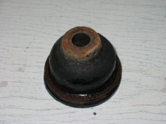

only thing you forgot is to replace the rubber snubber on the shaft. this protects the shock when it bottoms out.
Well I think I've found the way to deal with this problem.
The factory snubber that sits on top of the dust boot from my strut was in bad shape, the center that holds the snubber and dust boot to the strut shaft had come loose, most likely due to the previous owners spring compressor lowering attempt, this piece is metal that was bonded to the rubber.
Just to check things out I removed the snubber from the dust boot and reinserted the center.
I held the snubber in the coil and found the fit was too close for what I was comfortable with so that piece was out.
So, off to the parts store where I found a possible solution in the "Help" section. It's a shock absorber bushing, it's 1 1/2" long with a hole a little smaller than the strut shaft diameter, part number 31010, my cost was $3.65 + tax.

I'm curious if the rubber bushing is needed between the strut shaft and where the strut mounts to the body? Could the strut shaft be solid mounted? I wonder how that would work?
This shows the bushing I am talking about.
Anyone?
