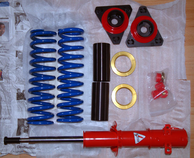

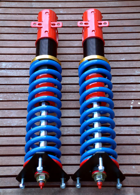

01-17-2010 01:49 PM Click Here to See the Profile for Fie RoClick Here to visit Fie Ro's HomePageClick Here to Email Fie RoSend a Private Message to Fie RoEdit/Delete MessageReply w/QuoteDirect Link to This Post
I built these a couple of years ago (after reading this thread ):
Originally posted by Fie Ro:
New koni's with Held coilover kit
Didnt post the build itself but this may be usefull info when using Koni shocks. The perch is easily cut off with a grinding wheel:
Then you will find it will not slide off because the top of the Koni strut tapers a bit outwards:
No problem. But this also means the inner diameter of the new sleeve is bigger than the diameter of the lower strut, so :
My advice is not to cut too much off this ring because it helps centering the sleeve..
With the sleeves installed I filled the gap at the top with sealant to keep water and debris out
Hope this helps..

That looks more or less like the kit I bought. It will work fine with 12" springs. You will find that the spring seat is around 2" from the bottom, so that length of threaded sleeve is good.
Thanks.
I just want to double-check on something before I actually order a set - Are all four sleeves exactly the same in the 90-97 Accord kit. In other words, the sleeves aren't different for the "front" as opposed to the "rear" are they? I suspect they're all the same, but I just want to make sure before I post in my local Fiero club's forum to see who wants to split a set.
With the kit I bought, there were 2 different sizes of sleeves, 2 were 7" and 2 were 5". With 12" springs either will work. The 5" may even work with 10" springs, but I'm not positive.
Rick
Posts: 13584
Total ratings: 291
01-18-2010 10:14 PM Click Here to See the Profile for PatrickClick Here to Email PatrickSend a Private Message to PatrickEdit/Delete MessageReply w/QuoteDirect Link to This Post
Interesting. The diameter of the sleeves was all the same though, right?
right

What I don't understand, is why can't you just use the existing spring perch with a sleeve, and a 7 inch spring?
There is only 4" of travel in the Fiero strut wouldn't a 12" springs be a bit over kill??
doublec4
Posts: 6755
Total ratings: 129
01-27-2010 01:16 PM Click Here to See the Profile for doublec4Click Here to visit doublec4's HomePageClick Here to Email doublec4Send a Private Message to doublec4Edit/Delete MessageReply w/QuoteDirect Link to This Post
People get rid of the strut perch because of its large diameter. This gives people additional clearance for wider rims/tires.

For those of you who have done this,
When trying to make adjustments to the ride height, what keeps the threaded sleeve from rotating around strut body when trying to turn the collar?
Fie Ro
Posts: 3616
From: The Netherlands, Europe
Total ratings: 129
01-28-2010 03:21 PM Click Here to See the Profile for Fie RoClick Here to visit Fie Ro's HomePageClick Here to Email Fie RoSend a Private Message to Fie RoEdit/Delete MessageReply w/QuoteDirect Link to This Post
With the car jacked up and the spring unloaded it should be easy to keep the sleeve in place...
But imho, it is better when its sealed to the strut..
- it also keeps the sleeve from turning
Keep in mind that a 7" spring has an overall length of 7". The total distance between the coils might be around 3-4" (I'm guessing here, but I could check with the 7" ones I have). Put that on the car and drop the car down and the weight compresses it 2-3", so you have very little/no suspension travel before you coil-bind the spring. Very bad for the spring let alone the ride!
