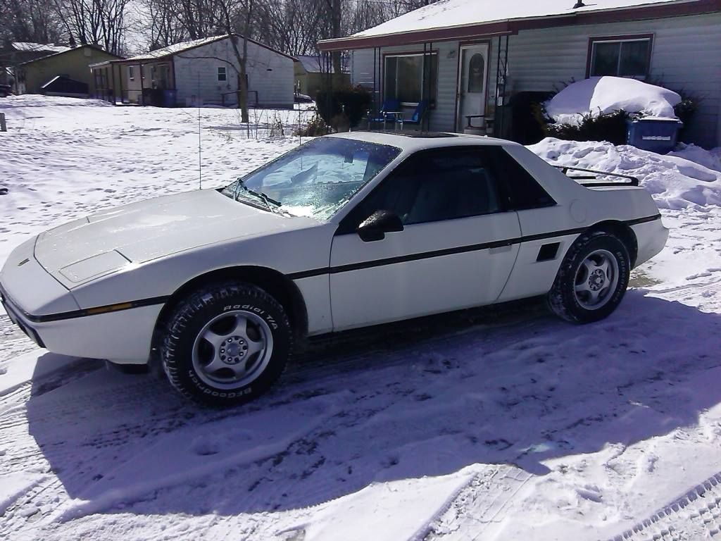

whats up guys, i have a 1984 se that im looking to do a motor swap in .right now its a 2.5 3 speed auto, i really dont want another duke lol. i have two motors, but i cant decide on which one i want to use. right now its between a sc3800 out of a regal, or a 4.9 caddy v8. both have low miles. what one is the easier swap? which one will be easier to wire? am i gonna break anything with either one?
thanks for any input
