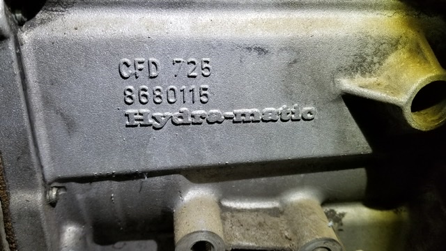

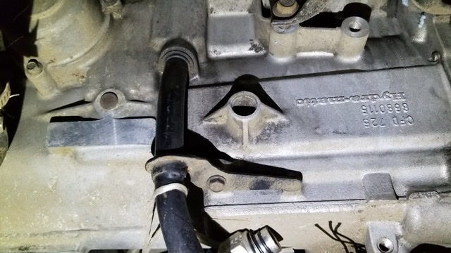

These are the markings on the transmission that came with my 4.9. Can you tell which transmission this is?

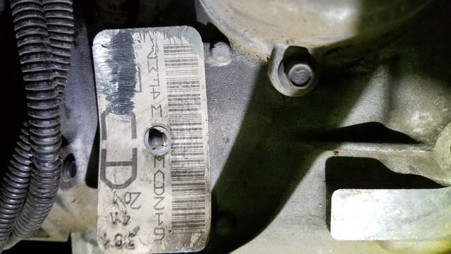

Report this Post01-13-2020 05:30 PM Click Here to See the Profile for olejoedadSend a Private Message to olejoedadEdit/Delete MessageReply w/QuoteDirect Link to This Post
Is there a stamped aluminum tag near the socket for the dipstick?
That tag has the trans ID code on it.

The last pic above is the only stamped info. There is a flat area, similar size and shape to the above, nearer the bottom of the dipstick tube but there’s no sign that anything was ever stamped there.
There is a paper or plastic tag with some numbers on it...

Report this Post01-13-2020 07:30 PM Click Here to See the Profile for olejoedadSend a Private Message to olejoedadEdit/Delete MessageReply w/QuoteDirect Link to This Post
That is the trans ID tag.
You're lucky to have it, many are missing.
That tranny is a 92 Deville, 37/33 sprockets, 3.06 diff
Not the best choice....😟

That’s what I was concerned about, after reading up in the thread. Damn.

Report this Post01-13-2020 09:22 PM Click Here to See the Profile for olejoedadSend a Private Message to olejoedadEdit/Delete MessageReply w/QuoteDirect Link to This Post
It can be rebuilt with 35/35 sprockets and the 3.33 diff.
Well worth the money.
