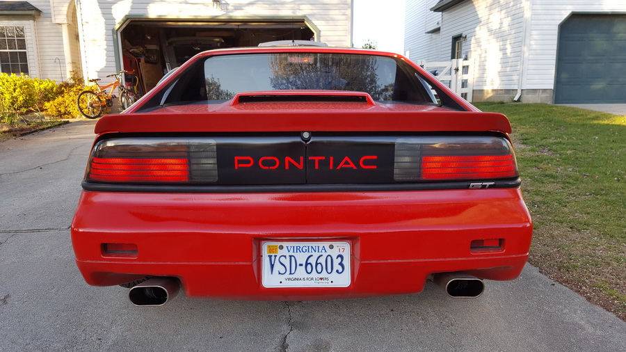

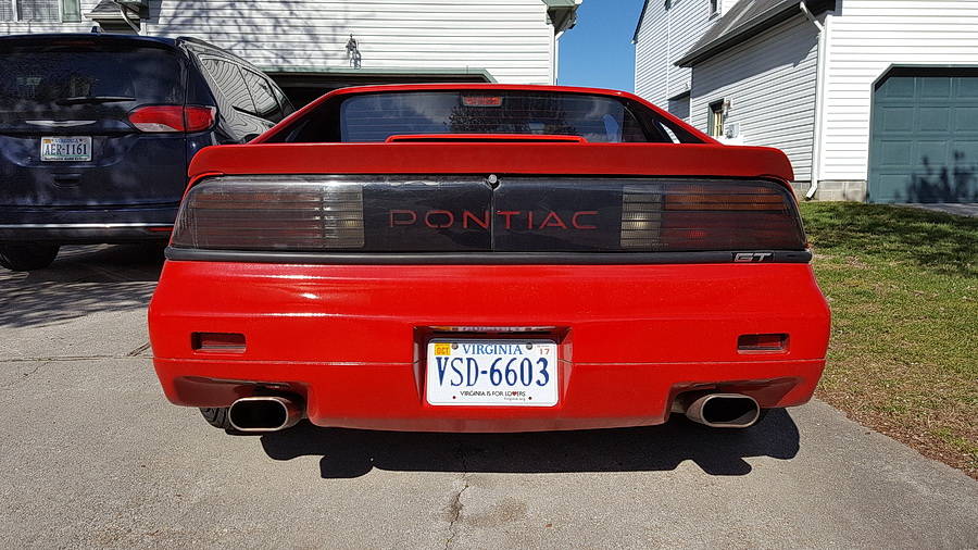

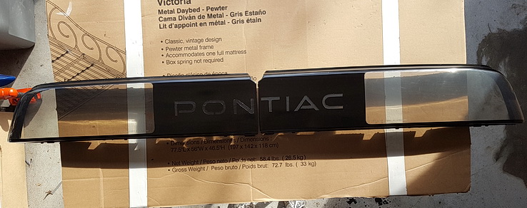

had a set of cracked and faded GT tails on my daily driver. I snagged a set of GT lights off a 87 GT in the junkyard the other day. They were perfect, no cracks and only a little delam. I took them apart, cleaned and restored them using a headlight kit. Then taped them up, used some vinyl to make a template for the PON-TIAC and then hit them with about 4 coats of black gloss paint. They turned out great and really cleaned up the rear. I also had a BTR LED taillight kit so I did the install at the same time. Clean and bright. Love the look, now I'm going to do the same thing to my LS3 car.
before
after
