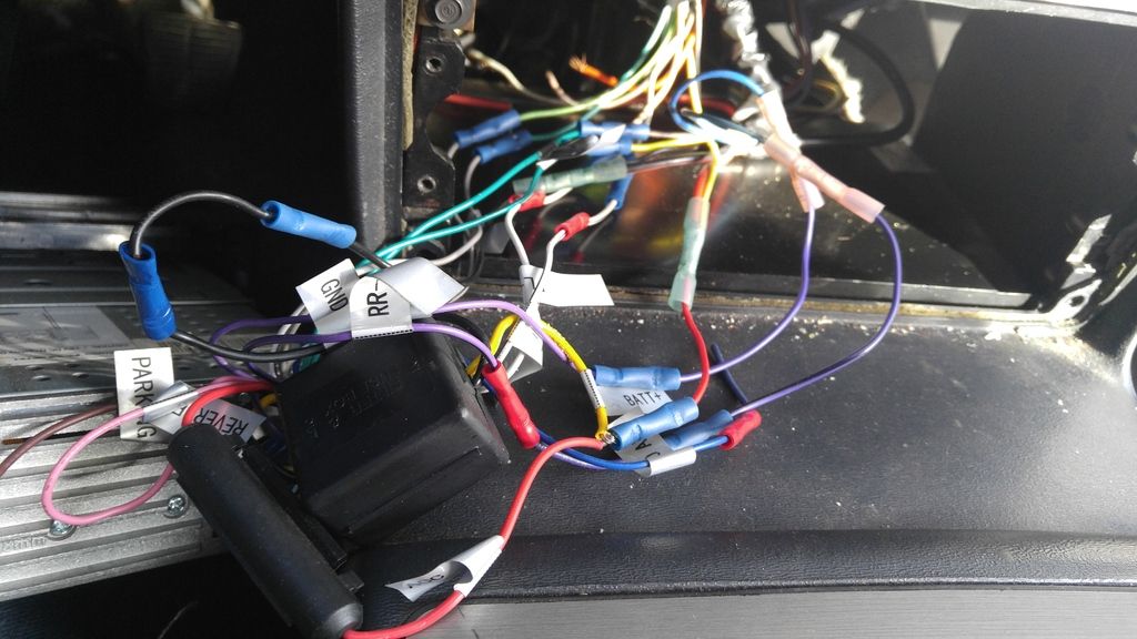

Now, I did finally get a chance to tear into the car with the first known issue and that would be the draw on the battery. PO decided best solution was to put a kill switch in instead of finding the drain. Now a few things I know the previous owner installed;
Radio, HID headlights, Gauges, A Led tail light strip, and the kill switch.
I made the assumption he was not a very good installer when i attempted to try the radio that was installed and only one speaker played. So while still snowed in i decided to pull out the radio.
Add to the list I need a new radio bezel.
Beautiful can you find the problems? Other than instead of buying the $10 harness we decided to just cut it and wire it in with there mad wiring skills.
Sadly that was not the source of the draw so I need to continue on to the lights and the gauges. Ugh.

Why did he join the constant and switched battery powers into one common for the stereo? And what's the stripped wires out of focus in the back?
So, switched and constant are wired together into 1 then seperates them again into 2 wires. (why I have no idea) In the background I found multiple ground wires cut, along with Illumination wire running to a speaker wire. There are a few other things. I got to get a new harness an do some repairs

Report this Post01-31-2016 11:45 PM Click Here to See the Profile for PhirewireSend a Private Message to PhirewireEdit/Delete MessageReply w/QuoteDirect Link to This Post
Phirewire
1545 posts
Member since May 2012
I assume the rest of the wiring he did is similar so out it all goes.
this is the rats nest i removed for that quality radio install.
