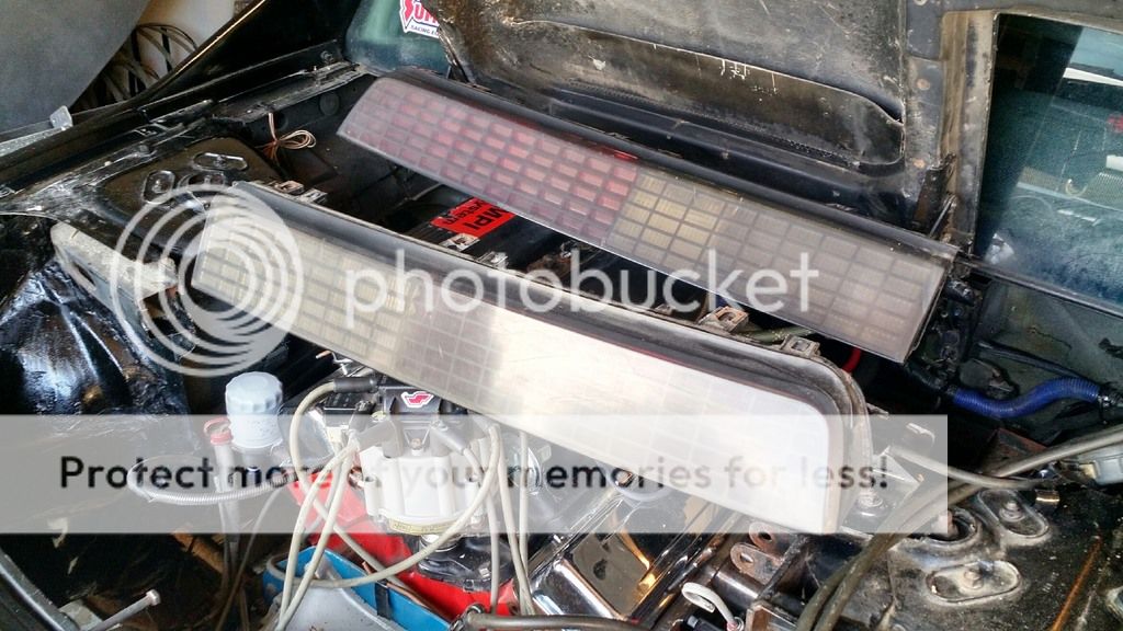

Behold. decent but dingy old tail lights.
I ran them through a heated wash tank. They separated easily. I scraped off the old glue.
I used a 3m headlight restoration kit. They go from 500 grit to 800 grit. I had some 2k laying around so i took it to 2k. Then buffed them out.
Half way through and you can see a huge difference.
I ran the black plastic through a sand blasting cabinet to get off the crappy old reflective coating and to just clean it all up a bit better.
Here is everything put back together just so I could get it home intact. Huge difference!
I Primed it.
Painted it metallic.
Cleared it because I had it laying around, so why not.
Taped the clear covers where i didn't want paint. I used a paint called oil rubbed bronze. I just really like the color. It looks great next to black, red, white, & especially gold.
I ran a few beads of sealant around the housings.
Boom! There you have it. Not perfect but a heck of a lot better than what they were.

Nice cleaning the covers.
GM and others used "Chrome" paint.
I've tried using bright gloss white on a spare but does not perform the same and light is noticeably dimmer.
Using Metal paint likely does same thing even w/ clean coat.
Note: Many Spray paints don't need primer to paint plastic.
You must clear the plastic... Careful use carb or brake cleaners works. They removes all crap and cleaners can eat plastic and old paint a bit so almost any spray paints will stick. Spray cleaner and then dry fast w/ air. Rags etc will stick to the plastic too.
If dim w/ Metal paint, using 2357 may help. (Rodney's bright taillights etc.)
I have use 2357 and a bit brighter on turn/brake filament, little dif on tail/park filament when have red lenses.
2357 draws more power and lights faster but have allot shorter life for brake/turn section... ~1/3 of lifetime. If you drive allot, get stuck in slow traffic often, then you will be changing bulbs more.
