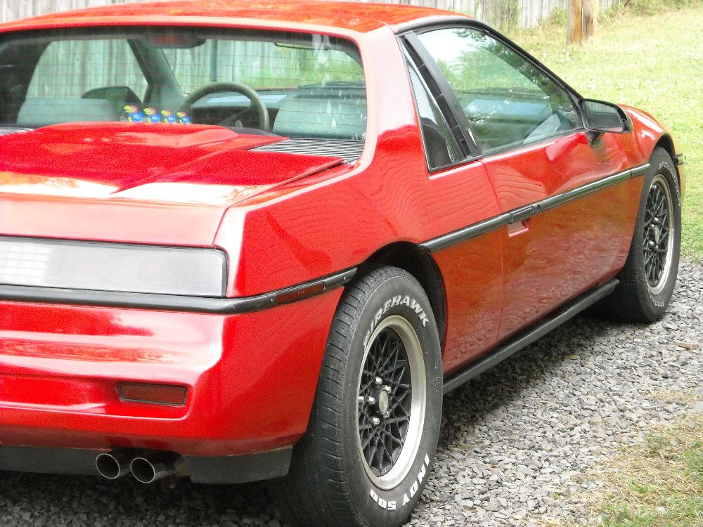

09-23-2011 04:55 PM Click Here to See the Profile for 30+mpgClick Here to Email 30+mpgSend a Private Message to 30+mpgEdit/Delete MessageReply w/QuoteDirect Link to This Post
By not clear coating the red paint & having sit in the hot Arkansas sun (I kept it in a garage in Parsons, Ks), the red faded.
Sooo,
I wet sanded all the panels with 320 grit paper. Sprayed 3 coats of red followed by 2 of clear. Wet sanded any runs w/ 400.
Sanded all the painted panels in the following order:
600, 1000, 1200, 1500, 2000 grit papers.
Then machine buffed in the following order:

09-24-2011 02:00 PM Click Here to See the Profile for 30+mpgClick Here to Email 30+mpgSend a Private Message to 30+mpgEdit/Delete MessageReply w/QuoteDirect Link to This Post
An in progress photo of the project:
Still to do:
Wax
Fill moulding where needed and paint
Clean wheels & tires
Now I know why retired guys win car shows.
They have the time.
They can spend a couple of hours or more per day, six days a week, prepping for the next car show!
