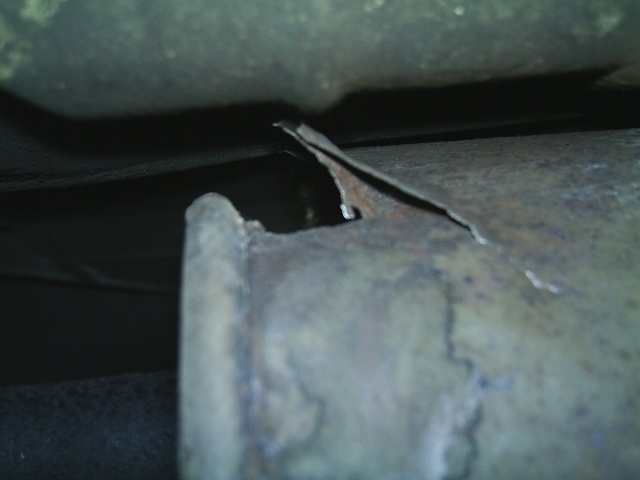

Old muffler.
Had a new muffler installed.

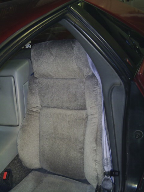

Put newly sewn upholstery on driver's seatback.

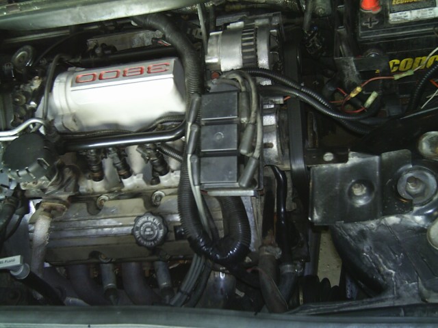

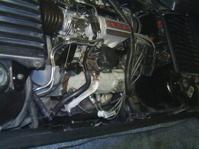

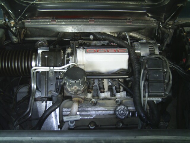

Checked temp sender for correct resistance at temperatures. Getting temp gauge to match scan tool readings.
Meanwhile, here's some engine photo updates:

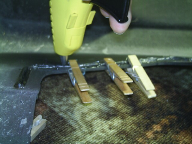

12-03-2005 06:12 PM Click Here to See the Profile for 30+mpgClick Here to Email 30+mpgSend a Private Message to 30+mpgEdit/Delete MessageReply w/QuoteDirect Link to This Post
Rear cutout for the right exhaust was getting a little droopy.
Compare to the stock left cutout.
So I decided to reinforce it using coat hanger wire & hot melt.
Sealed in hot glue. Nice & strong.
[This message has been edited by 30+mpg (edited 12-03-2005).]

Installed
under the dash above the driver's right leg
Cleaned up the engine a little more. Plastic valve cover
Shaved the grill mounts again (easy mod)

Here's what the regulator looks like

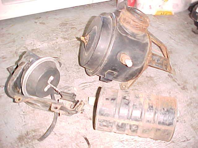

Bought a V6 aircleaner w/mounting bracket
and a vapor canister w/ mounting bracket
Both for $10 each.
The space these normally occupy is presently occupied instead by the Park Ave air cleaner. The gas tank breather tube to the canister was cut off and pinched shut right below where the canister should be. It makes it difficult to get more than a few gallons in the tank when filling up.

Modded the vacuum lines to clean up the engine.
