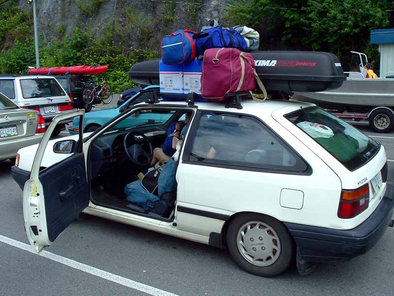

Oh, and here’s what we’ve been forced to transport the clan in the last few years. The dog refuses to go on another trip with this car!

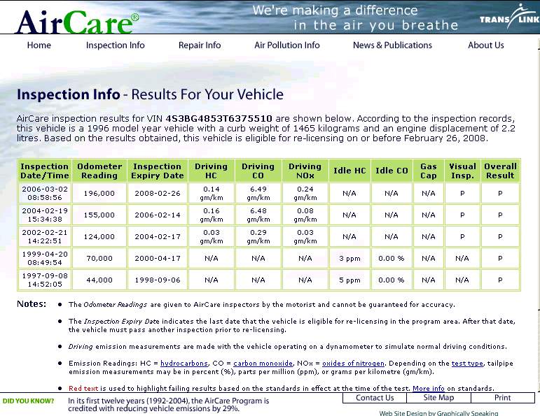

Loafer, this is kind of interesting - The second Subaru you linked to was one of the very few non-Volvo vehicles I had already had a quick online peek at.
I was considering actually having a look at it in person, but two things sort of scared me off. First, it's a dealer selling it, and I detest used car dealers. And second, I ran the VIN through the local AirCare website and saw a couple of discrepancies in the testing dates. It seems that more than once it was late getting tested. (That’s kind of strange because you can’t insure a vehicle here unless it’s passed AirCare.)
I also noticed that two years ago it had just under 200,000K, so I would estimate (by looking at it’s bi-yearly mileage figures) that it’s probably up around 240,000K now. (Note that unlike the first ad you linked to, the dealer did not report the mileage for this particular vehicle.) Rightly or wrongly, that much mileage sort of scares me away (at least from a non-Volvo wagon).
I’m also a little leery of full time AWD vehicles in regards to gas mileage. Sure, AWD is great when it’s needed the two times a year when we get snow here, but is it really worthwhile if the AWD is helping to gulp down the gas the rest of the year?

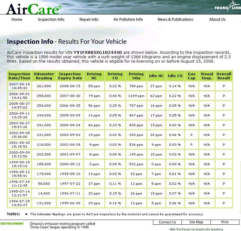

I ran the VIN for a different vehicle through the AirCare site. This is for a 1986 Volvo 740GLE wagon.
What's wrong with this picture?
Hanky-panky... ?

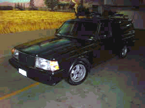

Patrick, any B230 engine'd Volvo will be ideal, turbo or not, it really doesn't make much difference. I would opt for the turbo, they still aren't fast stock, but are more capable in traffic. Both of my Volvos are turbo B230FT engines. The auto tranny is the same way. They are just as long lived as the engines. Its quite rare for them not to live the life of the car which is easily over 300K miles. The manual tranny M46 used in the turbos is quite weak. But don't beat on them and they will hold up well. The M47 manual used in the non-turbo cars is likewise, just don't beat on it.
If you're really interested in fuel economy, the turbo automatic cars don't have torque converter lockup, the non-turbo cars do have it. Likewise, the turbo cars do not have an optional limited slip differential, the non-turbo cars had it as an option.

Oooo, nice Volvo wagon, Rainman. (And thanks for all the tips.)

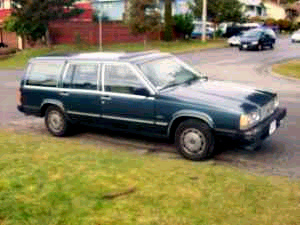

Yeah, I’d like to get one like that, but I’m afraid we’ll have to settle for a wagon more like the one below. I’ll be looking at it tomorrow. I’m hoping someone with a current CarFax account can submit the VIN below and kindly pass on the findings.
From local ad:
