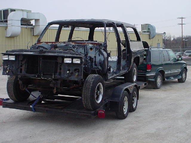

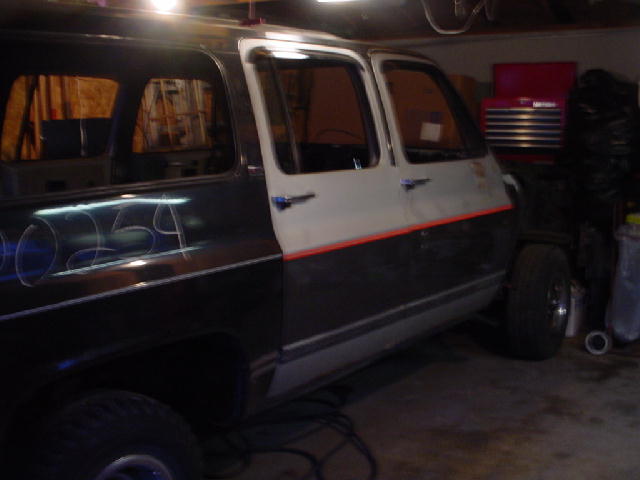

I picked up this Suburban a couple of months ago and was going to redo her. This is the truck that's going to be hauling Fieros around to shows and stuff, so it needs to look good. We were just going to repair the rust with patch panels......but came across another idea.

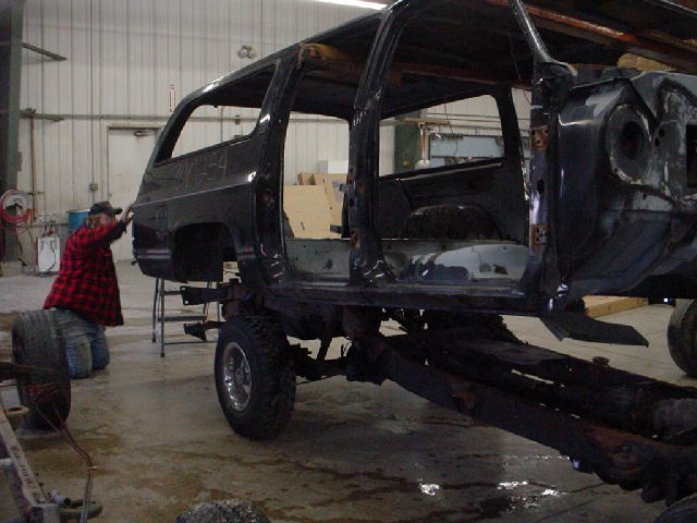

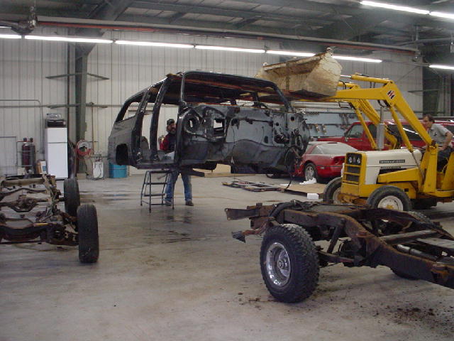

After finding another option, which was a rust free body, we pulled the old body off of the frame...

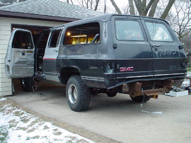

Then, with a littel help from a tractor and some handywork, we pulled our new body off of it's old frame.....
We then lined it up and settled it onto it's new home.....
Then it's back to the house for painting and reassembly!
I'm hoping to have her back on the road by Christmas, but it won't be completely painted by then. We're painting the shell before reassemble and doing a complete job in spring.
It's a 1991 Chevy Suburban 4-wheel drive and the body came off of a '89 Suburban 2-wheel drive.
I hope I remember where all the bolts go.....

Dude, that's one heavy body to go moving around like that!
Mine's a bit older and I used a crane for mine.
Good luck with the project.

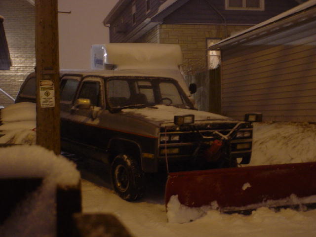

The 'burban ought to make a great tow vehicle, but how did your Jimmy like towing the 'burban?

The Jimmy handled the towing beautifully. Because the rear cargo doors and windshield were not in place, there was next to nothing for wind resistance. We were still well under the towing limits for the Jimmy without the doors and front clip, but a complete Suburban would exceed the limits. It's in the garage now and will move under it's own power possibly today....if I can put the wires in the right place!

The IH tractor with the forks on it handled the lift great. I was worried about the weight of the body on the forks bending the door lip where the weatherseals go, but with carpet sections on the forks there was nothing bent. The guy on the tractor has been rebuilding Suburbans for a lot of years (and currently a body guy) and has moved several this way with no damage. When we pulled off the old body, we used 2 engine hoists. One through the rear doors, with a chain wrapped through 2 holes cut in the rear floor, and the other through the driver's side rear door and the chain wrapped around the door post between the doors. Once we lifted, we pulled the rear wheels and had a floor jack under the rear differential and rolled the chassis out from under the body. We then dropped the body onto 4 dollys (the 4 caster type that you put under the wheels of your car so you can roll it all over your garage) so we can keep it out of the way. With the casters, we can roll it around, and when everything is removed, we can roll it out of the garage and the junk guys can come with a flatbed and drag it up the truck and get rid of it.
It's been an adventure so far!

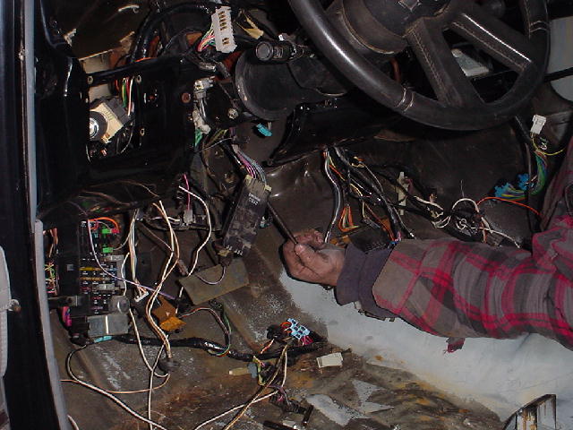

wires and more wires.......
and a pile of stuff to bolt in....
We've been installing a lot of stuff the last couple of days, and she'll be running tomorrow. Hopefully, she'll be finished except for paint, by the 1st of the year.
Thanks for looking.

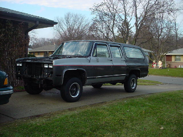

This is the remains of the original body. There was rust in places I didn't know existed!
The body goes to the scrap yard tomorrow.

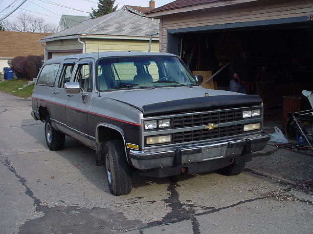

This is the truck as it sits today. It's ready for the road.....just looks ugly until I can get some body work done. It's going to depend on the weather.
Now that it's out of the garage, it's Fiero painting time!
Mark

Report this Post01-01-2004 03:18 AM Click Here to See the Profile for FirefoxSend a Private Message to FirefoxDirect Link to This Post
The Suburban is on the road. It needs a little more stuff bolted inside, but it's ready to tow the trailer. Now, if the Fiero would just show up, I can paint it!
Mark

Report this Post01-01-2004 01:40 PM Click Here to See the Profile for RainmanSend a Private Message to RainmanDirect Link to This Post
What happened to the guys' legs in this picture??!!
JazzMan
Posts: 18612
Total ratings: 653
Report this Post01-01-2004 03:43 PM Click Here to See the Profile for JazzManSend a Private Message to JazzManDirect Link to This Post
He's kneeling...
JazzMan
Firefox
Posts: 4307
From: New Berlin, Wisconsin
Total ratings: 240
Report this Post01-01-2004 10:33 PM Click Here to See the Profile for FirefoxSend a Private Message to FirefoxDirect Link to This Post
He's praying it all fits right..............

Report this Post01-04-2004 10:13 PM Click Here to See the Profile for FirefoxSend a Private Message to FirefoxDirect Link to This Post

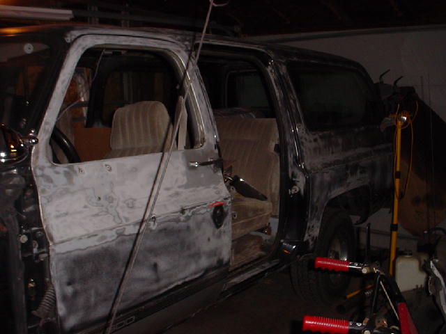

Well, it's all coming together. We've been really humping to get this thing put together before the snow flies so we can use it for plowing. Yesterday the plow was mounted and wired, and today, after the Packer game, the plow lights were installed (just in time....it had started to snow). So....the beast is on the road!
We got about 4 inches here in Milwaukee and it's going to snow for a bit yet. Not too much, but I got to play with the plow tonight and everything seems to be working. Now to get the light bar installed......

Firefox

Report this Post01-06-2004 10:22 PM Click Here to See the Profile for FirefoxSend a Private Message to FirefoxDirect Link to This Post
I finally was able to pick up one of the last additions to the truck yesterday. It's going to look very nice when it's in place.....
It's looking more and more like a truck......and the Fieros might just fit in the back with some ramps!
