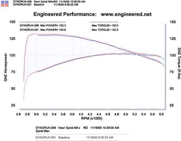

I'm partially color-blind, but to me it looks like the baseline has better torque and HP that the tornado.
