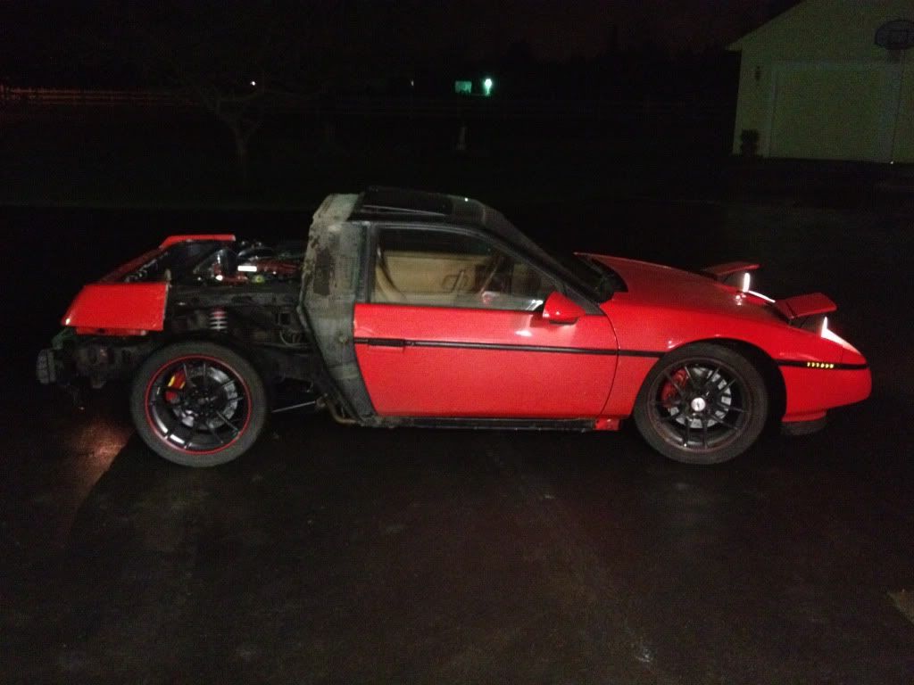

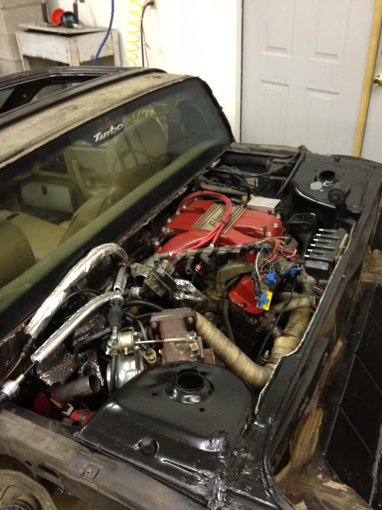

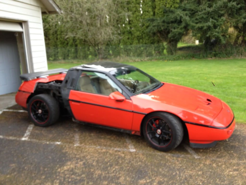

Well the last few months have been very eventful, I just thought id chronicle a few of my adventures.
For those who do not know this is my car 8 months ago at my wedding. She's undergoing some pretty major changes but will be back with a vengeance!

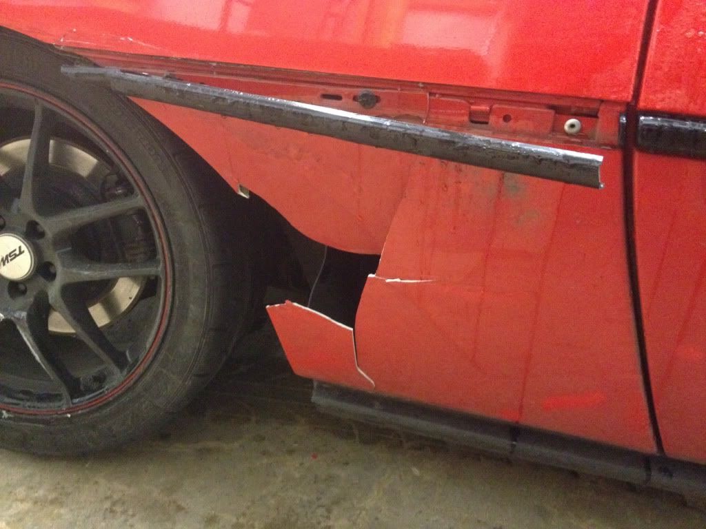

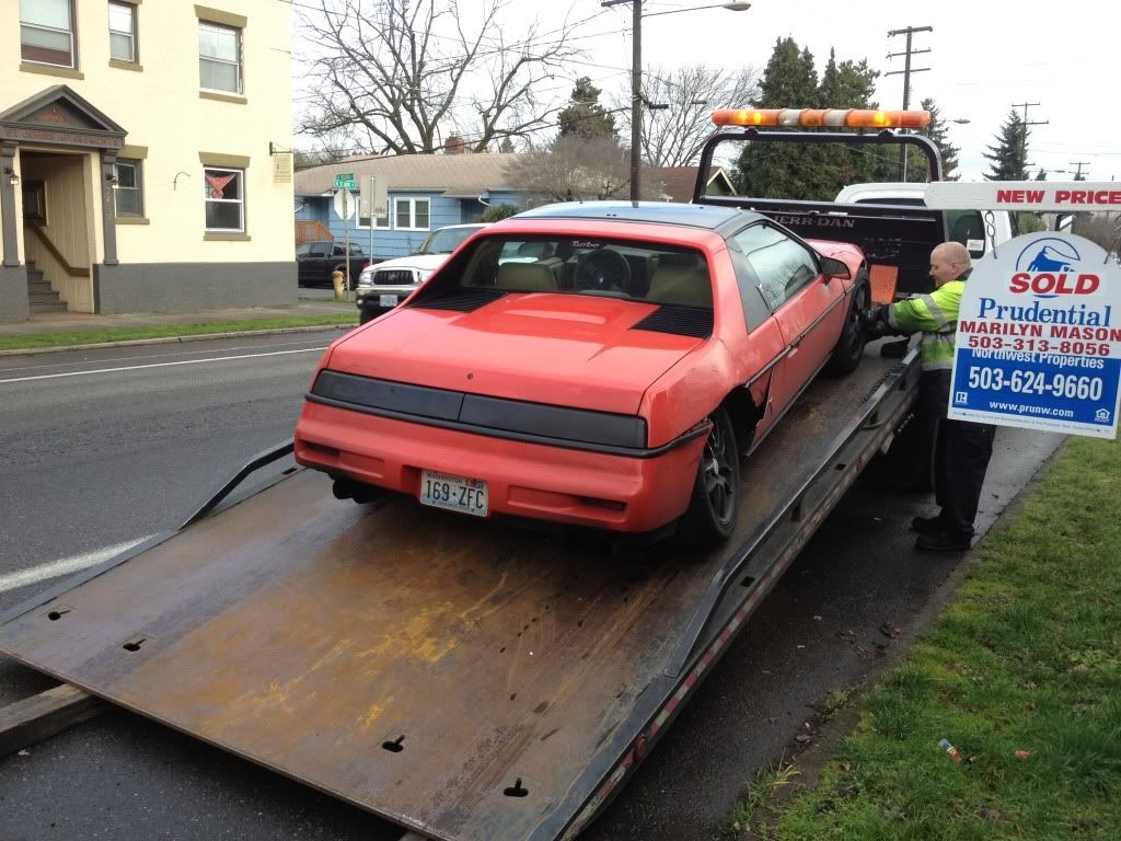

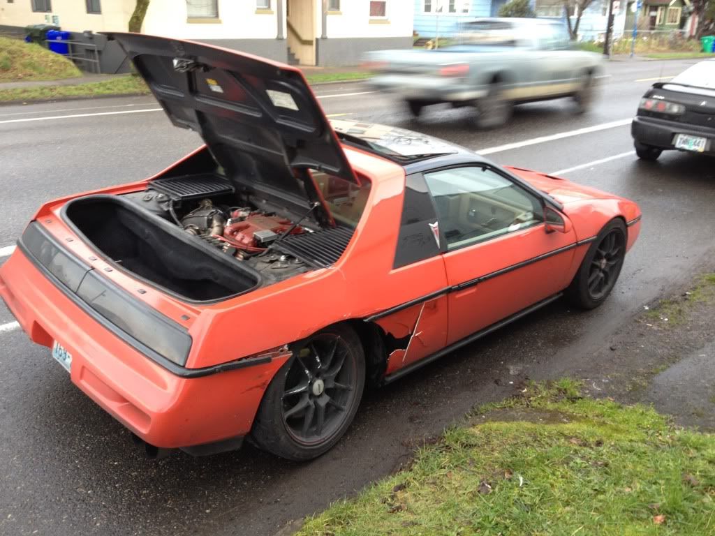

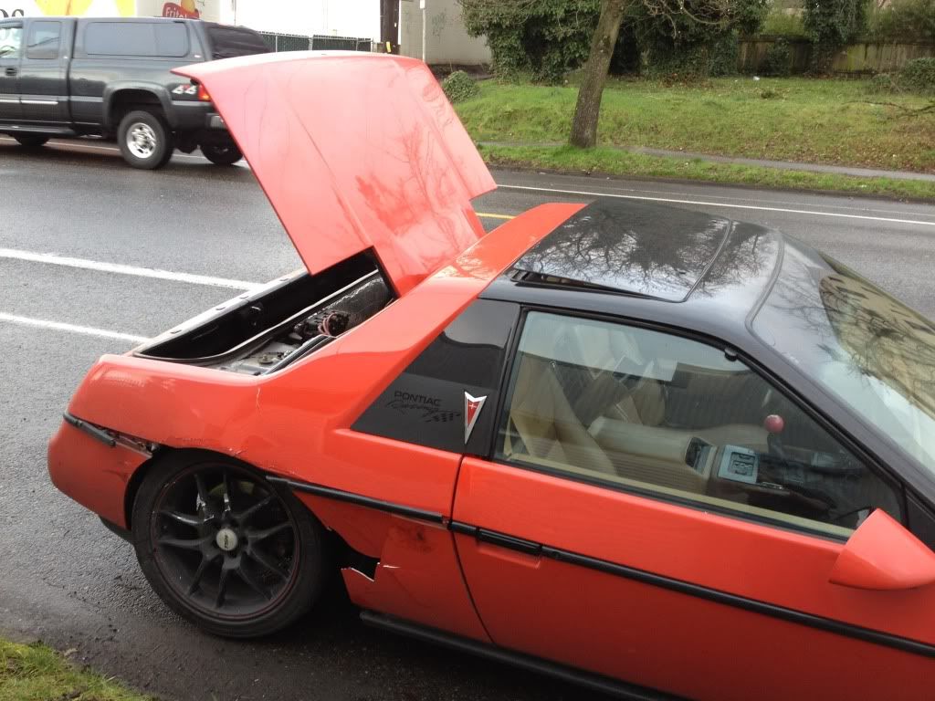

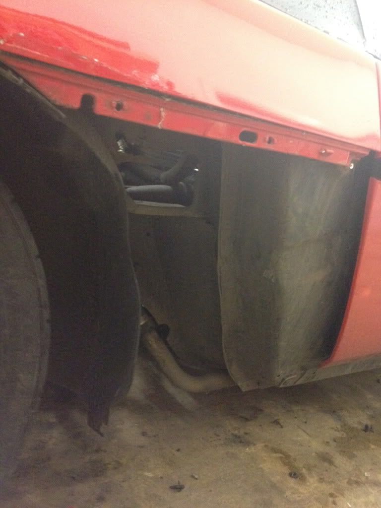

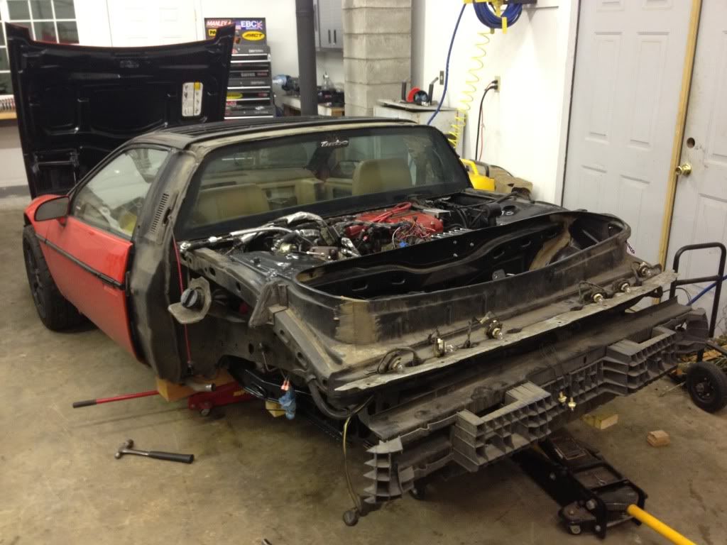

It all started when I was hit in a particularly bad intersection...
I got hit in the rear wheel hub and although it incapacitated the car it saved me from extensive damage. The strut and control arm collapsed but the space frame was undamaged for the most part.
Not pretty, but could be much worse! I carry full coverage and made out pretty well, before long parts started rolling in! First on the agenda is the 88 cradle swap I've been collecting parts for for a while.

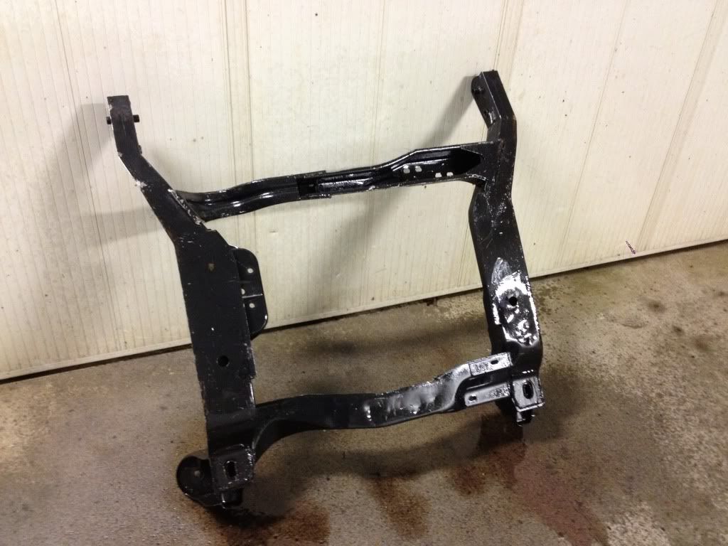

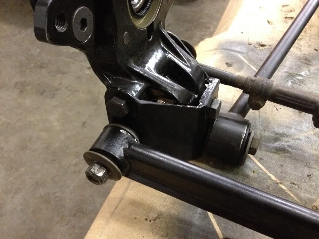

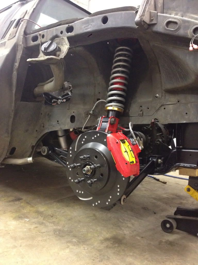

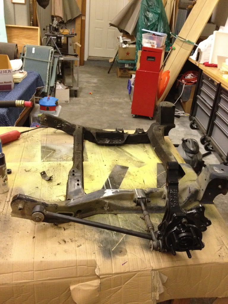

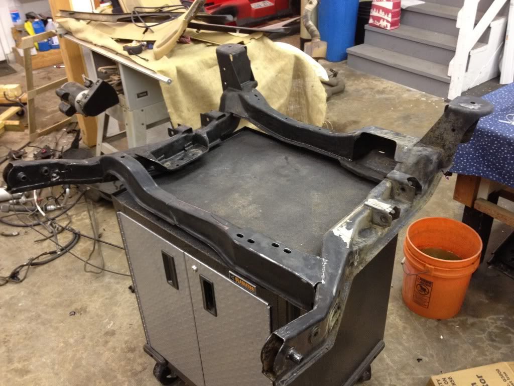

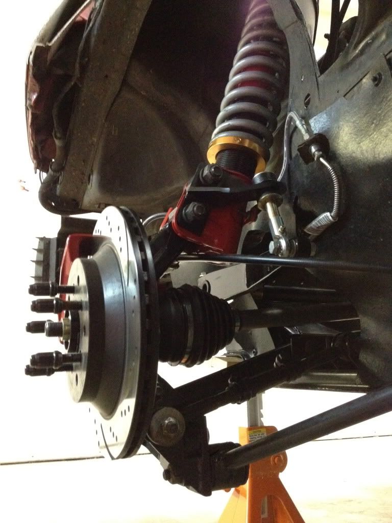

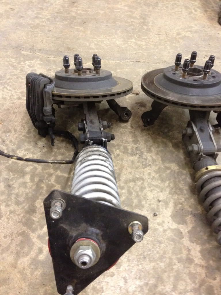

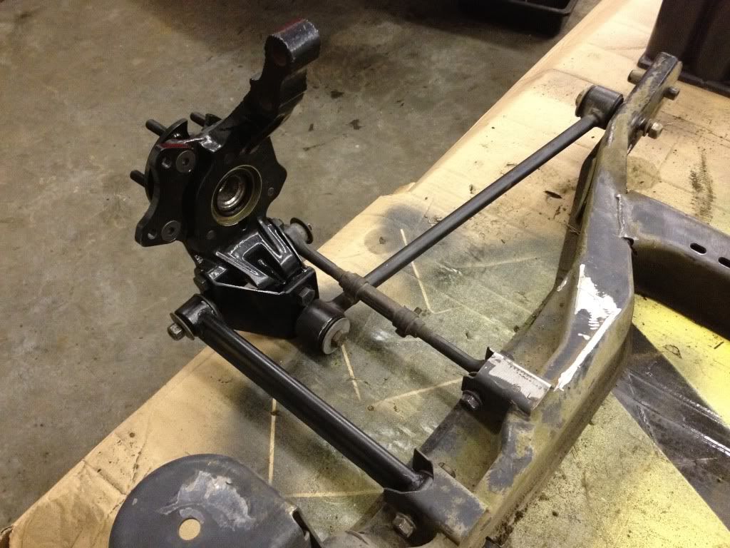

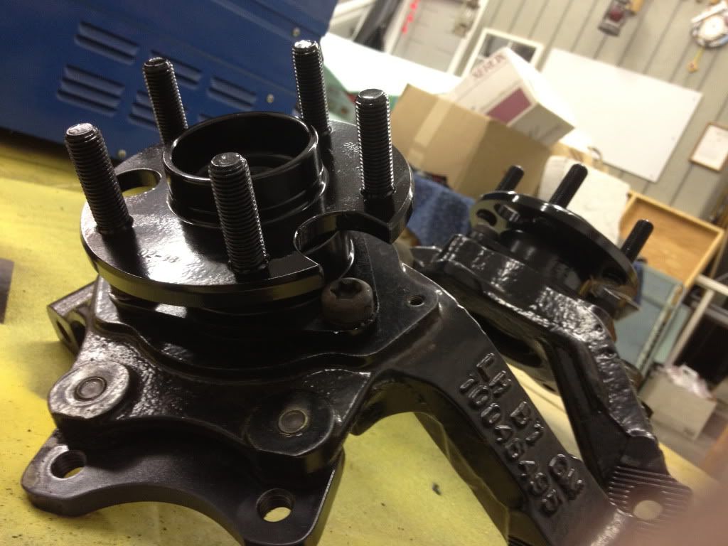

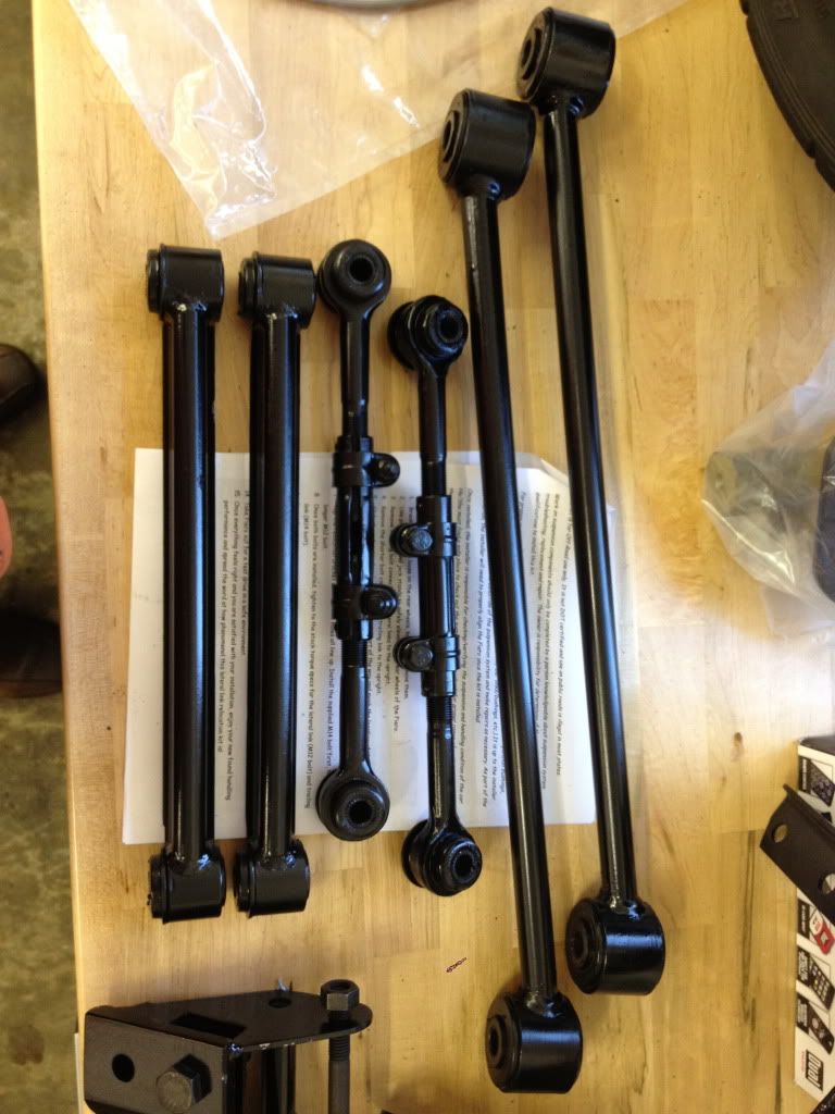

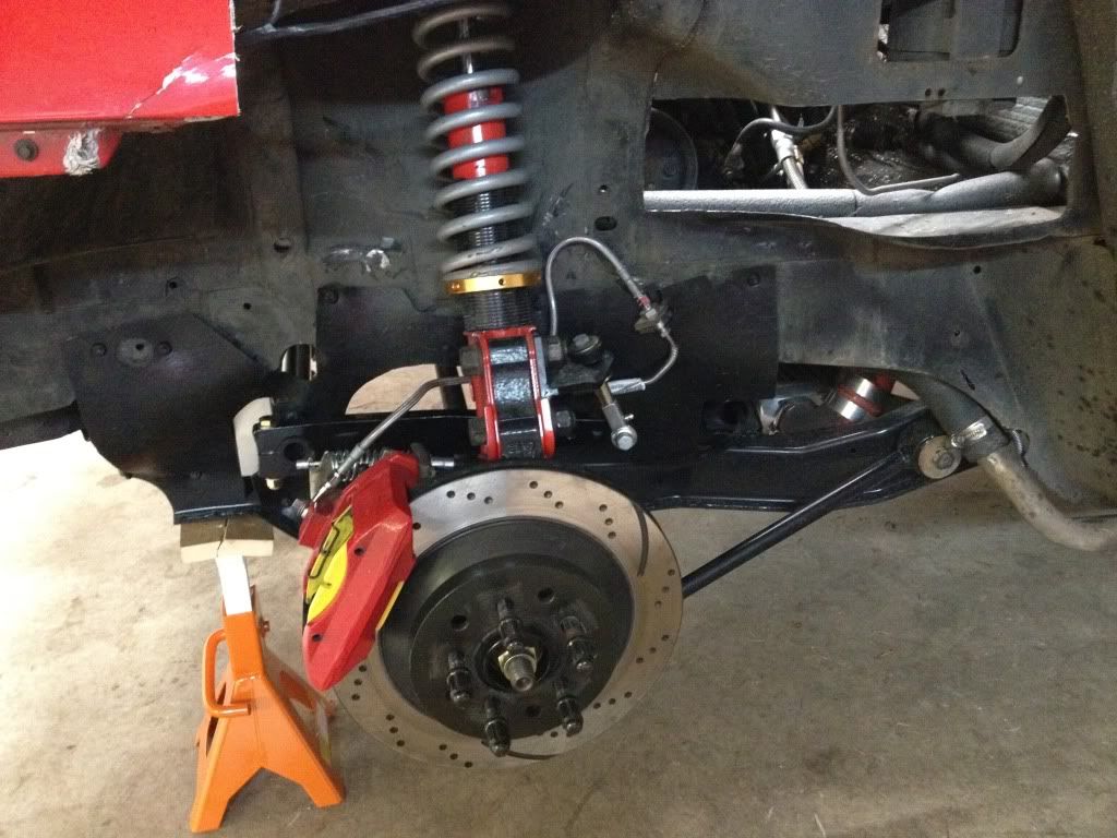

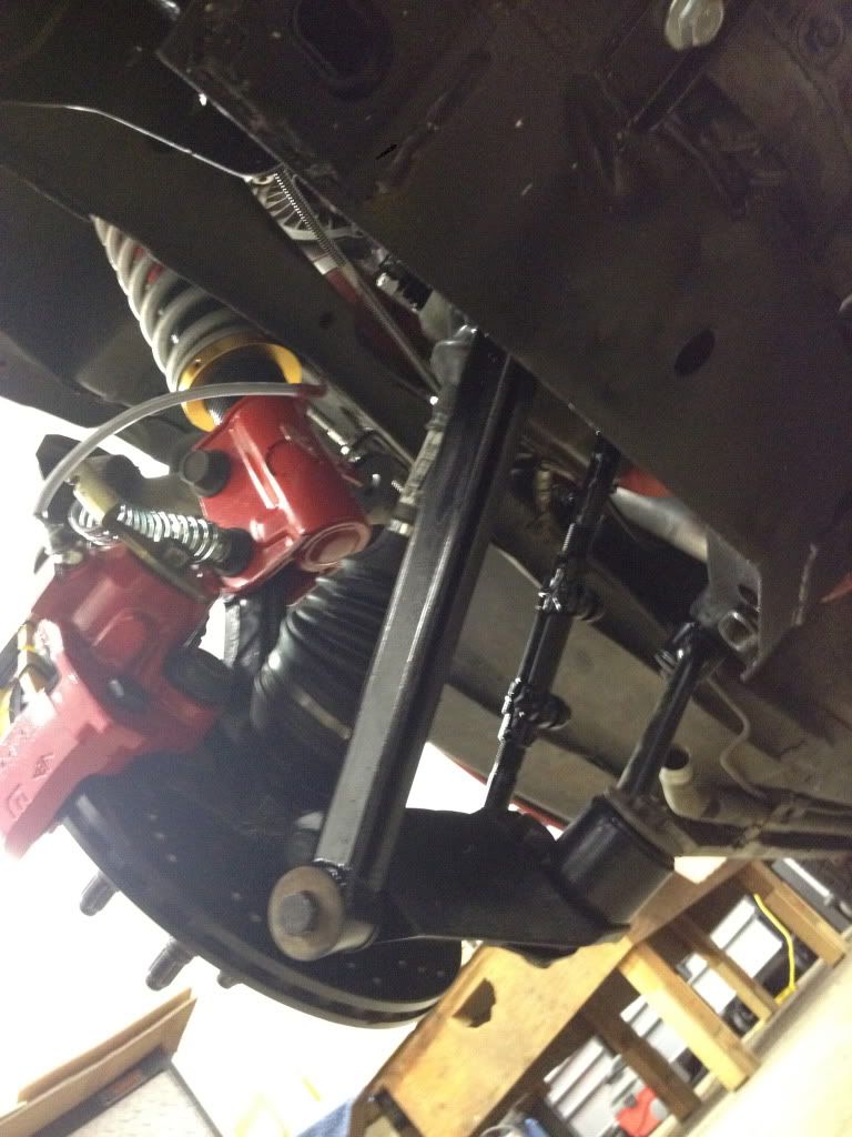

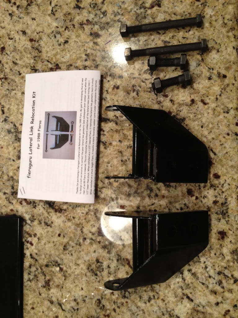

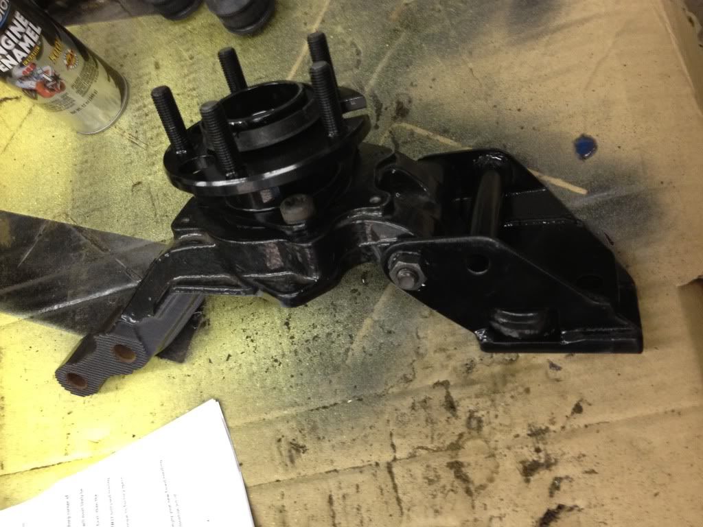

FieroGuru 88 geometry brackets. Great parts and I am very happy with them, I talked him out of his first set.
New rubber bushings in all links

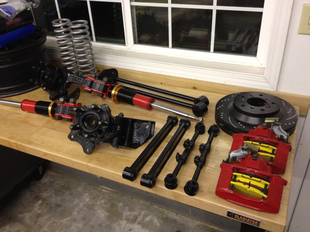

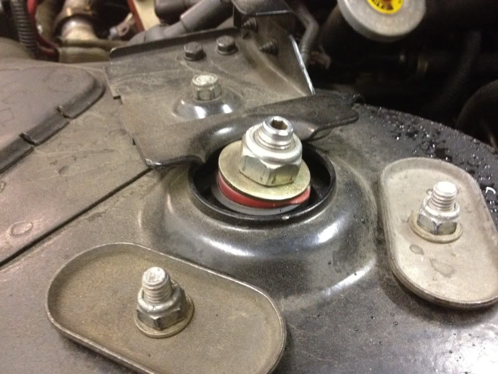

New kony shocks and struts.

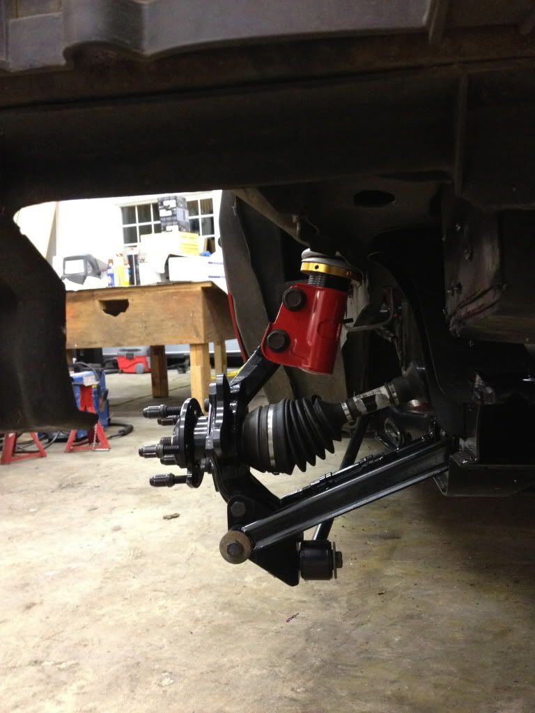

Rear suspension parts ready to go!

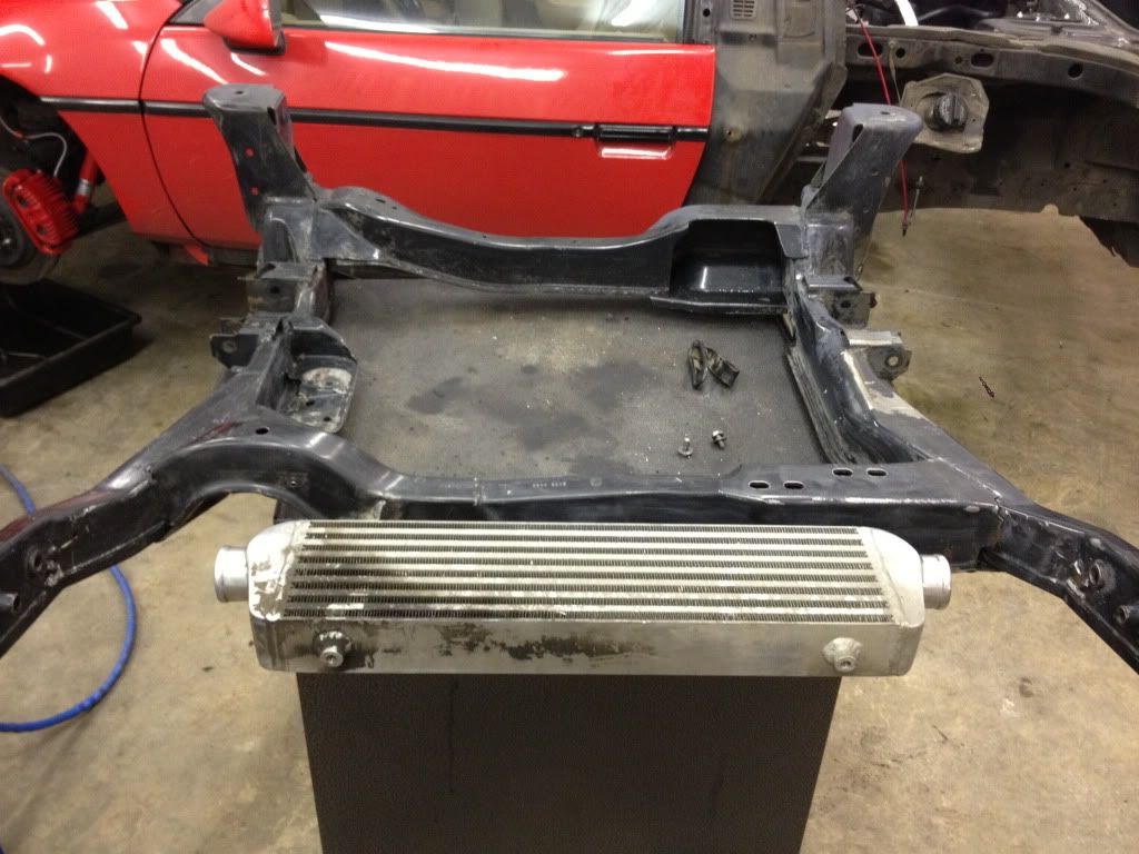

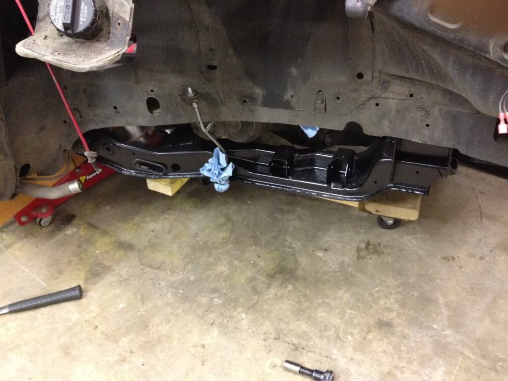

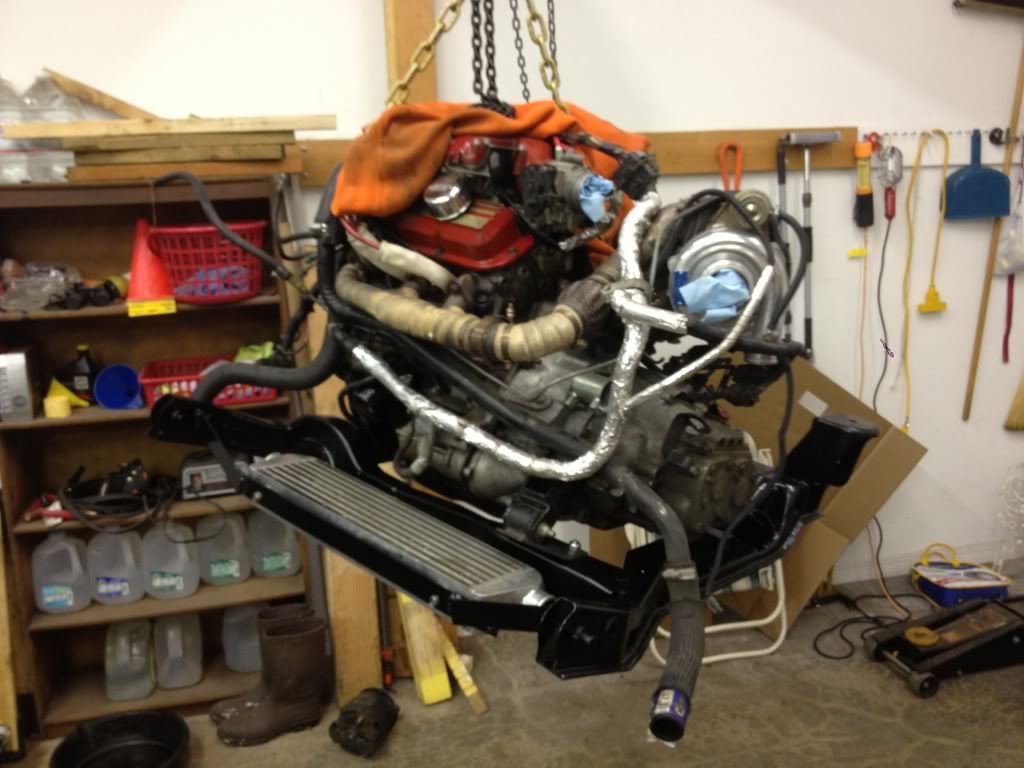

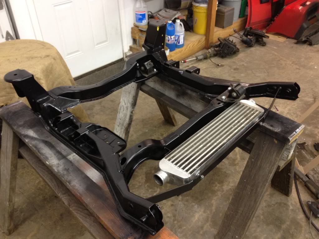

cleaning up the cradle and mounting the intercooler
More in the next post!

With the 88 cradle parts coming together I got started on a few other updates.

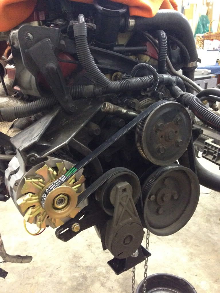

CS alternator, very worthwhile!

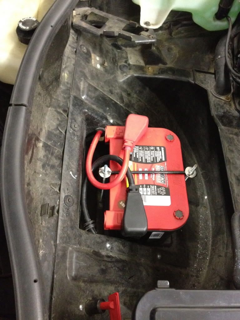

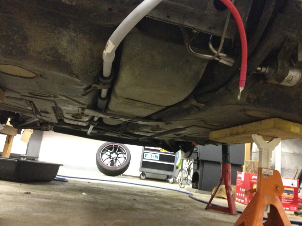

New battery cables

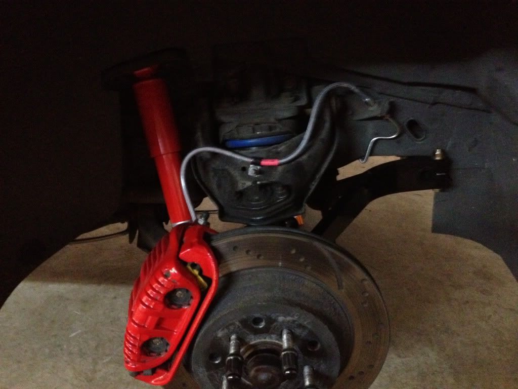

Fiero store stainless steel hard brake lines and braided stainless steel caliper hoses

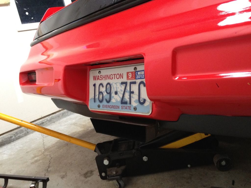

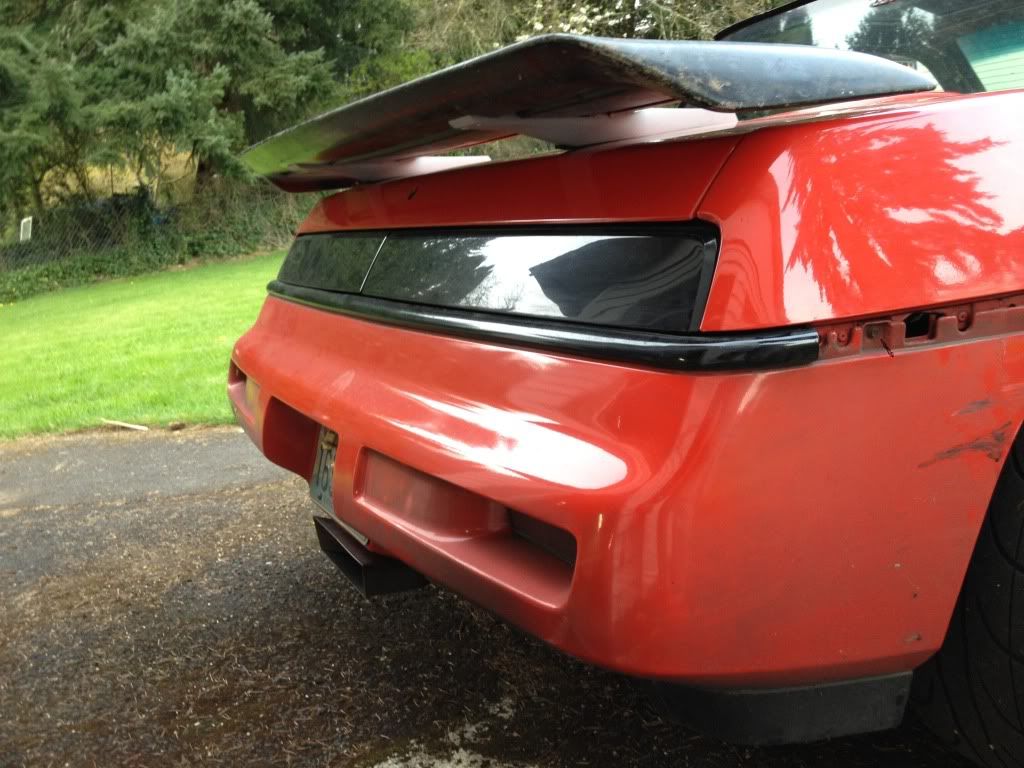

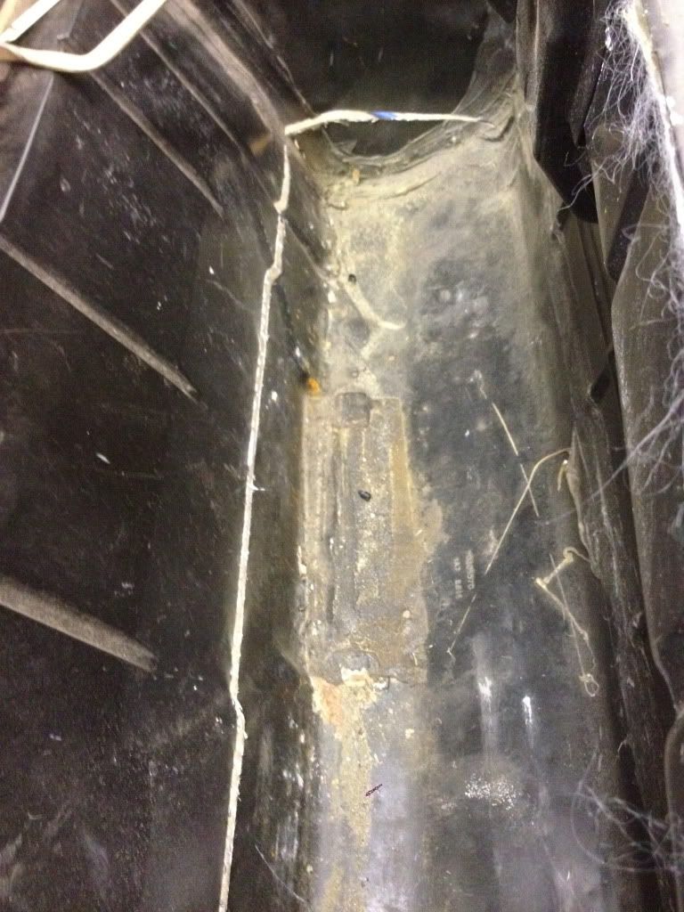

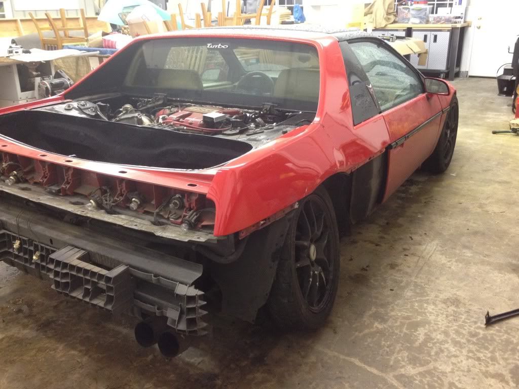

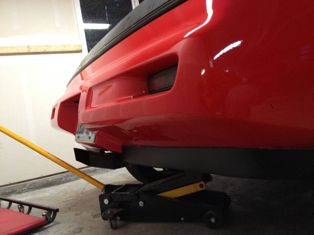

I cut a little out of the bottom of the trunk to make some space for some new exhaust work...

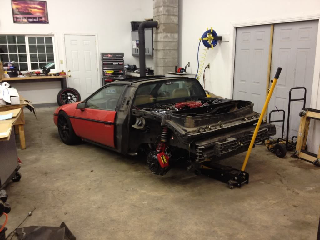

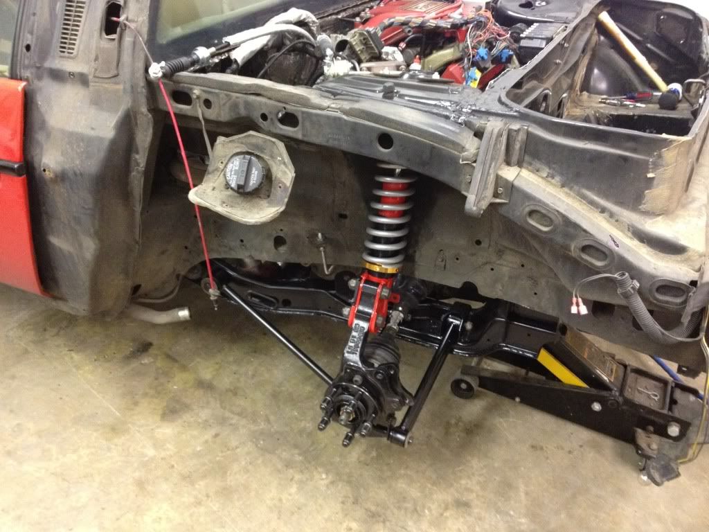

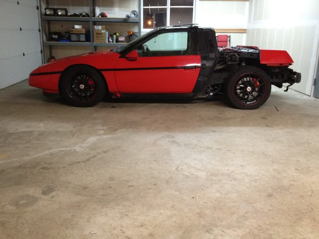

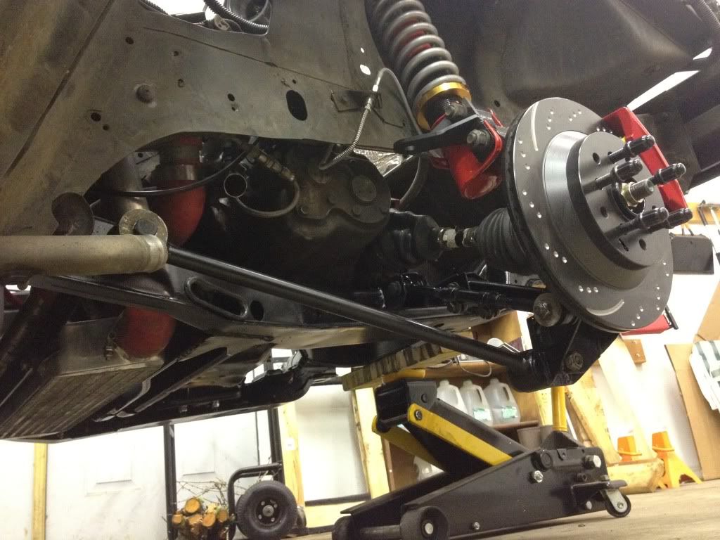

I managed to get the new cradle in without trouble even though I was a little worried about frame damage.
Rear suspension coming together!
First time moving under its own power, on all 4 wheels!
This was my temporary exhaust solution... Don't worry only temporary!

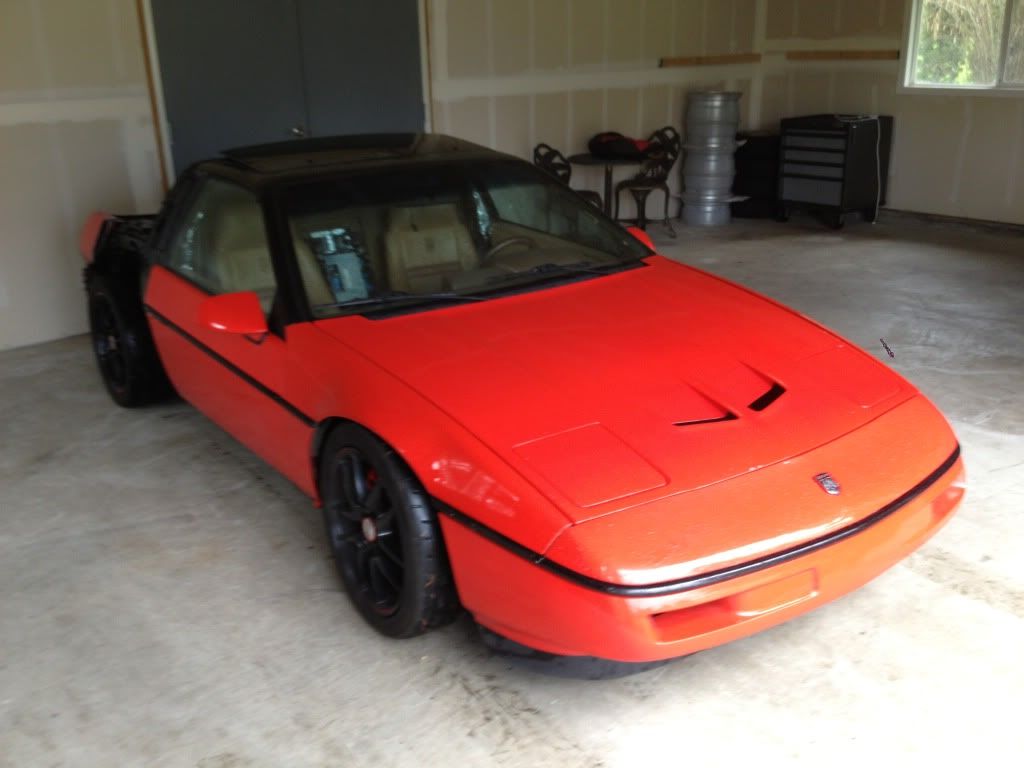

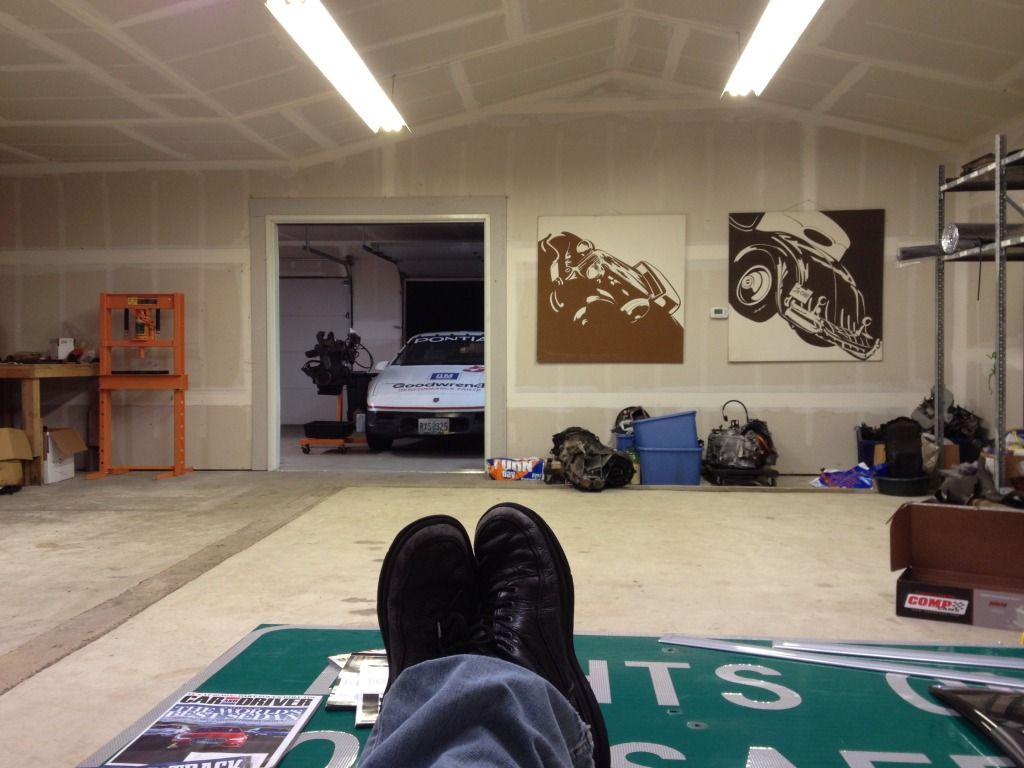

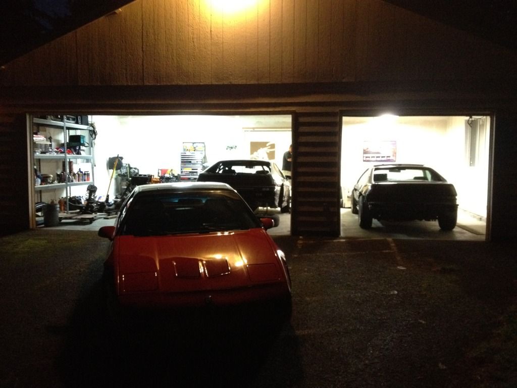

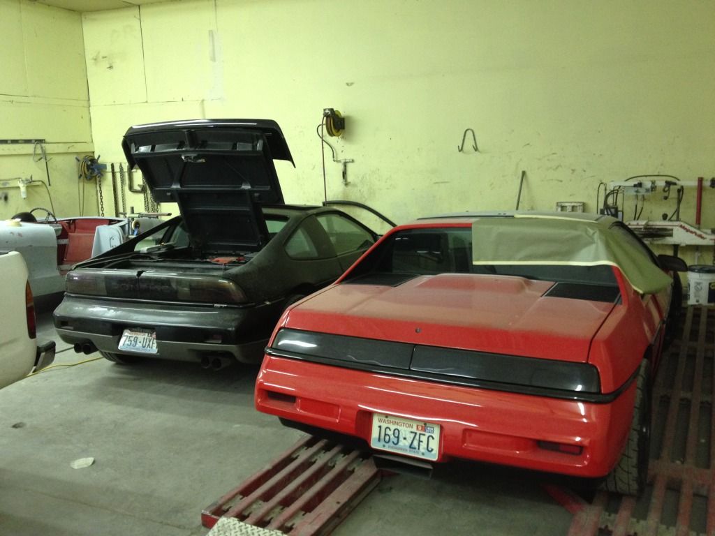

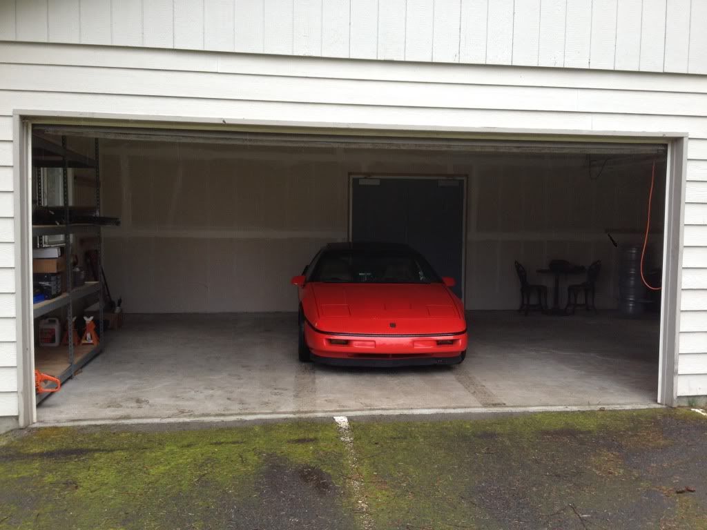

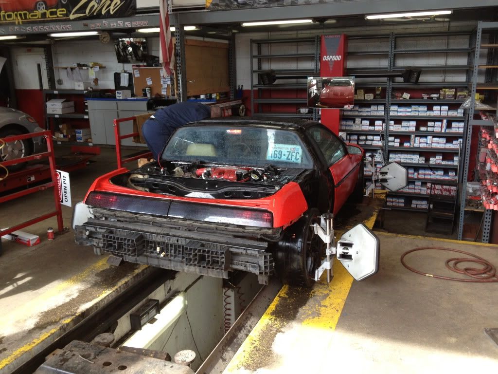

Got the car aligned and and moved into my new shop!!!!

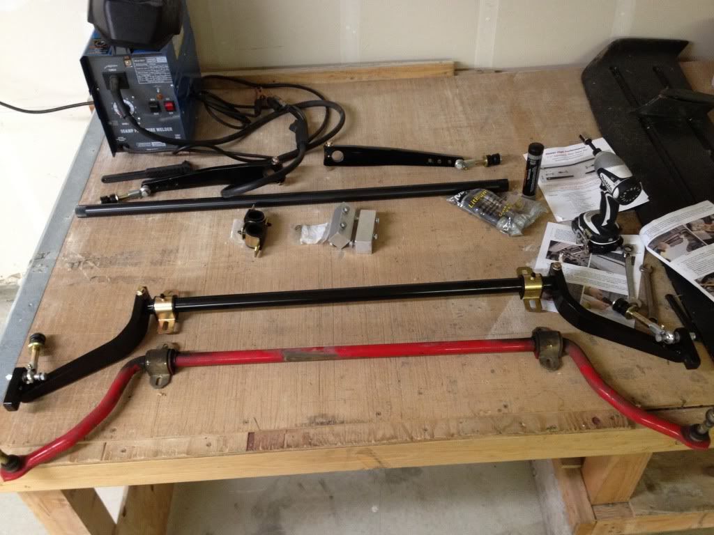

What could these boxes be?

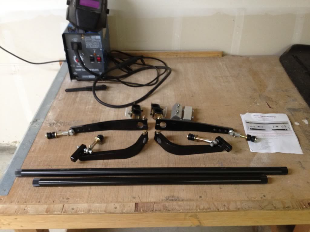

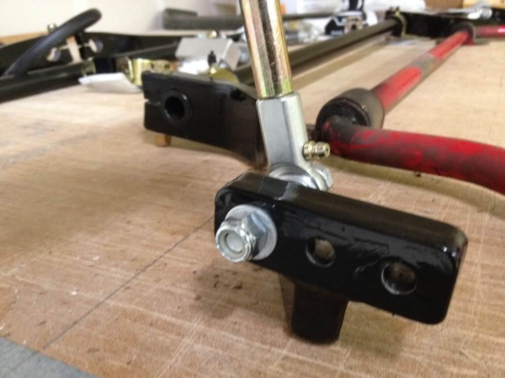

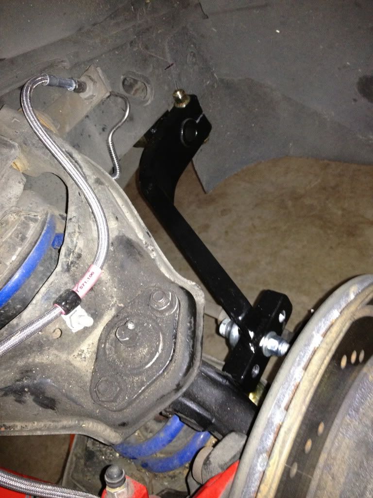

HHP swaybars, pretty excited about them
Installed front and rear, no big issues but they take a little massaging when the car is lowered.

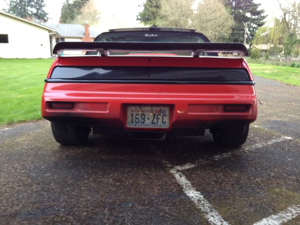

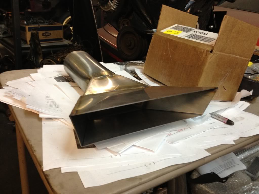

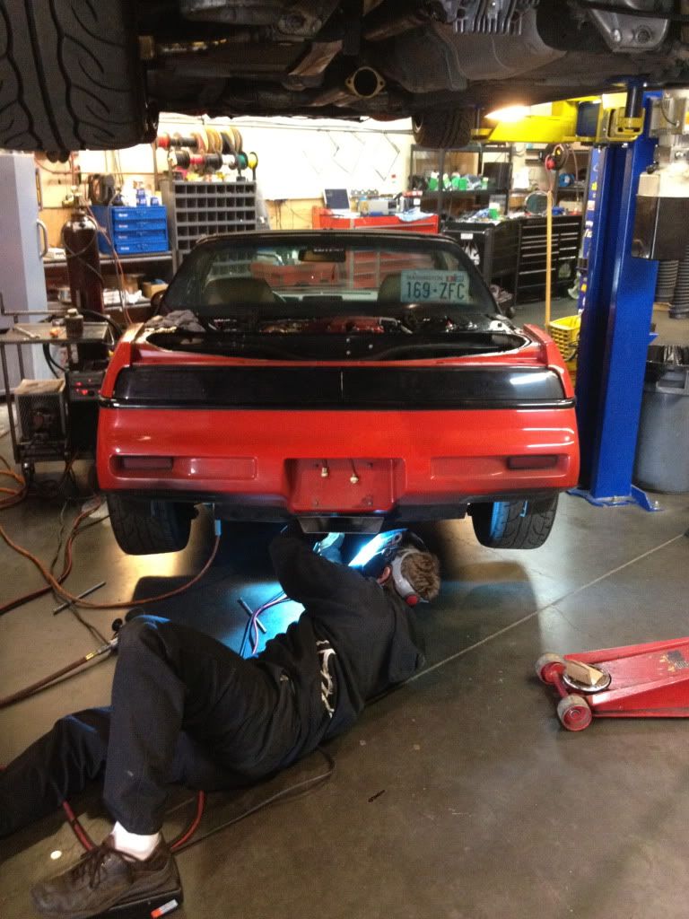

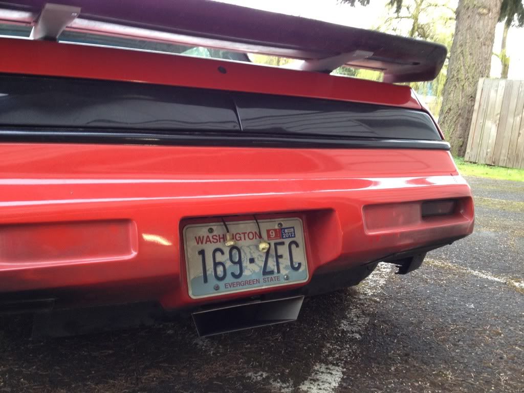

Next off to the exhaust shop to use the space I made with under the trunk...
Custom built exhaust tip

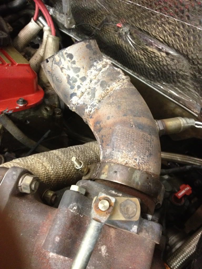

New waste gate and down pipe.
I knew they would nail it and I was not disappointed!

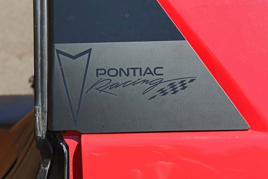

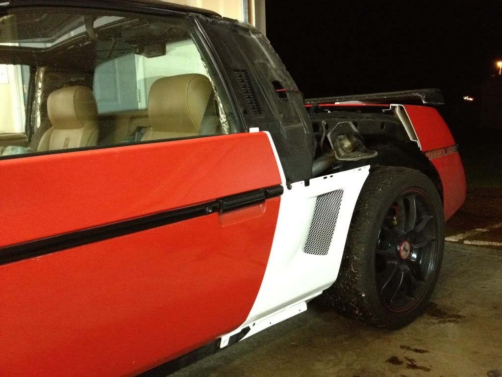

And the last parts to roll in are the IMSA style side scoops.
Ill be getting everything to the body shop and getting the body work rolling and hope to have the car done in a couple months. Very much looking forward for Northwest Fiero Fest this year!

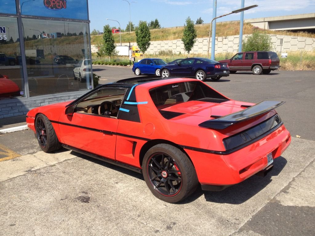

Report this Post05-14-2012 06:22 PM Click Here to See the Profile for thedrueSend a Private Message to thedrueDirect Link to This Post

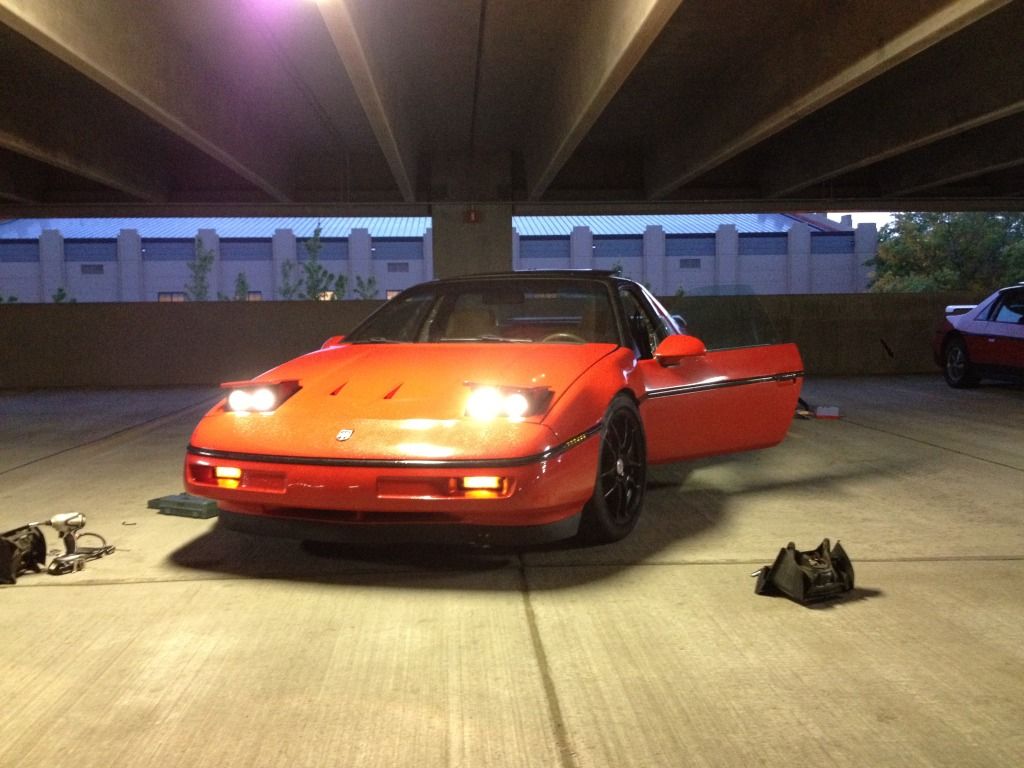

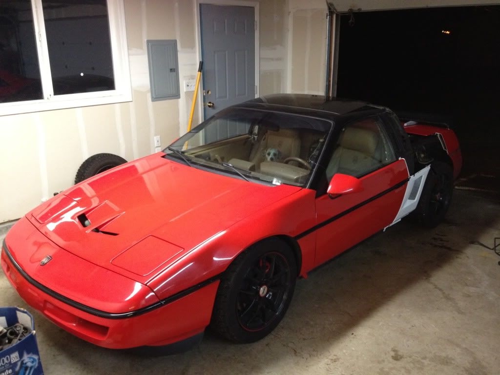

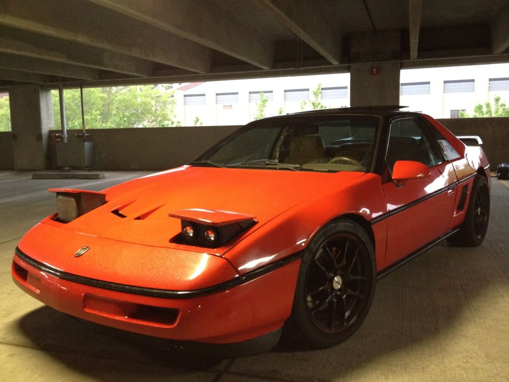

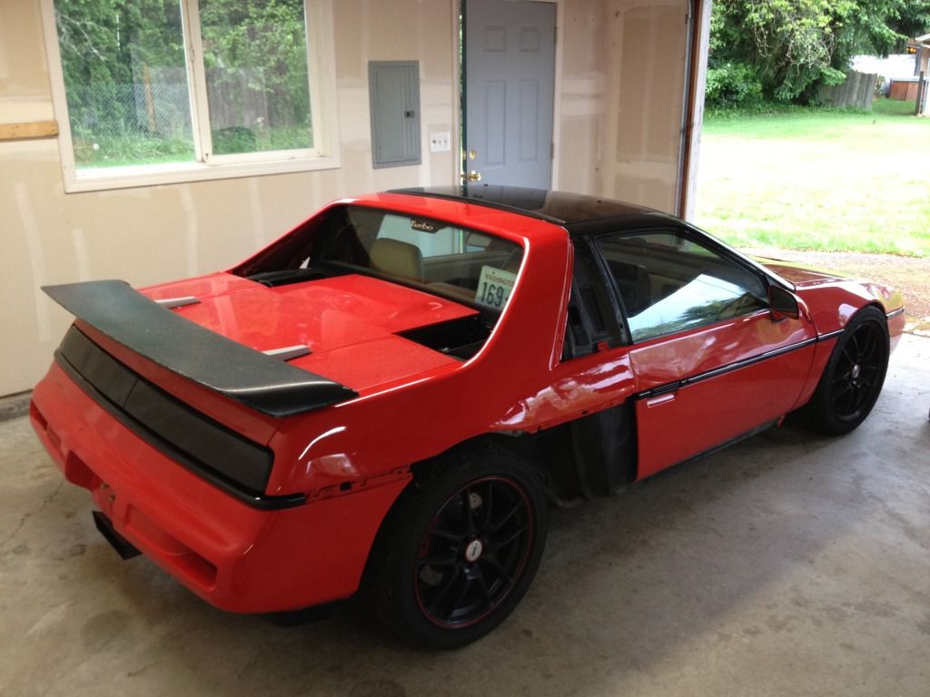

I've been driving the car some and ironing out some kinks. Its a monster! The body work has been slow but I just talked with my painter and he will be finishing up a few mods this week and should be shooting red by the end of the week or early next week. I should have my parts next week and I plan on finally reassembling over memorial day weekend.
Its been a long road but its been worth it and the car is better than ever!

Where did you get those battery cables?
[This message has been edited by Quad Raider (edited 05-15-2012).]
thedrue
Posts: 1104
From: Vancouver, WA USA
Registered: Feb 2009
Report this Post05-15-2012 03:24 PM Click Here to See the Profile for thedrueSend a Private Message to thedrueDirect Link to This Post
THe battery cables are from Summit Racing. They sell several battery relocation kits and thats what I bought. It was not cheap but I am very happy and it came with the professional looking rubber covers and stuff.

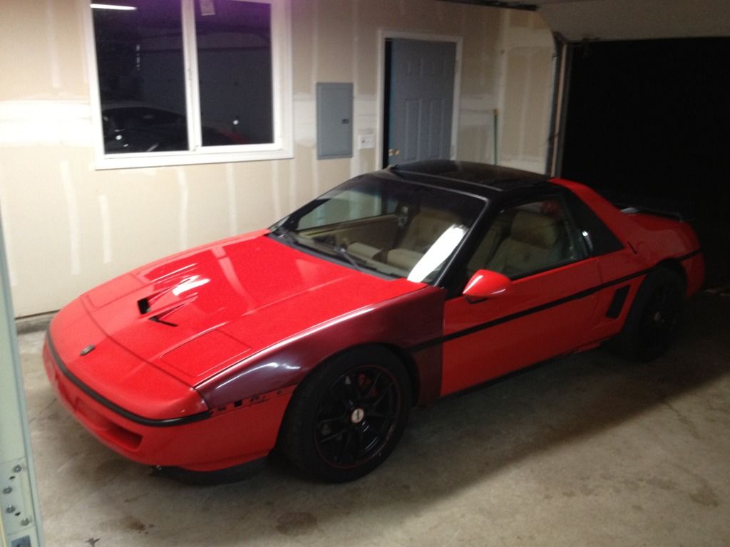

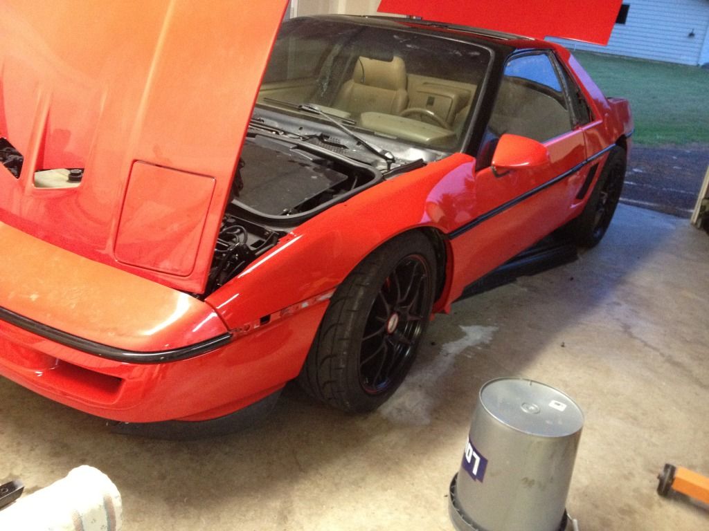

There has been some progress!

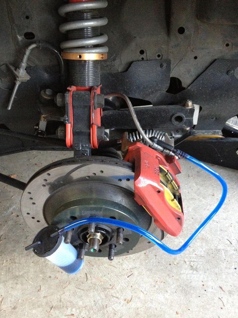

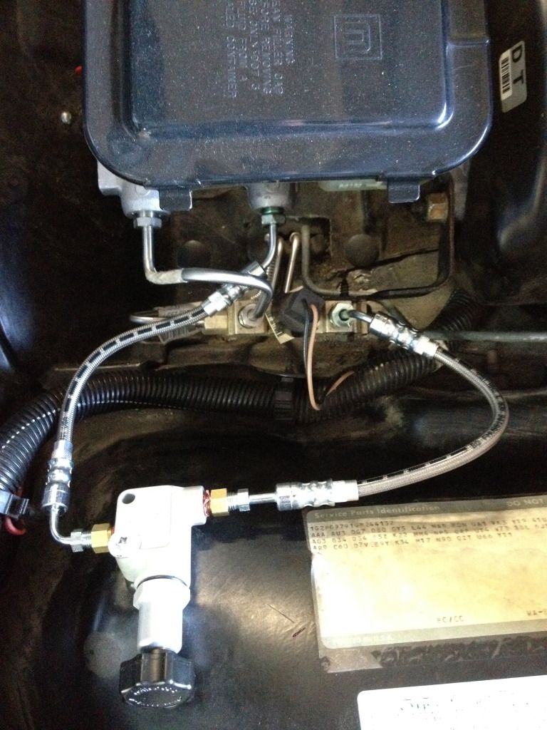

Brake bias valve. I had very bad rear wheel lockup so I turned it down and the car is back to normal.
Speed bleeders for the win.

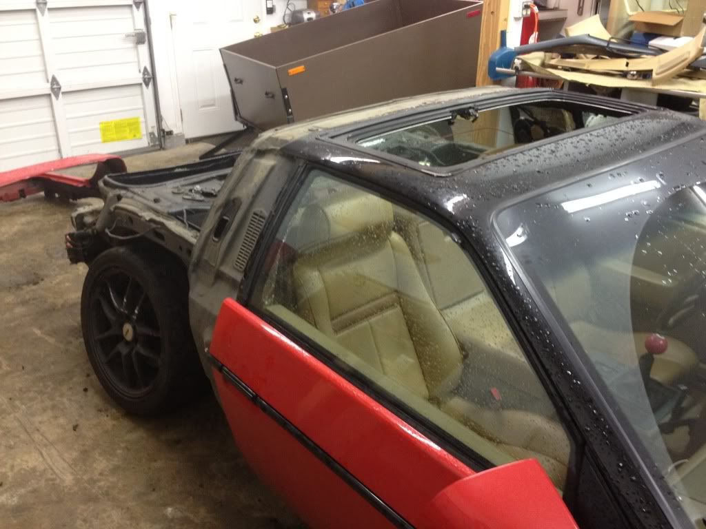

Panels are coming together.
Just installed my sail windows.
I just gotta clean up and install my rocker covers then get the car back so the black top can be fixed and the wing painted. Then the exterior will be done, just gotta finish up some things inside and the car will be back together!

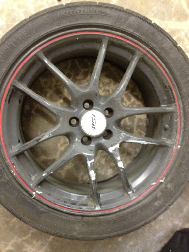

The wheels are TSW trackstar 5's 17 inch diameter 8 inches wide. 35 mm offset I believe. I did have the fronts milled down another 3 mm to make the fronts 38 mm offset. I was having some rubbing issues at my desired ride height since the brake rotors spaced them out.

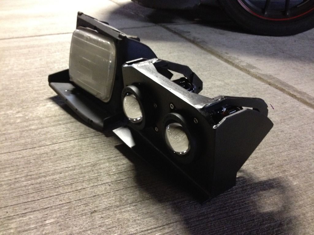

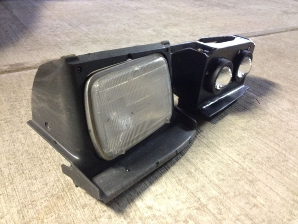

I travelled down to Corvallis a couple months ago to pick up my new Projector retrofit headlights. I like the popups but wanted better performance and a little meaner look. The low profiles are just what I wanted.
These are great products and really update the looks and performance of the Fiero headlights.

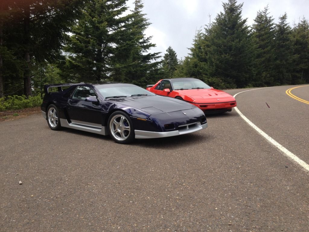

The next day I went on a great drive with my friends Alan(PPE) and Justin.
Lets just say the day was stellar, great cars, great people, and great roads. Unfortunately on the way down a stray patch of gravel ruined everything...
It was my fault as I overdrove the road a bit, we had been enjoying ourselves all day at the top of the road, no gravel cause its snowed in during the winter. But as we ascended the traction sand appeared out of nowhere, I was not pushing very hard but was definitely feeling the car out. It is the first tim Ive really been able to try out all the new parts... Long story I landed in the ditch, but I was ok and to be honest the car faired very well!
Some nice people winched me out with a jeep and I used my roadside assistance to get a tow back into town. One of our friends lent us the use of his shop and after a quick trip to Portland to raid my spare parts stash we has the steering rack changed with new tie rods and a new knuckle installed, even threw on a spare fender. I drove the car home less than 24 hours after the accident. I inspected everything and other than the body panel damage and an alignment the car is good as new!
just before leaving corvallis
safe and sound back in my shop
After dealing with a mad wife and getting some money together I took the car back to my painters and he took care of the red at the same time as he painted my wing and fixed the black top.
Tonight I reinstalled the newly red fender and cleaned a couple things up. I am determined to not work on this car any longer! Just finish putting it together and cleaning it up for the Fest and then driving it and smiling the whole time.
Whew, the last few months have just gotten more and more crazy!
Time to sit on my couch and relax
You can see Team Pontiaxed car in my shop getting an engine transplant.
Also a quick teaser showing off what my wife will be adorned with at Fiero Fest this year...

I want to see the pics of the car freshly painted all up matching!!! I love what you have done with it.

The car is almost done!!!!!
Since one of my sail windows blew off I had to remake a new set. This time I took it to a pro to glue on, I was not going to screw it up again.
With all the panels painted I installed the spoiler and installed the sunroof seal and a few odds and ends.
The car will be ready for Fiero Fest, I am also in the process of building a very nice GT for someone that will be there as well. The paint work is happening now, then after the Fest the car is getting a fresh 3400 and 4 speed auto transmission.

Ive been watching your build Josef! Looks great, the car is turning out very well and I am a big fan of the place roof panel.

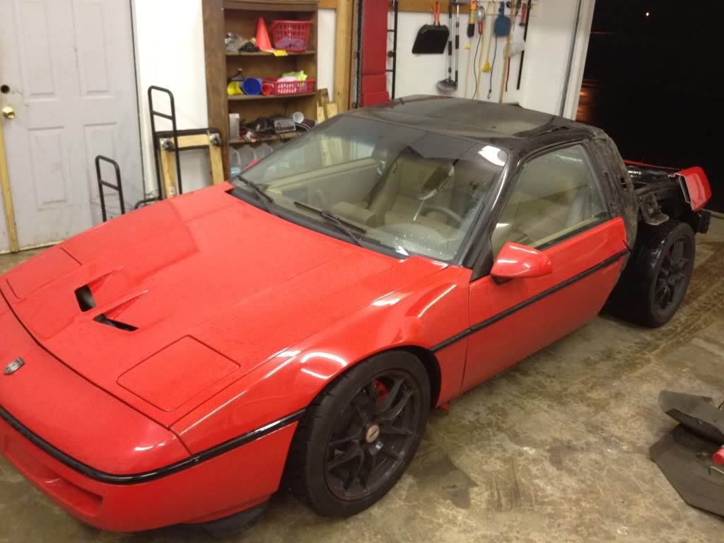

I reinstalled the headliner as well as A and B piller panels. It really makes a difference to have the interior installed. Just have a few odds and ends to do tomorrow and I am calling the car officially done and ready for Fiero Fest.
My lovely wife bought me a 2 hour detail session that I will redeem the week of the fest since Ill be very busy until then finishing up another car that will be at the fest as well as doing some vacationing.
