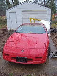

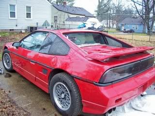

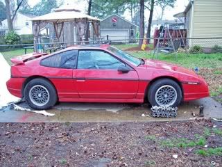

Since giving away the 85, and rewarded with seeing the new owner get it into terrific shape so quickly, I have been thinking of the 86 GT I have in the garage. I really miss driving a Fiero, and although this one is good shape it has the dreaded rod knock. That means a new engine block at the very least.
So what's my smartest first move? I will end up customizing this one like the last, where do I start so I get the maximum return my efforts? Rebuild the 2.8, go for a 3.4 conversion, find a replacement cradle and install a 3800/4.9 motor on it to swap?
Keep in mind this is just a preliminary list - I'm doing other things to facilitate this project.
