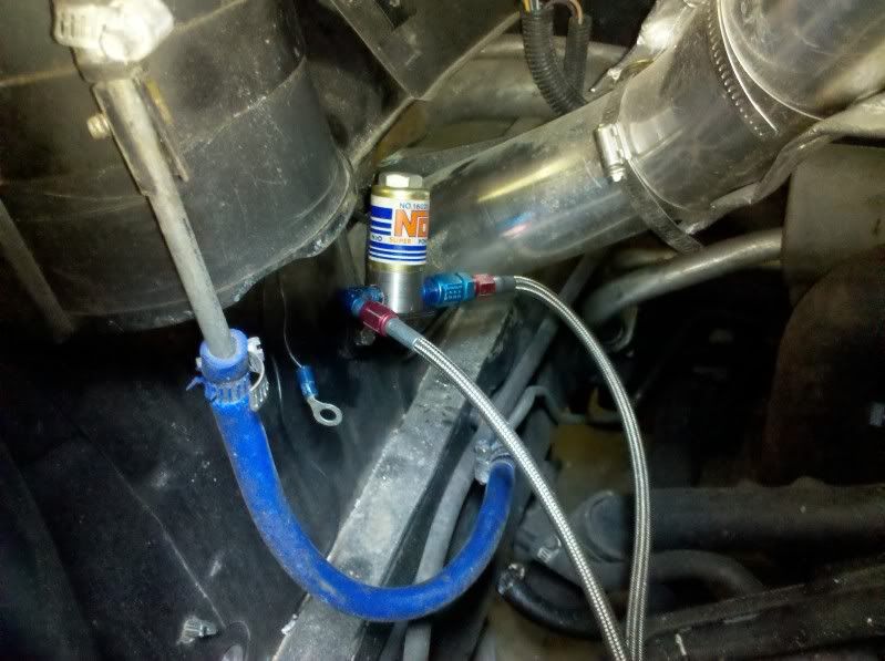

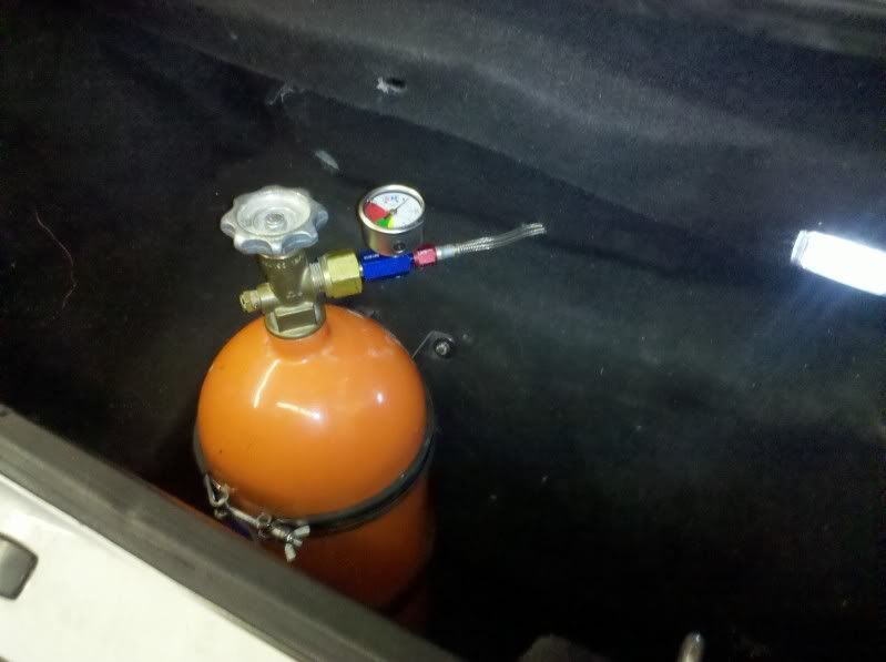

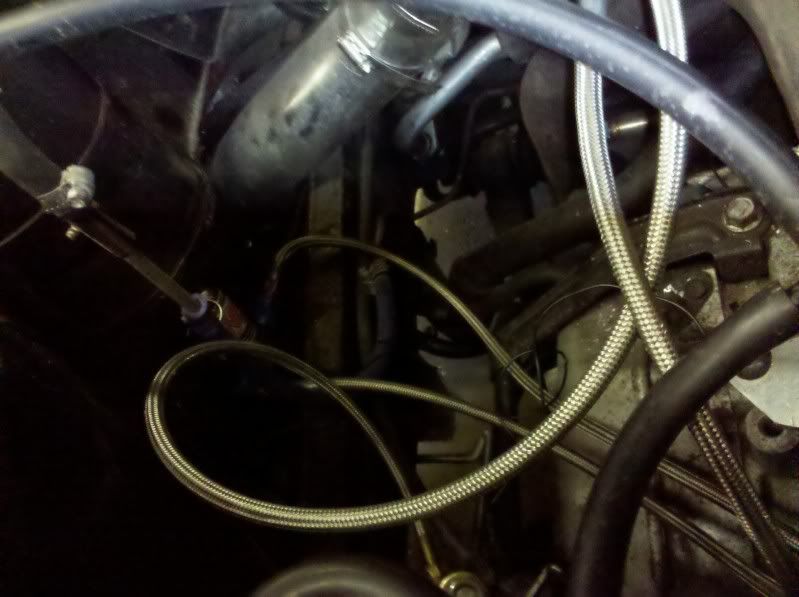

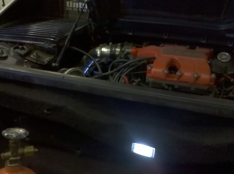

Report this Post02-26-2011 06:59 PM Click Here to See the Profile for OsloClick Here to visit Oslo's HomePageSend a Private Message to OsloDirect Link to This Post
Bottle Blanket & NX Gauge:
NOS solenoids:
NX Shark Nozzle:
Later next week I will tap into the fuel somewhere and install the electronics.

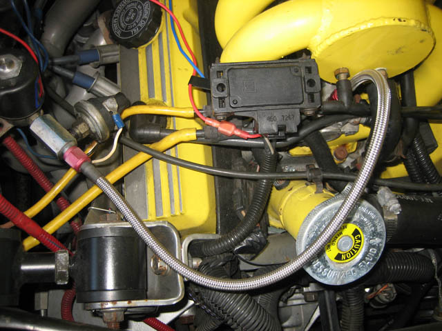

Report this Post02-27-2011 09:05 PM Click Here to See the Profile for Alex4mulaSend a Private Message to Alex4mulaDirect Link to This Post
Make sure you add a fuel cutoff switch. Remove the shrader valve and you can just connect there. The best is to use an electronic TPS switch. I got one from Dynotune. Oh and the most important is to get a bottle heater. Specially where you are. Not sure if that blanket heats too. Otherwise your shot will be like a 2hp one
My install : https://www.fiero.nl/forum/Forum1/HTML/083642.html

Report this Post02-27-2011 11:28 PM Click Here to See the Profile for ryan.hessSend a Private Message to ryan.hessDirect Link to This Post
Originally posted by Oslo:
NOS solenoids:
You'll want to change out those worm clamps for hose clamps that are rated for fuel injection use. Otherwise you're risking a fuel leak. There are no "teeth" to cut and dig into the hose:
Unless I'm mistaken, those worm clamps are on a vacuum hose. He's using steel braided hose with AN fittings for the nitrous and fuel plumbing.

Report this Post03-15-2011 01:34 AM Click Here to See the Profile for OsloClick Here to visit Oslo's HomePageSend a Private Message to OsloDirect Link to This Post
Yep, just a vacuum hose.

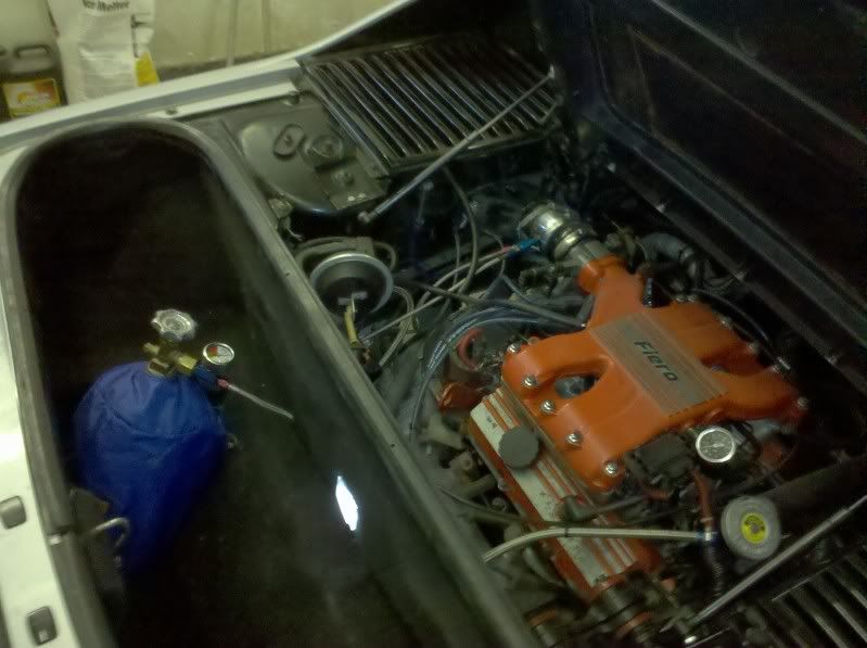

Report this Post03-19-2011 10:43 PM Click Here to See the Profile for OsloClick Here to visit Oslo's HomePageSend a Private Message to OsloDirect Link to This Post
Here's the results of my dyno day!
We went to "Red Line Dyno" in Salol, MN today and used a Dyno Jet for testing and tuning.
The car: 1985 Pontiac Fiero, 3.4L PR Engine, Automatic 4-speed Transmission
I was hoping for an increase of 40 - 50hp with nitrous, and we got it!
I used a NOS brand bottle and solenoids and the NX Shark nozzle fogger.
Nitrous jets: Fuel: .020; Nitrous: .036
Without Nitrous: 113hp, 151tq
With Nitrous: 155hp, 207tq
What mods does the 3.4 has or was it just a stock swap? Those 56lbs of torque is what you really feel I ran 41 nitrous 20 fuel when I sprayed the 2.8. Your AFR looks on the safe side.

Report this Post03-20-2011 10:54 PM Click Here to See the Profile for OsloClick Here to visit Oslo's HomePageSend a Private Message to OsloDirect Link to This Post
I wish it was a stock swap based on the low power readings... The engine is stock other than a "260" Comp Cams camshaft from the Fiero Store.

Report this Post03-21-2011 11:59 AM Click Here to See the Profile for JonesySend a Private Message to JonesyDirect Link to This Post
your 3.4 only had 113hp stock? That seems kinda low..
Synthesis
Posts: 12207
From: Jordan, MN
Feedback score:    (19)
Total ratings: 294
Report this Post03-21-2011 12:06 PM Click Here to See the Profile for SynthesisSend a Private Message to SynthesisDirect Link to This Post
I am thinking that as well..
Considering the 2.8 was 140 stock (at the crank), and the stock 95 3.4 was 160 at the crank...
I understand with higher RPMs running out of breath due to the restrictive intake, but why are the initial numbers so low?
Are you really losing that much horsepower through the drivetrain? Automatic transmission I assume?
Otherwise, very informative thread! Not putting anything down, just curious as to the low readings.
