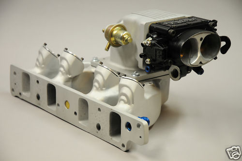

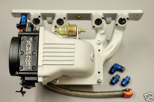

I saw a SD4 intake for sale on ebay. Guess it sold , but would like a pic of it if anybody has one. It had a bung for each runner, a 90* fitting on the 4 barrel opening and a v8 2 barrel TB (LT1?). I'm wandering where the 90* fitting and the bungs came from , how the bungs were attached.

Seen it. It looks like a modified Edelbrock 4bbl intake
Edelbrock 4bbl Manifold http://cgi.ebay.com/ebaymot...fPartsQ5fAccessories

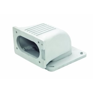

... with a 90 degree TB adapter - Accel PN 74882 (no longer available)
Listed at Amazon http://www.amazon.com/Accel...dapter/dp/B001VAT5LI
I had bid $450 on it over a year ago, but ultimately decided not to bother. It's unlikely to ever sell because he wants too much for it (minimum $900 at the time) AND doesn't want to include the small bits and pieces for the fuel injection. Also, on closer examination, I didn't think the throttle mechanism would fit in the engine bay without some modification to the trunk wall to provide clearance for throttle bracket, cable and return springs.
