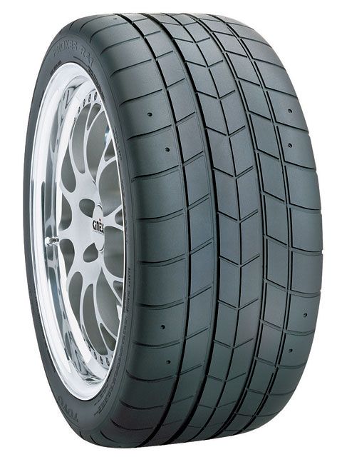

I want serious performance tires on my 85 GT 3.4 PR, but I don't want to upgrade from my stock 14" wheels yet. What are my options for tires? Once it warms up and all of this cold white junk is gone for good, I want to replace my severely damaged tires. I keep looking at Toyo's Proxes tires, namely the R888 and the RA-1. These both seem like VERY nice performance tires, but are they even a little practical for my main and only vehicle? My main concern is longevity. I can live with replacing these once a year, but only 5000 miles of street life is unacceptable. My second concern is, can I even get the full benefit of these tires without driving like a complete psycho? I'm looking to have a little more fun with my car, not kill myself and others trying to warm up some stupid tires. These would see almost all of their abuse on curvy back country roads, with as little traffic as possible.
To simplify, I know little to nothing about this level of tire, and I want someone more knowledgeable to teach me. I understand UTQG ratings, and the basics about tire sizing. I just don't quite get the concept of heat cycles, or know how many street miles an R compound tire can offer. If you have a feasible street tire alternative, that doesn't compromise performance for something silly like quietness or ride comfort, please tell me! Or, if you have good input on the R888 or RA-1, please feel free to share.
This is the R888,
Info here, http://toyotires.com/tire/pattern/proxes-r888
and this is the RA1
with info here http://toyotires.com/tire/pattern/proxes-ra1
Thanks!
Edit to add, these don't look too bad either, and they might be more practical. Direzza Sport Z1 Star Spec
Info here, http://www.tirerack.com/tir...10398365&PID=1873911

I personally think that you're going a bit overkill by using an R Compound tire. Since R Compounds are DOT approved, they're typically used in racing applications that require a street tire (SCCA auto-x or weekend series that constitute a DOT legal tire would for instance be ideal for R Compounds, since they provide the best possible grip from a DOT tire). However, you are correct that they will see accelerated tire wear. The problem then also is you have to understand that all tires in rotation generate heat. While you will indeed see lesser wear by going "easy" on them, they're still designed to generate heat for their maximum grip and tire usage (i.e., they'll do their job when you don't necessarily want them to). Additionally, they have just enough "tread" on them to be DOT legal, so you will see a degree of traction loss in unfavorable conditions.
What I would personally do is if you are really wanting to use an R Compound is to locate another set of wheels to have them mounted to. I think driving around with them year round will eventually prove to be problematic. With another set of wheels, you can roll around on Z rated compounds for the majority of the year, then if you desire on a weekend drive to turn it up a notch switch to the R Compound wheels.

I ran Dunlop Super Sport R compounds on a WRX for 4 summers and they weren't worn enough to consider them worn out. I drove 50 miles daily, and in the rain. Once had to drive on solid ice after a early season car show. They actually performed quite well. I definitely recommend those, or something similar if they no longer make them (those Direzza Sport Z1 Star Spec's you posted look awfully similar). Not having a ridiculous alignment will definitely give you a good life. My L67 Fiero I ran Pole Position S03's and they only lasted about 1.25 summers due to my high negative camber. They wore right down to the belts on the inside edge. In conclusion, if you're driving summer only and don't mind not getting 30-50K out of the tires and want that extra edge, I'd say go for it, so long as they are DOT rated. Just take it easy in heavy rain till you get used to how they could possibly react. The more tread they have the less you have to worry.

Not sure about the R compound tires. Id be inclined to stay away on a daily driver. That being said I just installed the star specs on my car and love them! They are super sticky and seem to handle the rain with ease.
Not sure how well they will wear yet but I hope to get a couple good years out of them.

In the past I was able to work with Goodyear and BFG on many of their Show Room Stock race tires. Even today I have a set of soft Comps on my Fiero.
Having worked with tires similar to this I would not waste my money on them.
They are not for daily driving. You will wear them out fast and in wet traction they will be marginal at best. You also will not ever really get to their limits on the road and if you do you really should not be doing it there. Once you go off road things get ugly fast if you are on that high of a limit.
If this was a second car just used for fun on the weekends and you autocross it or take it for track time they would be fine. But race tires and brakes are two mistakes people make and soon regret their use.
I still work in the performance aftermarket and still get people who put racing pads on their street cars and then complain that the ate up their rotors. Same on the tires not lasting. These parts were made to be used up in one afternoon and then tossed away.
Do yourself a favore and just get a get top of the line street performace tires and they will do you a fine job and last you a good longe time rain or shine.
Just because it is race does not always make it the best choice in all applications. When buying performance parts overkill makes a lot of people unhappy and broke I see it everyday. Buy the best and right part for the job. When buying performance the trick is to buy smart.
