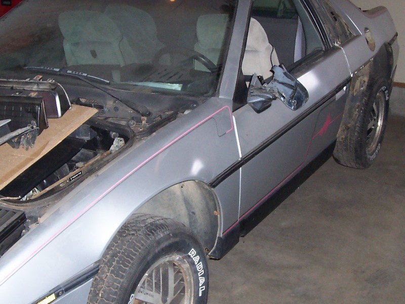

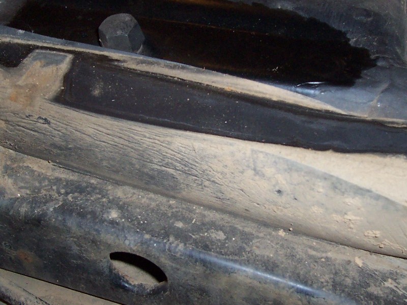

A few pics of my project. First things first Im pulling rockers checking for rust.
So far looking pretty good just a little surface rust.

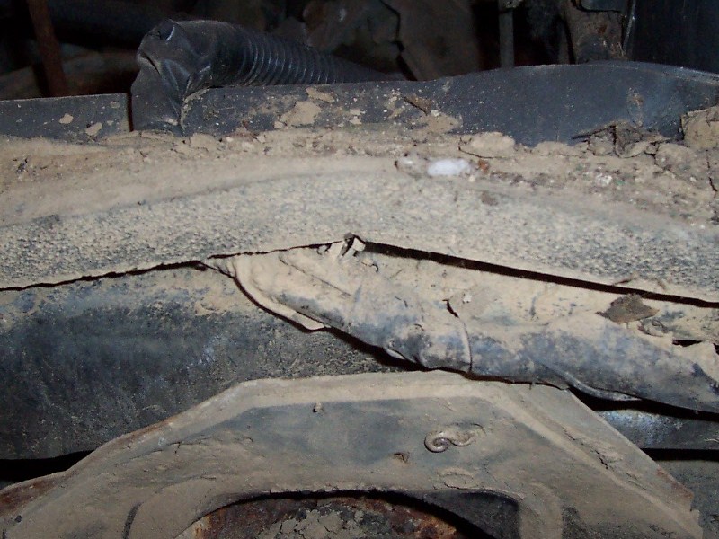

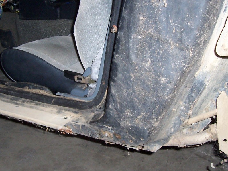

I got both rockers exposed now, no real rust just a few surface pits. Thats alot more then I can say for this throttle body.
Not only is it corroded but its also very brittle, glad I dont need that!

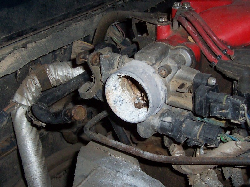

Looks like you've got the original factory spark plug wires. You didn't see many people springing for the expensive Packard wires when it came time to replace them.

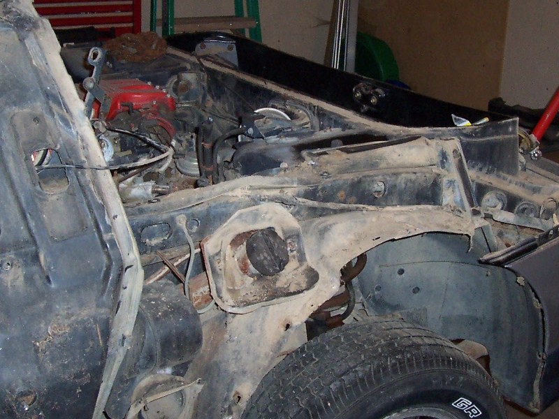

Got a little more work done today, pulled some Interior to remove rear clip, found a rust spot on my floor when I pulled carpet back.
I was wondering about all the rubber strips under the rear clip, do people usually leave these on, or can they be left off on reassembly, will it affect the body lines?

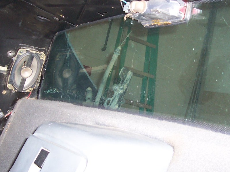

With the rear clip pulled, time to start unhooking everything to drop the cradle. Can I eliminate these wheather strip type parts?

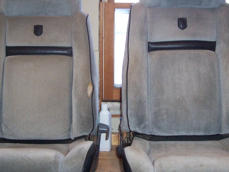

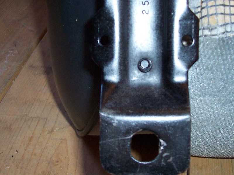

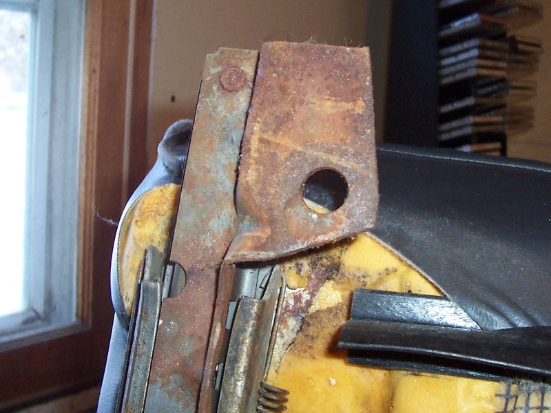

Cleaning my seats while resting my back.
Seat rail before paint
Seat rail after paint, cost $1.99 at Dollar General

Very cool. not sure if you have an air line but this comes in handy when messing with some rusty metal.
Portable sandblaster
Kids play sand is cheap media to use. Works well. After blasting, blow off with air, wipe clean. Tack cloths work well here too. Prime and paint with whatever cheapo stuff you can find. Works well, lasts a long time.
