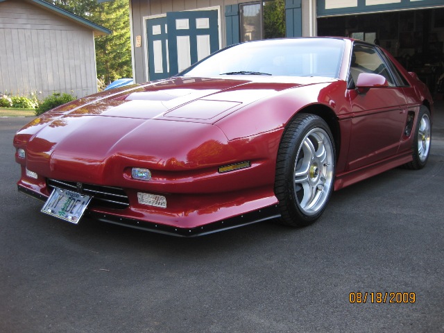

A couple guys, here on the forum, wanted to see some pictures of my 86 Fiero. There are already several pictures on the forum, but here are a few that IIKOOL and Tony Kania asked for.
This is what it looked like soon after installing the small block.
And this is how it looks now- several more pictures to follow-
The car started the dreaded Fiero sickness, since I now have 5, an 84 base, an 85 Gt, and two 88 GT's.
This car was assembled with an Archie kit, and uses the Isuzu 5 spd. It has coil overs on the rear and cut coils on the front, poly bushings, rear sway bar and KYB shocks/struts. The battery is in the front, using a homemade box. The body has been smoothed, with a Warber style hood vent, and Aus side scoops, with cold air intake on drivers side. . There is also an electric fan to draw cool air in to the engine compartment. The rear spoiler is from a 93 Mustang as I recall.The front nose and side skirts are fashioned from foam and covered with fiberglass. The interior has Mr. Mike's leather and double cup holder, with new gray carpets. It has been a fun experience, and I have done all but the final painting myself. I will be pulling the motor to do some upgrades to the trans. mounts and fix a minor oil leak at the timing chain cover seal. It has won several awards at car shows, most people not believing it has a V8.

That is an interesting front bumper. It looks like it literally has a nose! Good work on the Fiero, I really like it, and that is saying a lot because normally I dis-like red.

Yes , I guess it is a little nose like. Maybe more like a beak. For my first effort at a project like that, I was fairly happy. But, if I do another one, the beak will still be there but just barely. There are several changes that need done on the nose as far as I am concerned. That is the problem with these hobby's, the work never ends. Always a new idea.

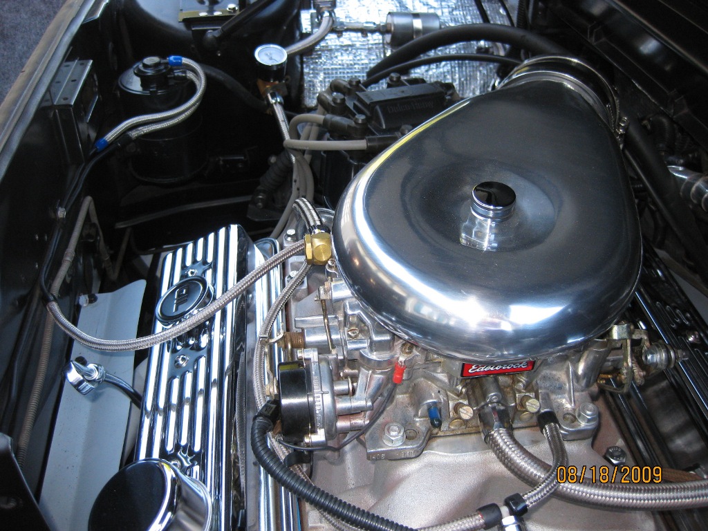

Can you take a close up of your grill emblem and some engine pics?

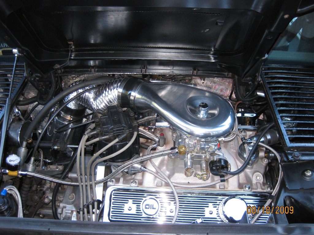

The motor pics are the best I have, and the most recent configuration. The cold air intake pulls air from the right side Aus scoop. It is a pre 86 -350 with cast iron Vortec heads, Edelbrock, intake and 600 cfm carb. It has a hydraulic "hot rod" cam similar to a 350 hp Corvette motor, all because I liked the idle on my 67 Corvette 350/350.

Please self indulge some more.... That engine bay sure looks purty

Here is another pic of the motor. And some pictures of the rest of my Fiero hobby.

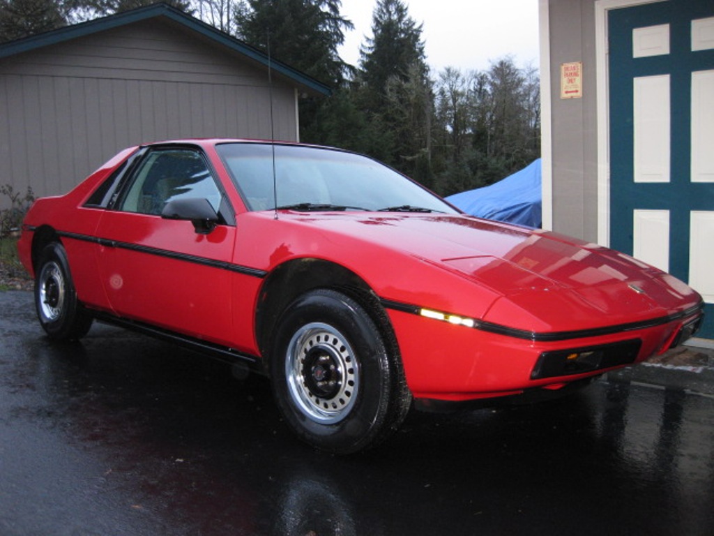

85 Gt- just finished refurbishment.
My 84 base coupe, just finishing up the paint. This was before paint, but the rain makes it look ok.
