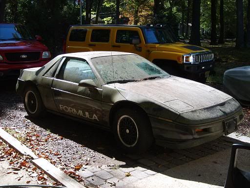

Hehe, well there WAS a fire, but nothing major. OK just a quick review; found a Formula, PW, PL,AC,AT, rust free frame/under body @ 101K
It and had been sitting for at least 8 years in a field under a tree… but for $550 I HAD to get it. Not pretty but I can see the potential.
after a quick wash..but the paint is trash and it doesn't look this good unless it's wet!
So I get it home and after several weeks of a few minutes here and there after work on the weekend (weather permitting) I’ve managed to free the frozen brakes, took the fuel tank out, dumped it, cleaned it, fiddled with the pump and fuel level sending unit, painted, undercoated and put the tank back, replaced the filter and all lines, replaced the stuck TB, replaced the dirty and corroded distributor with a fresh one I rebuilt, cut and removed the TB water pipes and capped off (twisted a pipe with a frozen end swapping out the TB so it had to go for now) replaced the rusty air filter box and a few other things and FINALLY,,, tonight; new battery, new gas, new oil & filter, pre lubed the motor and fired it up and !!! nothing. Timing way off. Pull dist, 1 turn on the rotor, replace, chug chug chug, varoom! And wholly crap it ran …and it sounded good! I was very excited….for about 10 seconds….then it started pouring smoke and squealing something awful, I had my helper (wife) shut it down but POOF, the damn insulation next to the ALT caught fire!!! The alt is frozen and the belt just spun on it and got very hot very quick and caught the insulation touching it on fire! Now this was running for 8-10 seconds maybe, and it was enough to start a fire, a very small one but still…fire. I was able to put it out, NO damage done and called it quits for tonight. More fun to follow tomorrow!
SO, all those rumors and stories are true, these things ARE fire hazards!

I don't recall ever seeing a gigantic formula door decal like that, my f-decal is only half that size!
actually the decal is standard, it's the car, it's smaller than normal Ya it was repainted at some point (horrible job) and they put those on....i kinda like them. no?
