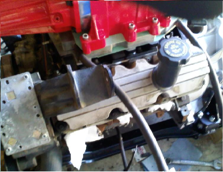

Here is how WCF did mine:
Regards,
David
