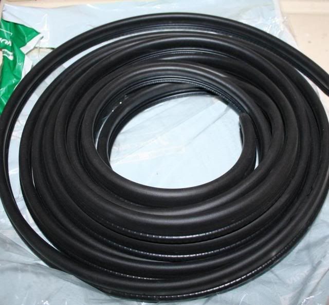

I just received my shipment from J.C. Whitney for a roll of weatherstrip that I wanted to try on my trunk. It comes in a 25ft roll so there is actually enough to do another trunk if I needed. This has been done by a few members in the past so I thought I would show how the finished fit looks. You do have to push a little harder to shut the decklid so I know it is making a good seal. Not bad for $37.99 compared to a couple hundred for an exact replacement
[This message has been edited by IMSA GT (edited 03-13-2009).]

Looks awesome !
Can somebody throw out that part number ?

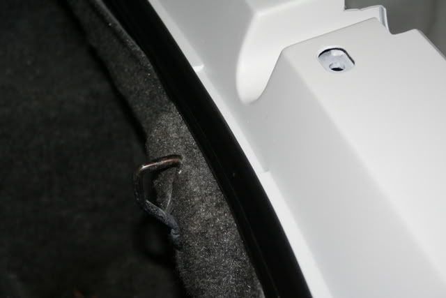

Sorry about that. One other concern that I had was that the decklid has a square shape around the turns where the weatherstrip curves in the turns. Fortunately, the weatherstrip is angled outwards so it sits right on the outside edge of where the original weatherstrip sat and clears the square edges of the decklid. One other thing, the rubber seal is said to be 5/8'' tall. It is actually 3/4" tall which is a little taller than the specs which is great.

Did you wet test it? It certainly looks water proof.

Honestly....no. I am still finishing my paint job right now but I really don't know how to test this without actually driving in rain. A garden hose will just flood the decklid and the water will run off where a rain storm "pushes" water into areas of the car. With my original trunk weatherstrip, there was no effort to close the decklid. Now, I have to shut it pretty hard to get it to close so I know it is making a good seal.

...You do have to push a little harder to shut the decklid so I know it is making a good seal.
That's better than the alternative and I bet over time it becomes the perfect fit. Thanks for sharing the info.
