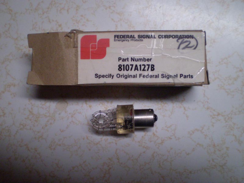

Report this Post02-11-2010 07:20 AM Click Here to See the Profile for johnyrottinSend a Private Message to johnyrottinDirect Link to This Post

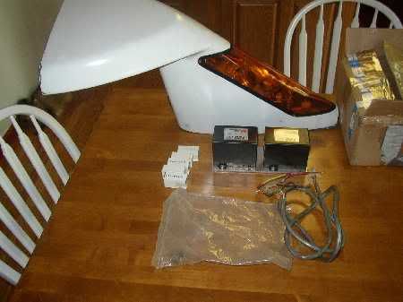

There is one on ebay now that is hollow. Also, I will post the part numbers that are available from the company that built the original ones. Those parts are no longer available but new ones are that will accomplish the samek goal. The lens appears to be just a bent piece of Lexan (not 100% sure on that).

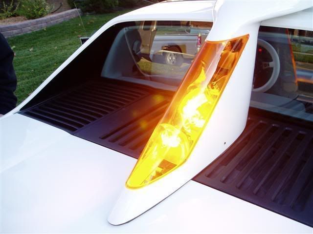

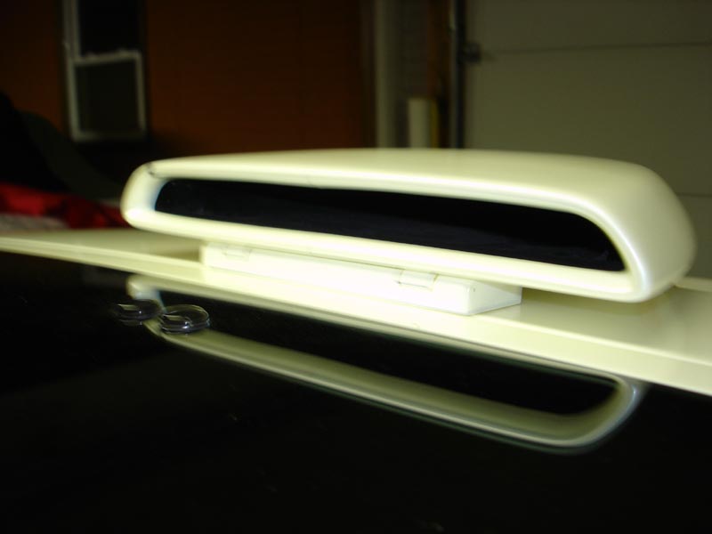

I'm in the middle of making my Indy Scoop look just like this for my Pace Car. I had help from FieroSTS he made me a wood mold so I could shape the lens the correct way. So far I have 2 prototype lens made. I'll get some pictures of what I'm doing tonight!

Also i beleive the fierowarehouse scoops are solid...which would be easier to work with. Also lexan isn't that bad to work with. just try and get some cheap scraps etc and experiment with bending it. Could probably use a pipe as a mold. I'd love to help you but i'm building a tank car...well..the prototype and then its into assembly...still have to get my fiero's headlights to go up and down...have to install 2 12'' comp subs...two 4x10 in the dash...two 6'' speakers in the door sills ( maybe ) and 4x6s in the sails...or maybe i can squeeze the 6''s in there...well...diff topic...anyway...oh and i have to restore my 79 trans am....and find a job to save money for college / engine swap...-thinks about making a begging website-
The Fierowarhouse scoop is NOT solid. That's the one I'm using for my Indy.

johnyrottin
Posts: 5513
From: Northwest Florida
Registered: Oct 2007
Total ratings: 85
Report this Post02-11-2010 07:12 PM Click Here to See the Profile for johnyrottinSend a Private Message to johnyrottinDirect Link to This Post
Yes, that is how I found the components. I was wrong about having the info at home...have to wait till tomorrow at work...sigh. And does that Pace Car really have a blue dot matrix stripe?
I'd be really interested in hearing about your progress! Please keep me informed!

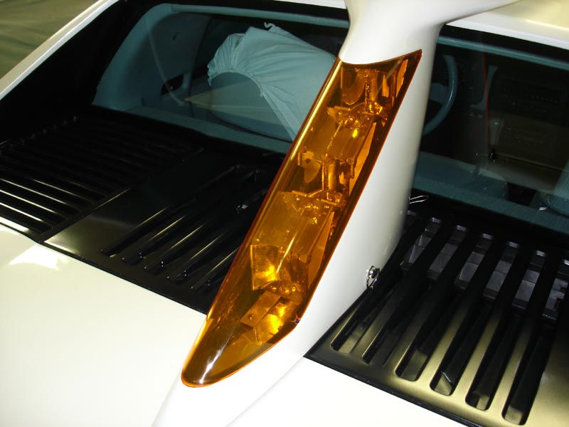

“Federal Signal” did make the Strobe light for the Indy but the lens was never from a 747 aircraft at all. It's like saying "Lotus" made the 88 Suspension..

The shape of the scoop happens to resemble a "wing" on a plane. So if you take that and add in that Federal Signal made the first ones used on the 3 "Real" Indy Pace cars. Then I can see where it would lead people to believe that it's from a 747 aircraft. So again the lens was never from a aircraft. I have talked to a couple people that have very good info on the Indy program back then and it was just a Myth..

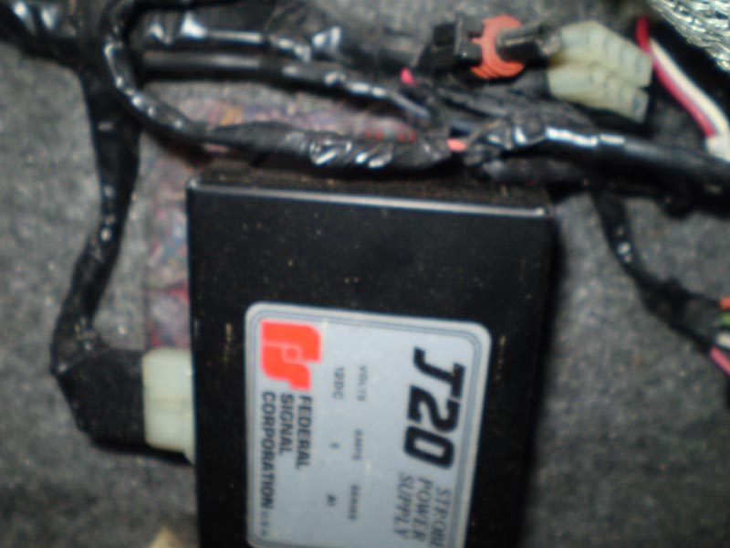

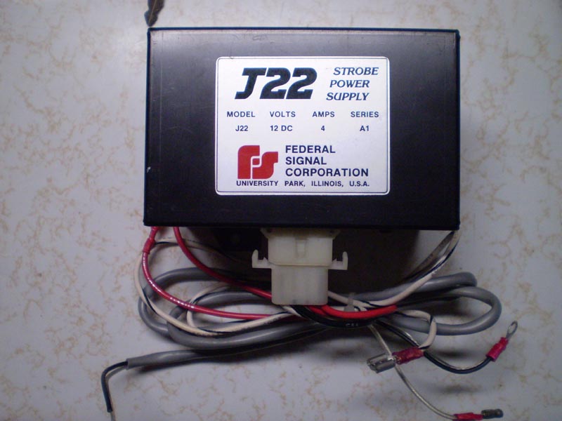

Here is the email trail. There may be some heat issues to deal with.
John,
Sorry for the delay, but you can use power supply 416109 in place of the original one that is obsolete, The parts needed would be:
(1) 416109 power supply -$156.00
(3) Z8583052A strobe tubes - $37.50 each
(3) Z8583001B-04 reflectors - $5.50 each
(3) 413210 10' cables- $17.00 each
My concern with using these parts is that they burn much hotter than those original bulbs do. They would probably need to be sunk deeper into that housing to keep them at least 1.5" away from the lens.
Thanks,
Nick
Nicholas Nakatsuka
Service Applications Technician
Federal Signal Mobile Systems
Phone: 800-433-9132 Ext. 5325
Fax: 800-343-9706
Email: nnakatsuka@federalsignal.com
