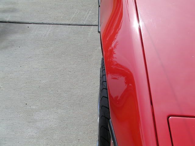

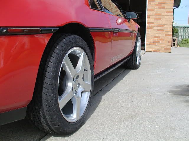

I went with 17x7 rims, with a 45mm offset on the front. This made the outer edge stick 0.184 inches beyond the stock rims outside the sender, and left 0.396 deeper in the fender. I had no issues, and it looked ok and not like it was sticking way outside the rim.
In your situation, I am sure you can get a 7.5 inch rim to fit in general. The question is what will the offset be, and how much will stick beyond the rim. If it has a really high offset to minimize the amount outside the fender, inside clearance may or may not be an issue. With 2 inches more diameter, you do buy yourself more room too (as the rim will fit deeper over the a-arms with the larger diameter).

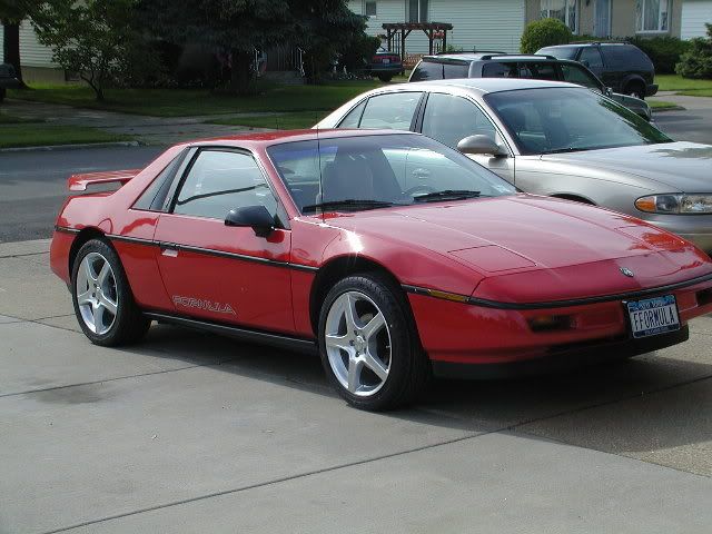

I thought I would add a couple pics to illustrate how the rims I chose worked (I have since gone back to new, stock rims to get the factory look. Why is a long story). Rear rims where 17X7, 35mm, which is stock width and offset.
Current look:
