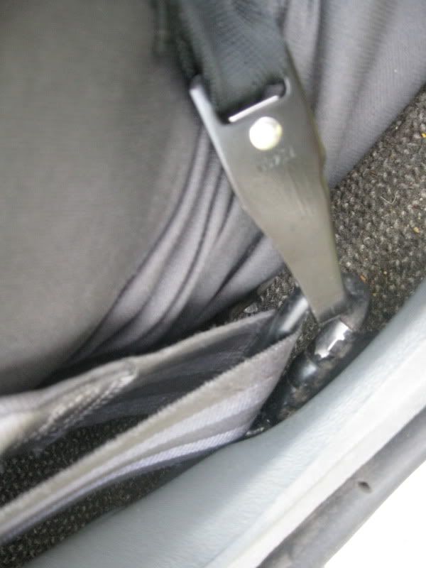

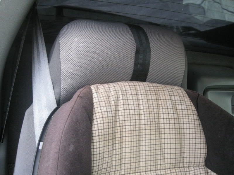

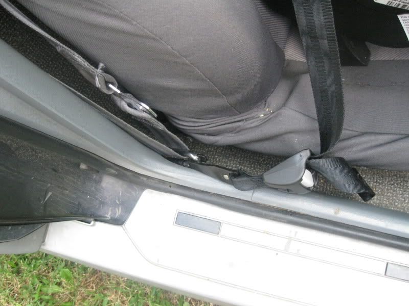

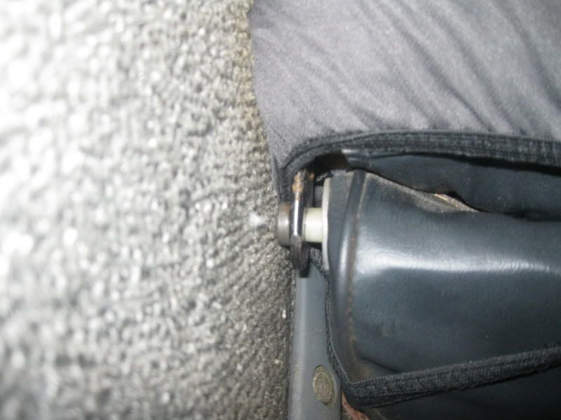

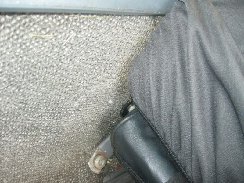

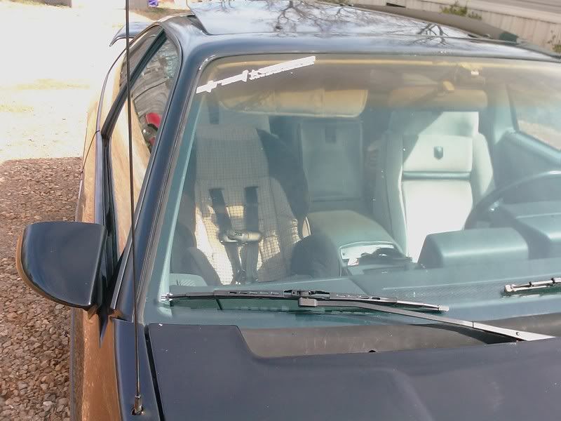

ok i finally got around to taking pictures. here you go:
here is the frame location were i attach the 1st anchor hook. this is the most difficult step, you got to push it in between seat and console and kind of wiggle it untill it hooks. keep tention on the strap or it may come unhooked
next i attach the other anchor to the seat belt loop. make sure that the adjustment is on this side.
put your knee in the seat and tighten the straps as much as possible.
at this point, it's a good idea to put the fiero seat belt through the car seat.
put the top anchor over the top of the seat and pull it to the seat belt loop
attach the anchor to the loop and pull tight
check everything and make its all tight. if you can, try to slide the seat forward a notch or 2. then have your baby's mama come approve
In georgia, if you are unsure how to install a car seat, you can take your car and seat to a local fire station and have a fire fighter educate you on how to properly install it. they have deen trained to do so and offer this service for free. i took my car seat installed in the car by a fire station a friend works at, showed them and explained how i did it and they said it was perfect.
