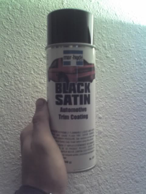

Report this Post01-07-2009 05:42 PM Click Here to See the Profile for HCClick Here to visit HC's HomePageSend a Private Message to HCDirect Link to This Post
This works awesome.

Originally posted by HC:
This works awesome.
is that a fiero on there?
85GT3.4Track4spdCar
Posts: 485
Registered: Dec 2008
Report this Post01-07-2009 10:22 PM Click Here to See the Profile for 85GT3.4Track4spdCarSend a Private Message to 85GT3.4Track4spdCarDirect Link to This Post
Yep! That's a Fiero on the Mar-hyde can.
That's what you use on the mirrors, belt trim and grills and stuff. Perfect but expensive @ 6-7 dollars a can.
Get it at the automotive paint store.

Report this Post01-07-2009 11:05 PM Click Here to See the Profile for maryjaneSend a Private Message to maryjaneDirect Link to This Post
Yep--that's the one--if you want an oem look. Satin
