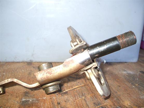

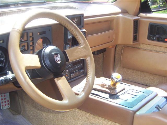

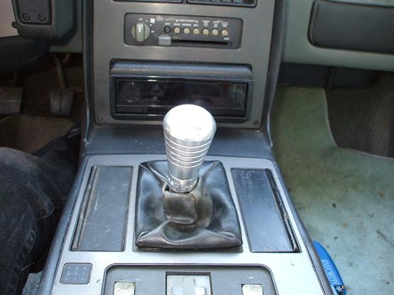

Made a stubby shifter and took some pictures to share

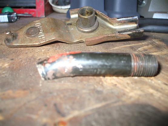

The victim
This is out of an 86 SE

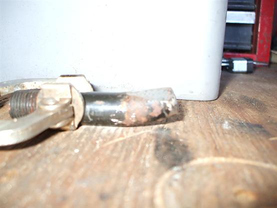

Start by grinding the welds off of the shifter

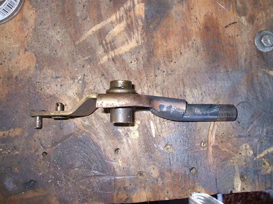

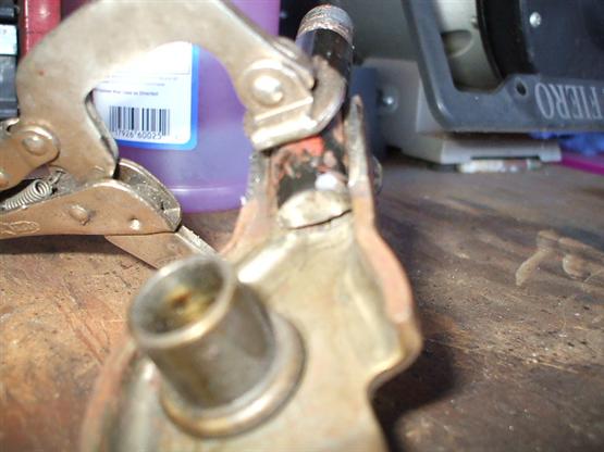

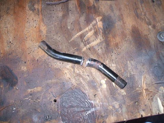

Then cut the shaft about here
I left some of the bend on it to give it more to weld on.

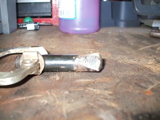

Then you have to grind the end flat so it will sit flat to weld

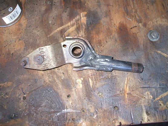

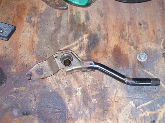

Here it is put together to test the fit

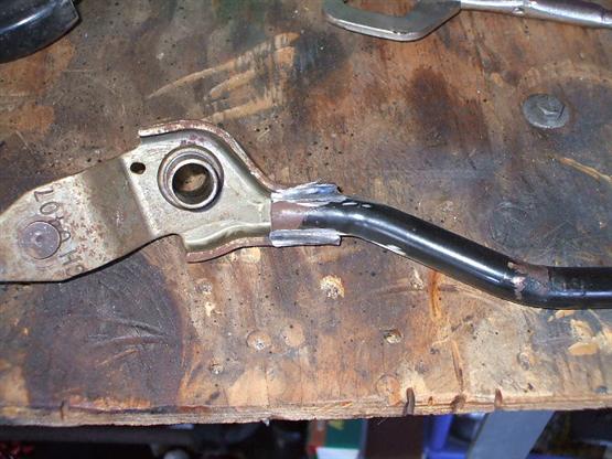

Then just weld and paint
Installed
Now you know

by shortening it that much, How Hard is it to shift now that the mechanical advantage is gone ?? been wanting a shorter shifter but was worried about how hard it would be to shift. Thanks
Posts: 33074
Total ratings: 398
Report this Post07-12-2008 07:46 PM Click Here to See the Profile for Jake_DragonSend a Private Message to Jake_DragonDirect Link to This Post
Its not bad because I have a tall knob, I have another one cut down thats about an inch longer and it is easier to shift but not by much.
My select cable is tight so its tight left to right but not bad. I think a good sized knob over comes how short it is.
