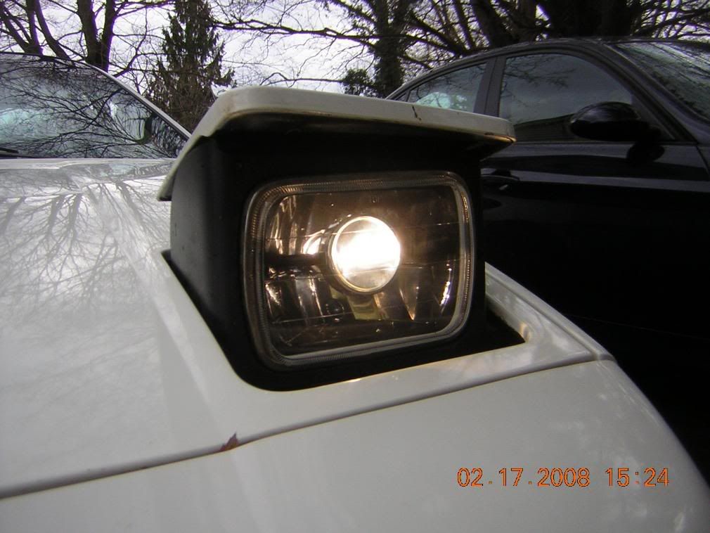

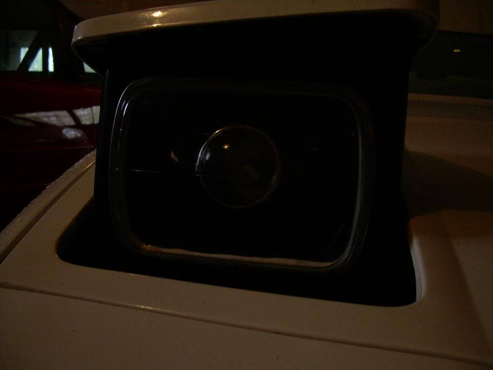

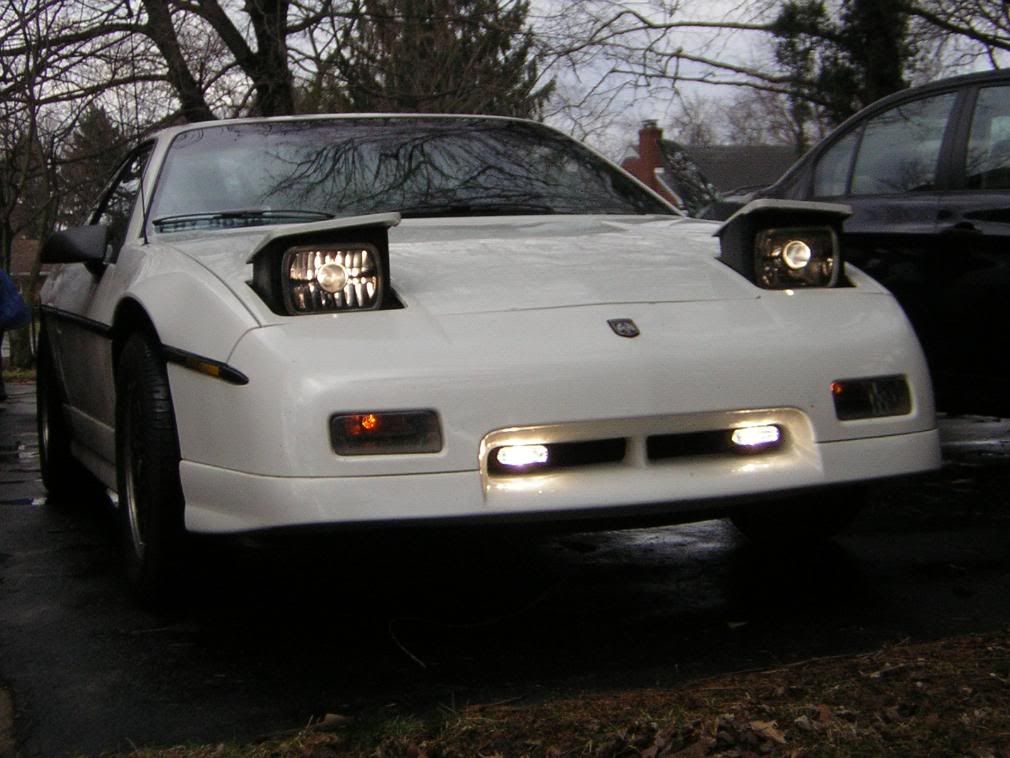

I just installed these bad boys
The ultimate would be Fiero1Fans housings but if you haven't guessed, these cost alot less than $500. Maybe one day I will buy them.

Ebay, the fit is okay, when I have time I am going to have to cut the headlight buckets, they don't fit THAT well.

Got a link? How do they compare in lighting to stock ones? From the picture it looks not as bright.

its the bulbs that suck (cheap-o's supplied with the kit), I am going to upgrade to silverstars eventually. I don't have a link I bought them from b_squared, I searched H6054 projector.
