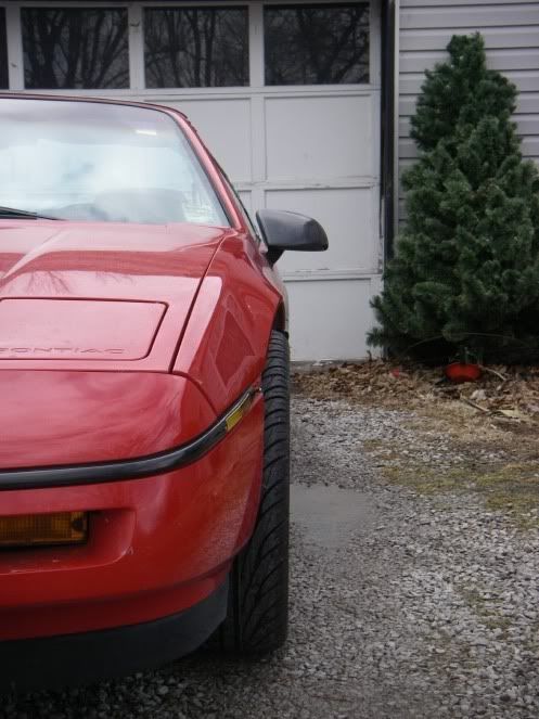

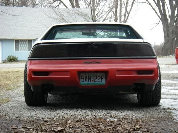

Well i got my tires mounted and balanced on my wheels today, we have a road force balancer, and they came up with excessive road force but either way 265/35/18's fit, from what I can tell just fine. The offset is 35 and it is a 9in rim, the only problem I have is they stick out about 3/4 of an inch on ea side, but I plan on fixing that with a very minute widebody, if things go as planned.
And what I think people would want to see.... the pictures...

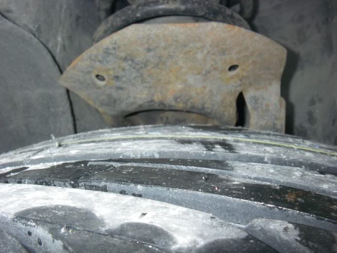

And from what I can tell the only thing that would cause a possible issue with rubbing is the spring perch and you can see here that there is quite a gap between the wheel and perch.
Hope this helps anybody looking for wheels, Chris

Don't hit a bump :P
Looks like it could use some flares on the back.

Looks like a DUNK. (old cars with HUGE wheels)

Originally posted by eph_kay:
Let me know if I am wrong, but from what I understand the tire and spring perch move together when you hit a bump, so shouldn't the distance between the wheel and the perch never change? coil overs will help to lower the car, but I don't think they are needed to keep from anything rubbing.
First part is correct, the wheel and perch move together.
Second part is not as correct. What we can't see in your picture is the horizontal distance between the wheel and the perch. If you have room then fine it won't change, but it could be rubbing. An adjustable coilover doesn't have that large perch and will give more clearance to keep from rubbing. Also, an adjustable coilover will give you the freedom to raise the car or adjust stiffness to keep from rubbing on the fenders.
Adjustable coilovers, are not just for lowering the car. Notice I keep saying "Adjustable" since all McPherson struts technically are coil over shock. When people say coilovers, what they are really saying is Adjustable Coilovers.

jscott, I have about 1" I would say, in other words I can freely move my finger around between the tire and the strut body/spring perch, I would say it is about an inch, I just went and checked, which should be about the same with coil over's since it is gonna be the same sturt body.
And what I was saying with the "help to lower the car..." was that, the comment about "COIL OVERS!" I don't think they are needed for this tire, but they would help to lower the car to look better, that is what I meant by saying that.

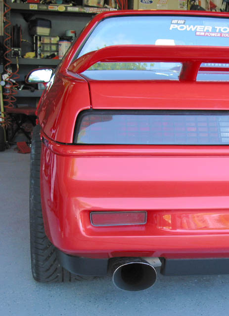

Geezs, the 88s strange cause a prior yrs don't stick out that far. I guess this the same issue #025 is having.
This is what it looks like on Chet's Fiero
(18x8 front with 38 offset on 225/40/18) and (18x9 back with a 35 offset on 255/35/18 Falkens 452)

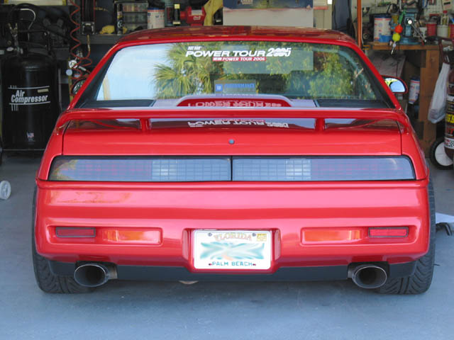

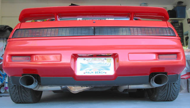

No need for crazy offsets for the rear of an 88 with 255's.
This is my 88 with 255 45 17's and a 35mm offset, BTW the front is 215 45 17 with 40mm offset

Huh, that fits really well on your car, what size rim is it on?
What's the width of the rim? That and the offset is what matters...
I think , even thought the rear offsets are the same at 35mm, Eph's stick out more because of the 9" width. If you could get th 9" in a 50mm that would be near perfect. This would put the wheel about 3/4" closer to the strut.

Ha Ha, good point how did I forget that.
The front is 7"wide and the rear is 8"
I would not use ANY rim tire combo that puts the tire under .5" to the strut. Why, ask GM about the new GTO's with 17" rims on front that had less than .5 clearance. They have MANY tire blowouts on record and who knows how many went unreported. The tire WILL flex even at the top and get closer to the strut as you drive. If the tire touches it cuts the sidewall and BAM.
Just because it will fit in without touching does not mean it will drive without touching. Under hard driving that tire will flex and the rim will too. You get what you pay for just imagine the the cheap rims flexing on hard corners. How much, I don't know but I am sure it is not a lot. If you tire is to close to the strut to begin with you cant afford ANY tire/wheel flex.

Dont forget about the tiny wheel bearing flexing, or the "helth" ware of the entire system.
http://ls2gto.com/forums/sh...&highlight=strut+rub
GM made all the 17" GTO's basicaly the same. Some rubbed and some did not.

If it's just the spring/seat that's creating the clearance problem then switching to a coilover setup should take care of it. I think I saw some Tenzo 18x9.0x5x100x49mm wheels at Discounttire.
Even my Porsche rims (they're STIFF) flexed ~1/16" under LIGHT cornering, to contact the strut (they are 8.5" wide with 55mm offset and are VERY close to the top of the knuckle where the strut mounts). I imagine they flex 1/8" or more at max load. That's just the rim.. the tire is going to move a lot more!
