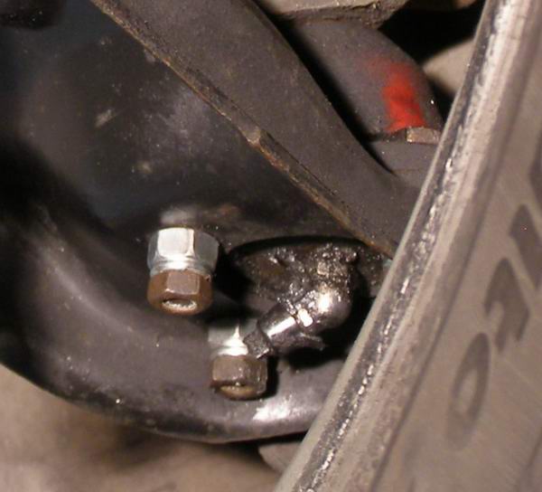

Not trying to scare anyone, but I wanted to let you know of a potentialy dangerious situation. If you already know about this please ignore.
I was driving home from work this morning when I noticed the car was unstable in one of the high speed turns. I thought it was wind blowing the car side to side. The motion seemed too uniform (back and forth) and got so bad that the car took up 1 1/2 lanes of the road in the turn. Needless to say I thought I had broken something in the suspension.
I put the car on the lift and pushed and pulled on the wheels to check for loose components. Guess what. The PS rear ball joint (replaced 20,000 miles ago) had come loose AT THE BOLTS. My wheel was moving nearly 1/2" at the tire tread. I remeber paying special attention to the torque when I installed them and was concerned because the originals had expanding rivets.
So the WARNING is this:
If you have this type of rear ball joint, check the bolts. Jacking the rear wheels off the ground and tring to move them inboard and outboard fromt the car center is a good way to check. It may be a good idea to use anti-vibration nuts or double nut it. If you remove the nuts, verify the alignment.
(in my best radio voice).... This has been a public service anouncement.

I can see why they came loose. It does not appear to me that your original nuts are a locking type of nut. I would not simply trust a lock washer to hold this item together. Use some red loctite and locking nuts. The nylon lock nuts are probably ok, but I would have bought some all steel ones.

Report this Post12-28-2006 08:09 PM Click Here to See the Profile for R RunnerSend a Private Message to R RunnerDirect Link to This Post
The original ones did have lock washers. I followed the manufacturers directions to the "T". The DS was fine. The lock washers were holding. The picture above shows the "after" situation. The silver nuts shown are steel, but they also have a nylon locking ring for vibration. The black nut was the original nut that I added to help lock the silver nut on that much better. I am still considering a tack weld. I would feel better if the ball joint didn't have so much slop in the A-arm hole. Welding would fix that.

Originally posted by R Runner:
This picture shows the cause of your balljoint comming loose.
It is installed incorrectly. All the strain and forces are being transmitted through the 3 bolts, instead of from the balljoint directly to the control arm.
The rear balljoint is installed from the bottom of the control arm, and the support plate is installed on the top.
You will have to remove the balljoint and reinstall it the proper way, better check the other side too. Once that is done you shouldn't have any problems with it comming loose because the forces will be transmitted through the 2 parts properly.

blackie2m6,
I think your observation is correct. I do remember when I did mine this past winter. I had to grind the hole in the LCA so the balljoint crown would fit into the hole putting flange on the bottom side of the LCA. Is this correct?

Yeah, your balljoint is installed wrong. The crown portion (with the metal rod that goes into the base of the knuckle) of the balljoint goes through the larger hole in the control arm. Basically, install the balljoint through the bottom of the control arm as opposed to it sitting on top of the control arm.
That could be a huge safety issue if it's not installed through that hole do to the pressure on the balljoint. So fix how you have the balljoint installed, add the lock washers, and add some threadlocker and you'll be good to go.

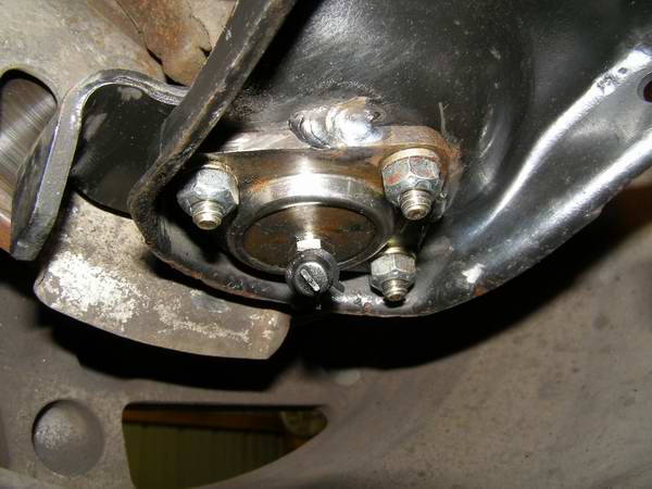

Thanks everyone for the help. I feel really stupid. My other GT was the same way and I thought I had in stalled them correctly.
I tack welded them into place today and did a full re-alignment. But now I feel stupid for doing 8 hours worth of work that I will have to tear apart and redo.

Report this Post01-01-2007 07:57 AM Click Here to See the Profile for ohio86seClick Here to visit ohio86se's HomePageSend a Private Message to ohio86seDirect Link to This Post
Did you get the BJ switched around?

Report this Post01-01-2007 09:30 AM Click Here to See the Profile for R RunnerSend a Private Message to R RunnerDirect Link to This Post
Problem solved.
Thanks for the help everyone.

Report this Post01-01-2007 04:51 PM Click Here to See the Profile for ohio86seClick Here to visit ohio86se's HomePageSend a Private Message to ohio86seDirect Link to This Post
that looks better. Did you have to clean up the hole in the LCA first?

Report this Post01-02-2007 07:01 PM Click Here to See the Profile for R RunnerSend a Private Message to R RunnerDirect Link to This Post
No. It had plenty of clearance. I wonder why yours was so tight?

Report this Post01-02-2007 08:18 PM Click Here to See the Profile for ohio86seClick Here to visit ohio86se's HomePageSend a Private Message to ohio86seDirect Link to This Post
Im not sure why mine so tight. I remember that it seemed like the outside of the ball joint casing was too big. I only had to grind a very small mount to get it to fit though.
