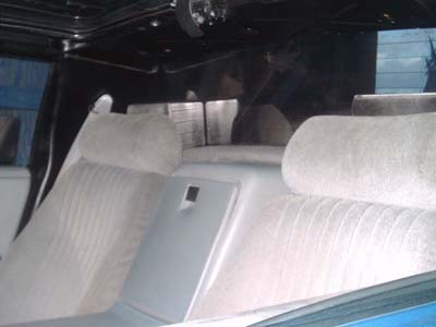

riley
Posts: 965
From: Saskatoon, SK, Canada
Registered: Feb 2004
Report this Post10-29-2006 03:13 PM Click Here to See the Profile for rileySend a Private Message to rileyDirect Link to This Post
Originally posted by Indyellowgt:
I've used Grand Prix GTP gray leather..A little tight fit..
I have a pic somewhere.They are for sale too..$100
i would like to see pics of these. just to see how tight of a fit it is.

Originally posted by wiccantoy:
94 caddy black leather seats .
Is that a bench seat??
lol no they had bucket seats also in thise caddys

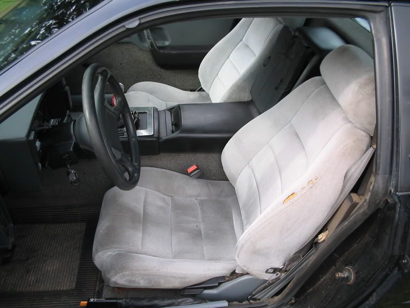

befarrer
Posts: 1962
From: Westlock, Alberta, CANADA
Total ratings: 61
Report this Post10-31-2006 11:04 PM Click Here to See the Profile for befarrerSend a Private Message to befarrerDirect Link to This Post
Here is a pic, I am 99% Sure they are from a Grand Prix, may be a chance they were from a Grand Am, I think it was around a 91 or so. The seats werent ripped at all when I bought them, need to get them repaired. I had them in the car for 2 years now, I got them 3 years ago. They were alittle tight, I had to push them in to get the rails on the studs, but I have no problems adjusting the seats, may be alittle stiffer than before, but I only adjust the seats once.

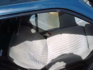

These were the seats in the '88 GP I had. I don't think they fit:
This images is larger than 100K. Click to view.
