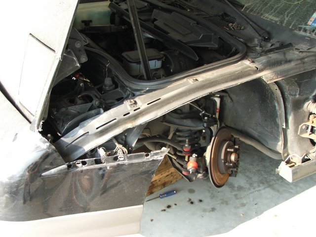

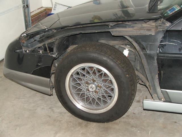

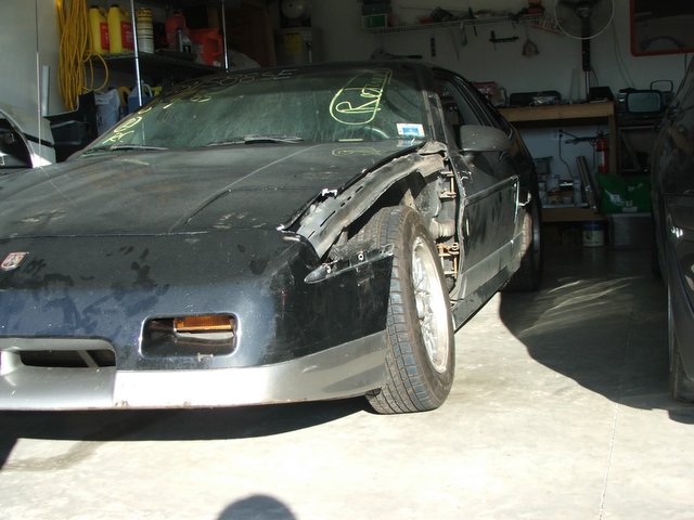

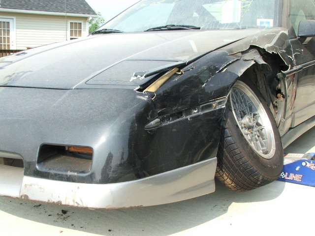

As some may know, I was hit by a 73 year old woman driving a Ford Escort as I was going to work. She failed to yeild to me as I was going straight through the intersection and she was turning. Here is the car after it was brought home.
The damage included hood, fender, and door. Under the skin, there was damage to the headlight area, above the fender, the front of the door, and most visibly, the upper control arm. Here is a photo of the damage after removing the fender (what was left of it), and the wheel.
MRJ brought me a upper control arm, so I replaced it hoping it would pull the wheel back into alignment. I had to cut out the old upper control arm bolt because it was bent severely. I got one free from Pull-a-part because I was there getting something else. Here is the upper control arm after replacement.

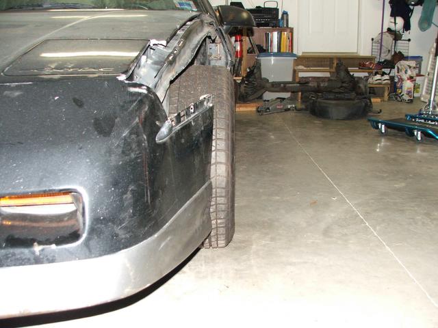

Well, that didn't work. This is how the car sat after the new control arm. Keep in mind that the wheel had about twice the negative angle before replacing the bent control arm.

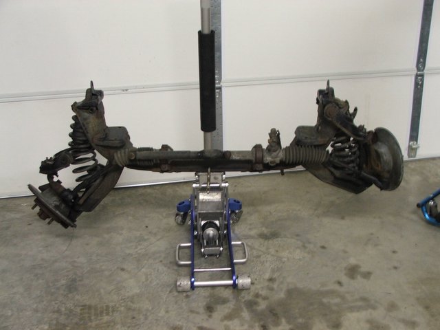

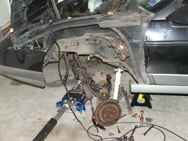

My next idea was to just pull the whole front assembly from a parts car and swap it out. After Exodus5 and I spent about an hour removing the unit from an 86 SE, here it is after a little pressure washing.
The next step was to remove my damaged suspension all in one piece like the junkyard unit. Here it is on the way out.
I found that removing the inner plastic tub in the front makes everything a lot easier. It provides more light and there some things like the heater hoses and steering rack which are much easier to remove from the top.
My goal is to have the replacement susupension in this weekend and the car back down on the ground. Hopefully, the alignment will be close enough to drive the car for a frame estimate. I'll try to keep this thread running with pictures and updates. Your comments and suggestions are appreciated as always. I really hope I can save this car. Wish me luck!

ouch - she really womped on your wheel there

Well, I have some good news. After pulling the damaged suspension out of the car, I was able to take some measurements and really get a better look at the whole assembly. Both crossmembers measure nearly identical between the spring perches. When I replaced the upper control arm, I never thought to look at the spindle since it is cast and figured if it had been damaged, it would have broken. Not the case, fortunately. The upper spindle where the upper ball joint mounts should be parallel or in the same plane as the lower ball joint mount. My upper ball joint is more towards the center of the car instead of straight down towards the lower ball joint. This would explain the extra negative camber. I'll post a picture of the spindle tonight if I make time.
Since the original suspension has been worked over with cut springs, new ball joints, tie rods, and poly, I'm going to change out the spindle and go from there. Its too bad that I spent the time and money on the new suspension assembly, but it helps to have two parts next to each other for comparison to see what is different.

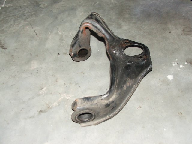

Quick update here. Last night I was able to swap out the old spindle for a new one. Much, much better. Here is a picture of the old spindle. If you notice the upper part of the spindle on the left is quite bent. As far as I know, the two machined parts which face the upper ball joint, and ball joint nut are supposed to be parallel with the lower balljoint mouting surface.
I haven't gotten everything connected back up, hopefully I can work on it more this week. I can't lower the car back down quite yet, but I can already see that it is much better than before. Once I torque all the bolts properly, reconnect the brake calipers, and put the wheels back on, I'll be ready for a trip to the alignment shop.

So I was working on the car last night and got it all tightened up. What a difference a new spindle made. I now have positive camber instead of the extreme negative I had before.
Now I have to find a tow dolly and a frame shop so I can get that front corner pulled back out. Total cost of parts used to fix the car to this point: $0. A big thanks to Matt Jackson for the upper control arm and spindle.
