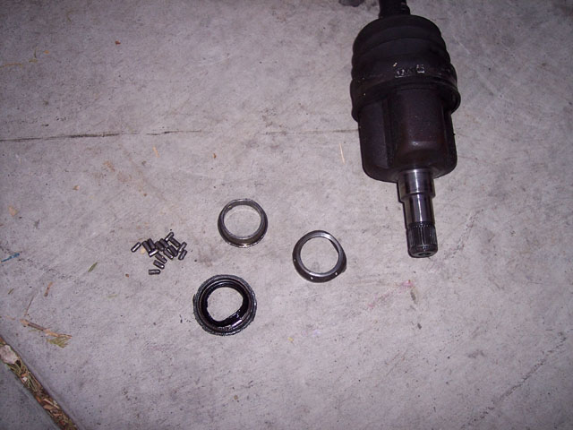

I got it apart and this is what fell out, a bunch of bearings like the after market axle bearing to help your trans last longer , or is thier a stock bearing that goes behind the seal, '
thier is a smaller,thiner bearing farthier in that seems to be ok,
what do you guys think ?
what is it and what do i need?

Can you provide any close-up photos of the pieces which came out (other than the axle), and possibly a shot looking "in" to the hole in the transmission where the axle is inserted?

will do, I will try to take pictures of the inside of the hole,
I was able to zoom in on the parts with photoshop
those small thing on the left use to be bearing, and the part on the top is part of what is left of that bearing assembly. bottom part is the seal and the part on the left I dont know, it was floting on the out side of the seal agenst the axle, was that attached to the axle? or was it also part of the Bearing that exploded, and just pushed it's way out thought the damaged seal, as you can see it is all bent up

I could be wrong, but it looks a hell of a lot like you had both the OEM axle seal in there, and an aftermarket axle support bearing. Would definitely like to see a shot of the side of the transaxle, and a look "in" to the hole where the axle would be inserted.
