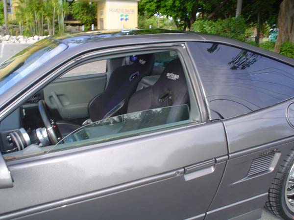

Report this Post04-04-2005 02:04 PM Click Here to See the Profile for Black-Azz-GTSend a Private Message to Black-Azz-GTDirect Link to This Post
I too am using racing sets.
I think they are a nice touch to the interior.
how wide are yours from shoulder to shoulder?

Report this Post05-02-2005 09:32 AM Click Here to See the Profile for KohburnSend a Private Message to KohburnDirect Link to This Post
they came out great - really comfortable.. I had to drill out a couple rivets to remove the integra seats rails - make some little 4"x16"x1/8" adaptor plates to mount the fiero seat rails and then bolted it all together - they don't like to slide very much but thats probably just me misaligning the rails a tad.. and how often do you move the seats in a fiero anyways?
the ONLY downfall is losing about an inch or so of headroom - but I also gained about 2+ inches of under seat space that i'm thinking about how to utilize - maybe some under seat speakers or some bass shakers on the seat itself
it should be available for people to see in person at carlisle in 3 weeks

Report this Post05-02-2005 11:03 AM Click Here to See the Profile for RCRSend a Private Message to RCRDirect Link to This Post
Nice job...Do you have any clearer pics? Not sure I like the idea of losing headroom and the higher seating position. There's always a trade off...
Bob
Kohburn
Posts: 7349
From: Oriental, NC
Total ratings: 188
Report this Post05-02-2005 11:23 AM Click Here to See the Profile for KohburnSend a Private Message to KohburnDirect Link to This Post
well i'm 6'4" and i fit
the only way i can make clearer pics id by brightening the picture and reducing contrast which will grey out the pics - but then you could see the seats
:edit - i updated some of the pics after tweaking
[This message has been edited by Kohburn (edited 05-02-2005).]

This is how the seats I got off ebay fit.
This images is larger than 100K. Click to view.

Report this Post05-02-2005 03:00 PM Click Here to See the Profile for RCRSend a Private Message to RCRDirect Link to This Post
Koburn...It does look good. I was more concerned about raised driving position due to my dash swap. I'm not sure how close to the steering wheel that would put my legs.
Paul...Your seats look good too. Which ones did you get? How is the quality?

Report this Post05-02-2005 06:56 PM Click Here to See the Profile for paulcalSend a Private Message to paulcalDirect Link to This Post
Bob
http://cgi.ebay.com/ebaymotors/ws/eBayISAPI.dll?ViewItem&category=33701&item=7971557980&rd=1
These are the ones I installed.
I combined them with a 3 point racing harness and you don't get into this car anymore, you strap it on! They are not the most comfotable seats by a long shot and I'll find out next weekend when I go on the Poker run in Orlando how they feel on a long ride. I just finished installing them yesterday so I haven't had a lot of time with them but my 1st impressions of them are positive. I'm 6' 175lbs and you do not move around in these seats at all in the corners. So far they give me a much better feel on how the car is handling. I didn't expect that but it's a nice feeling, I feel much more in control of the car in a high speed turn. (45mph turn doing 80mph)
