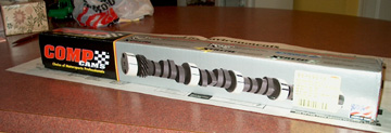

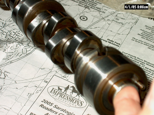

Well I finally got my regrind back from Comp and now its time to start the rebuild and the swap.The thing is if I had gotten this back a week earlier I could have had a lot more time to work on it.My wife just had our second son so it gonna take a lot longer than I had hoped.Here are some pics of the cam
This is from a 3100 V6.
Original spec
.............Int...........exh
............196.........196.......lift .43
new.......210........218.......lift .465
Anyone interested this only cost me 125 buck to have done and they had the cam for about two weeks.
