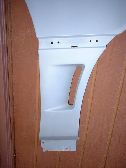

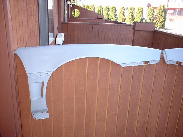

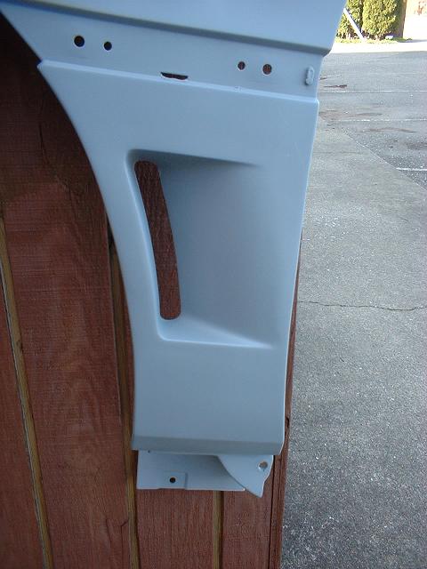

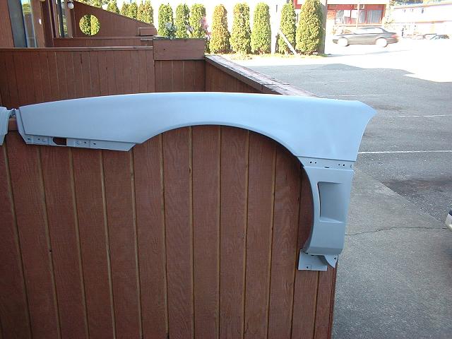

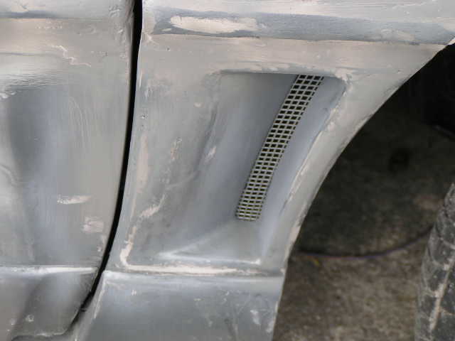

no pictures of the process, my camera wasnt available.
but, yeh, 87 trans am vents molded into the fender.

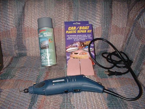

i picked up an extra set of fenders from pick a part for 70 bucks and the vents for 40.
as for materials, i purched a dremel for the task, went through about 8 cutting wheels.
used a plastic repair kit so it would give me some flex and not crack.
the primer was a filler primer, thicker then normal primer and helped fill any wee nicks.
after the holes were cut and the vents were bonded i started with 250 grit to get the shape then finished with 400.
primed the area.. found imperfections sanded down to base and refilled, sanded, primed again. sanded. primed again.. sanded.. fnished with 800.. now awaiting paint. any ideas how much that will set me back from a shop?
while i was at it i shaved the antenna hole.
anyhoo, enjoy the pics

MiZer..did you mold them in from the rear of the fender?

fiero67, i molded them in flush with the fender, cut the hole and trimmed the vent to fit flush, in my mind it would provide a smoother transision for the vent.
L44_87GT, none. just like the origional vents on the trans am, looks only. but with a bit of creative ducting, im sure i could use them to vent preasure from the rad, or wheelwell, or cool the breaks.

Too bad you didnt get any pics in progress. I did mine from the back , skitime did his from the front....and you did yours a different way. cool. "+" for you. John

this is the closest to an in progress pic i have, taken with my webcam..

This is during the molding in process on the car also shaving the moldings for that smooth look
