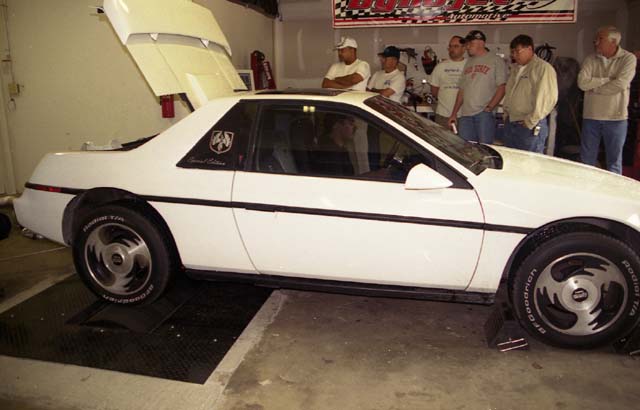

Report this Post05-20-2004 04:37 AM Click Here to See the Profile for f-stopSend a Private Message to f-stopDirect Link to This Post
Here's a shot of Gary's car on the dyno.
Bill

flyntus
Posts: 259
From: Winston Salem, NC
Report this Post05-20-2004 09:38 AM Click Here to See the Profile for flyntusSend a Private Message to flyntusDirect Link to This Post
Bill
Thanks for the photo of my car.
