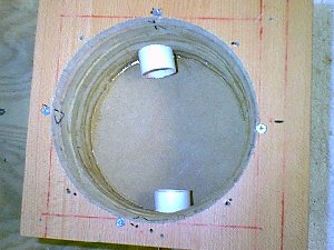

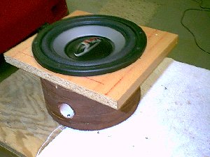

I put this into my car and its sounds great

RWF
How is it built on the inside, the instrucions are kinda veague. Do you have any other pics of it? Thanks.
RWF
Posts: 366
From: Brevard, NC. USA
Report this Post04-26-2004 01:03 AM Click Here to See the Profile for RWFSend a Private Message to RWFDirect Link to This Post
I couldn't find any PVC so I cut some circles out of MDF

RWF
Whoa, thats cool, I never even thought of doing it like that. What are the dimensions of it if you know off hand? Also how tight of a fit was it to get in in there. Thanks a lot.

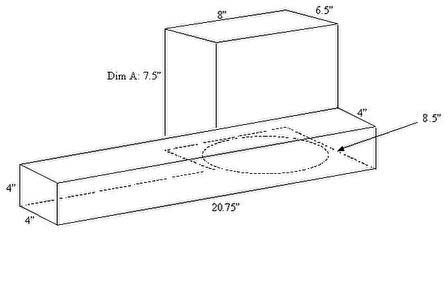

I found this on the Forum a few years back...
I don't remember who posted it first, so i can't give credit to the designer.
